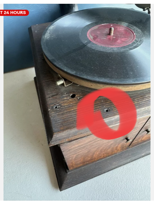

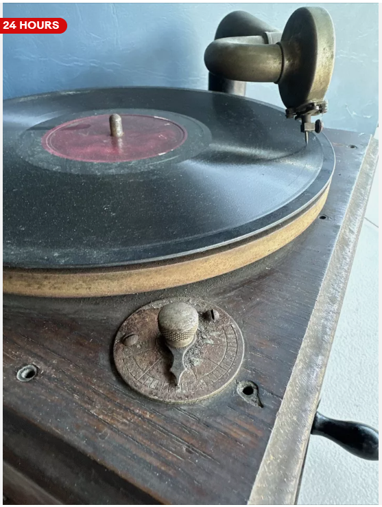

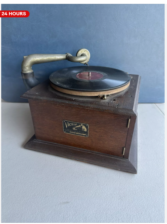

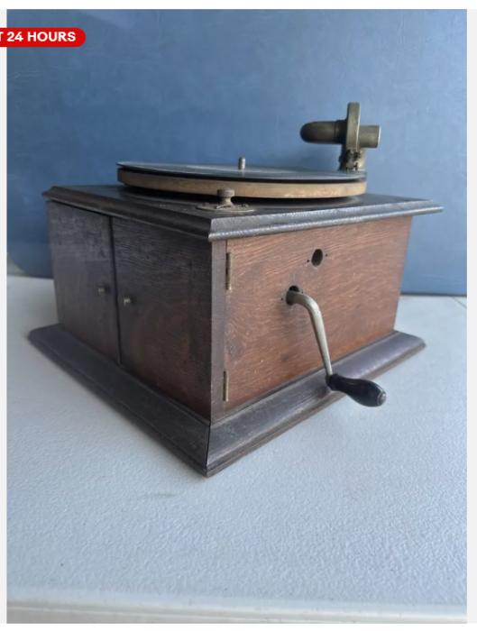

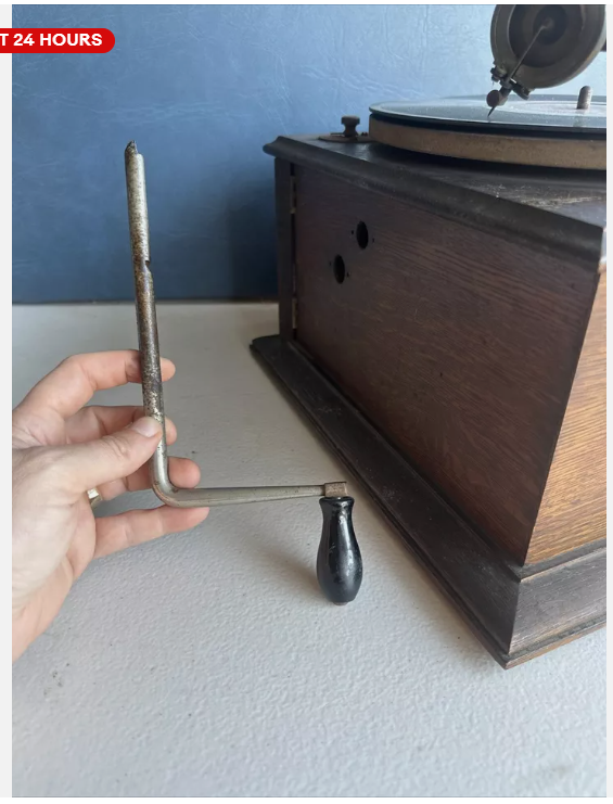

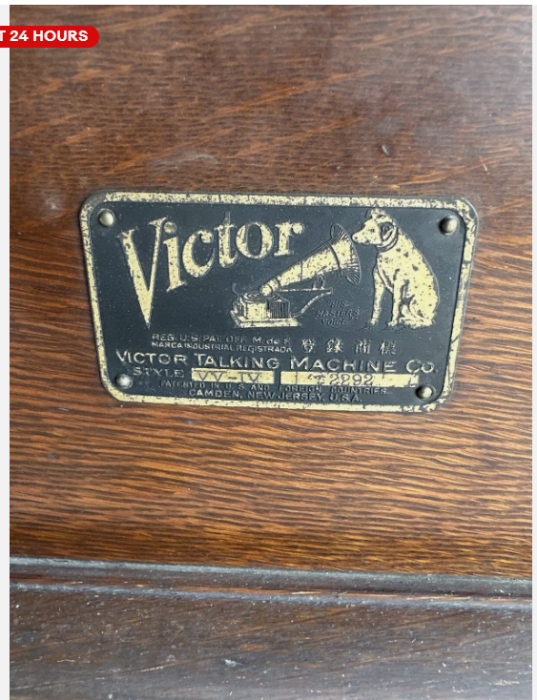

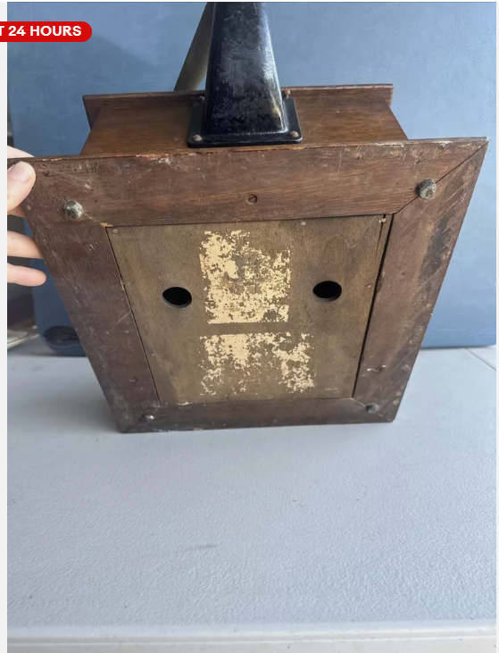

I just pulled the trigger on a Serial # 2292 Victor VV-IV - it was on fleaBay, It's motorboard, motor, crank, speed control and brake are wrong, but it does have that cool perforated steel grill, the No. 15 reproducer and a nasty patina (which I actually like). Aside of the previously mentioned parts, I'll also need a crank escutcheon. The stage left side has an additional hole that I'll just plug initially. After tax and shipping it's just under $250

Posts: 6828
Re: Early VV-IV Victrola
Why do you think the motor board is not correct? It certainly appears to be a VV-IV motor board. I'm thinking it just got jockeyed around a bit to suit the crank alignment of the new motor. Once re-centered, and with the proper motor, it may end up being just fine.
zipcord
Posts: 259
Location: Albany, CA
Post by zipcord »

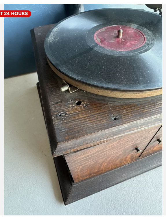

the motorboard didn't look deep enough - and I didn't notice any holes where the speed control is normally found. I suppose if I flip the motorboard, it might be correct. I'll see next month when the machine arrives

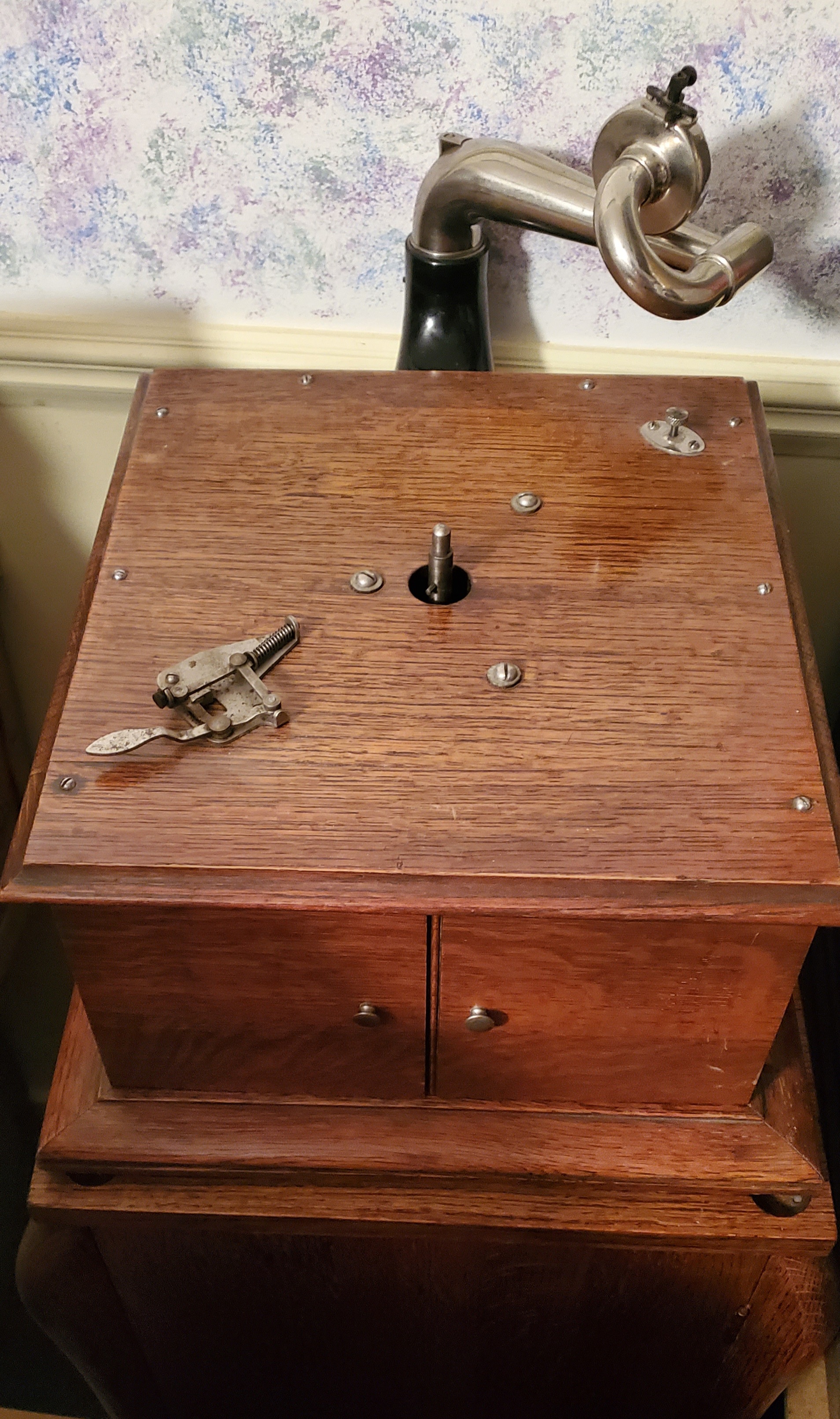

It looks to me as if the motorboard is original, but has been rotated 180 degrees. The holes for the original speed control on your machine are right in front of the currently installed brake, which is also not correct. I've included a photo of one of mine for reference. I suspect that motorboard, although the original one, is going to have several extra holes in it.

Aha! That's the trick! There are screw holes on top of the doors, and this side of the motor board is the one without screws!
See this:
There are three sides with screws, and the one that has no screws must go on top of the doors.

I thought I should post a correction to my previous post. According to the Victor Data Book, the VV-IV Type M (metal grille) was supplied with the round plate #1203 brake, which is what appears to be on this machine (and was moved when the motor swap was done). However, both of the Type M machines I own (Sn 6963 and Sn 9826) are equipped with the "scissor" friction brake #1918, and both are definitely original. So, it appears to me that at some point a brake change was made and that the brake currently on this machine may well be original. Removing the turntable should confirm this.
