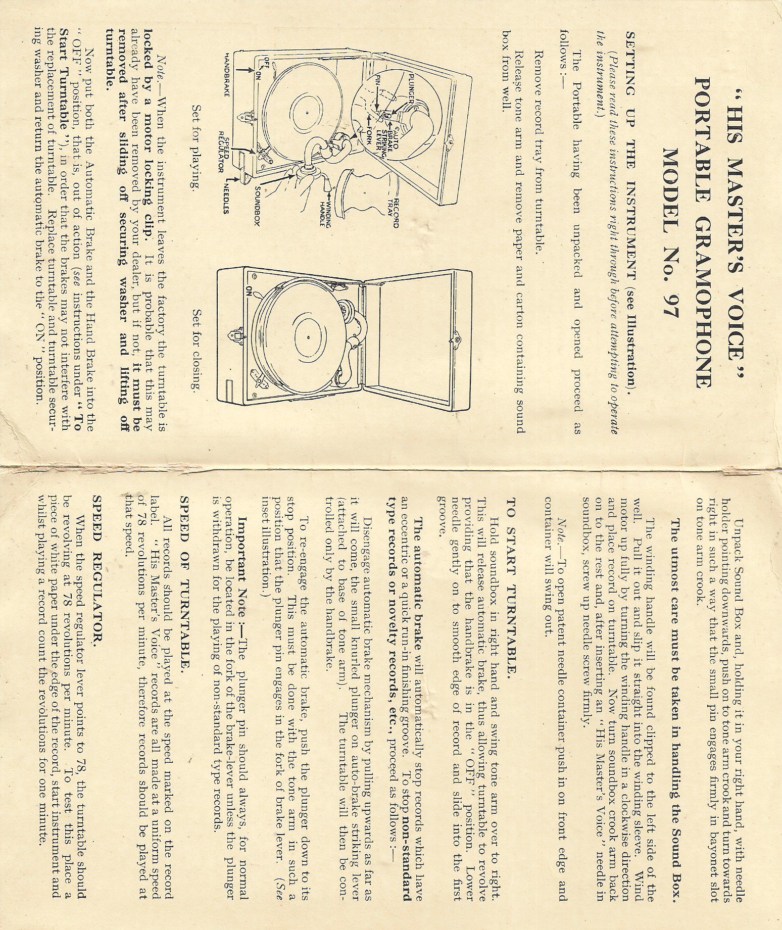

The winding handle clip is located to the left of the horn aperture, below the lid stay :

Hi !epigramophone wrote: Fri Sep 20, 2024 4:42 am The winding handle clip is located to the left of the horn aperture, below the lid stay :
Thank you for sharing the extract from the 'assembling and operating instructions' for HMV Model 97. The 'winding handle' in the diagram is actually indicating the slot, located right above the carrying handle, for inserting the key to the machine. I have removed the platter from the motor board of my 97 C machine to see if there are any screw holes, suggesting that once a winding handle holder rested there, but there are none. Even the motor board does not have a cavity, where the winding handle could be laid to rest. I have checked the lid but it does not show any signs of a specified place for the winding key. This is becoming very puzzling to understand why there was no designated space for the winder in the 97's case.

P.S I just discovered for myself the screw impressions on the right wall of the wooden case, next to the lid stay. where the catcher used to rest.Sherazhyder wrote: Fri Sep 20, 2024 1:56 pmHi !epigramophone wrote: Fri Sep 20, 2024 4:42 am The winding handle clip is located to the left of the horn aperture, below the lid stay :
