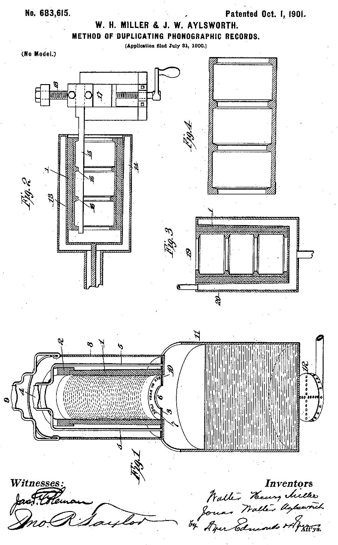

October 1, 1901: Walter Miller and Jonas Aylsworth were granted a U.S. patent (No.683,615) for “Method of Duplicating Phonographic Records.” This important process would allow for the appearance of Edison molded cylinder records in January 1902.

Many times I've read about this process, but there never was a line about how it was practically made. Is there anyone who can explain in few words what the trick is?
I can't think to anything else than a mold with two halves, but I suppose the problem would be the joins of the halves, which would almost surely return a "click" during playback. The patent images seem to give no real clue about how this issue had been circumvented.

Marco, my understanding is that the mold was in a single piece. The process relied on controlled heating and shrinkage: the molten wax (actually it was a soap, not wax) was poured in the oversized mold, and let shrink as it cooled down and could then be removed from the mold. The key factor in the process is that the cylinder is not actually a cylinder, but a truncated cone, so it could slip out of the mold by its shorter diameter end. This asymmetry was object of various patent fights between Edison and Lambert, as Lambert also made *conical cylinders* (an oximoron) to fit Edison machines (Edison lost). This fight is described in the interesting book From Tinfoil to Stereo, originally written in the 50s. I have a reprint from1994.Marco Gilardetti wrote: Wed Oct 02, 2024 10:51 am Many times I've read about this process, but there never was a line about how it was practically made. Is there anyone who can explain in few words what the trick is?

Thanks for the very understandable answer, Carlos! Ingenious process, and quite difficult to fine-tune precisely I suppose.
I now wonder if from that point onwards, cylinders were always duplicated that way until their commercial demise. Their long-time gauge stability seems a point of concern.
