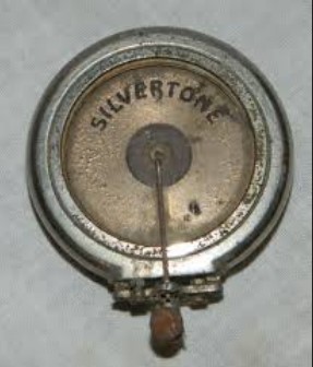

Is that, by any chance, a Sears "Silvertone" sound box (reproducer) attached to the end of the tonearm? Similar to this one?
Screenshot 2024-10-03 183327.jpg (23.48 KiB) Viewed 984 times
If so, it's incorrect for the machine, as well as the types of records produced during WWII. That style of Silvertone reproducer was used for playing pre-1925 acoustically recorded records.
The post string here -- viewtopic.php?t=53235 -- shows a nice close-up image of the correct style sound box.
Unlike the Silvertone sound box, it was equipped with a more flexible aluminum diaphragm.

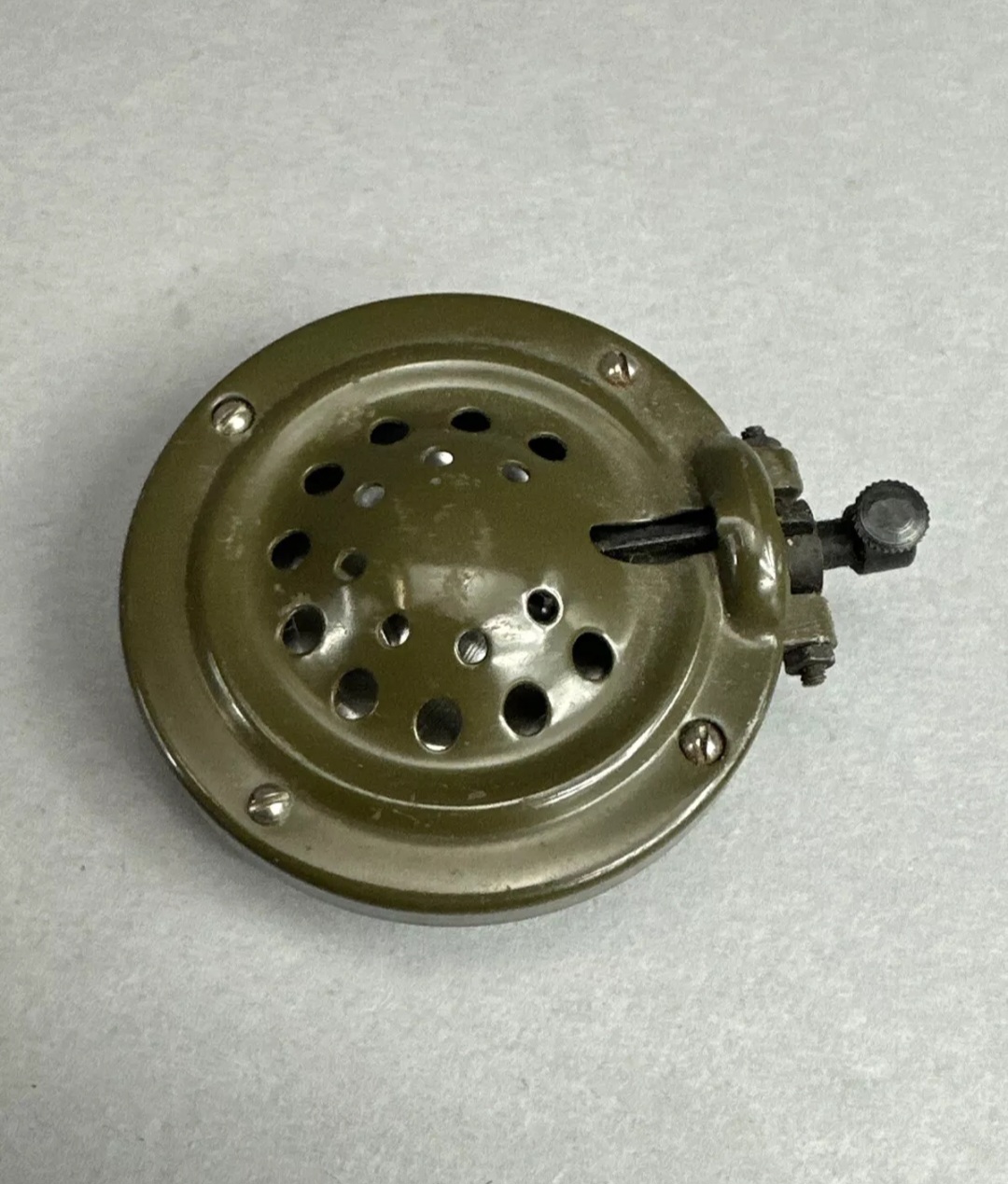

Yep that is what was on it when i received it. I just purchased this reproducer, below. Maybe that is my whole issue.

I'm not as experienced as most members but I have the same phonograph as you do and had the same parts missing as yours. Funny but my reproducer and tonearm was completely missing and I had a old Silverstone with that same tonearm you put on yours and that same reproducer you are using now. I found that the reproducer has to sit at just the right angle to play well. Once I got that straight it plays loud and any record. That screw on the reproducer can be used to change the angle it sits on. Good luck with your project I hope you get running as they are great playing machines.
