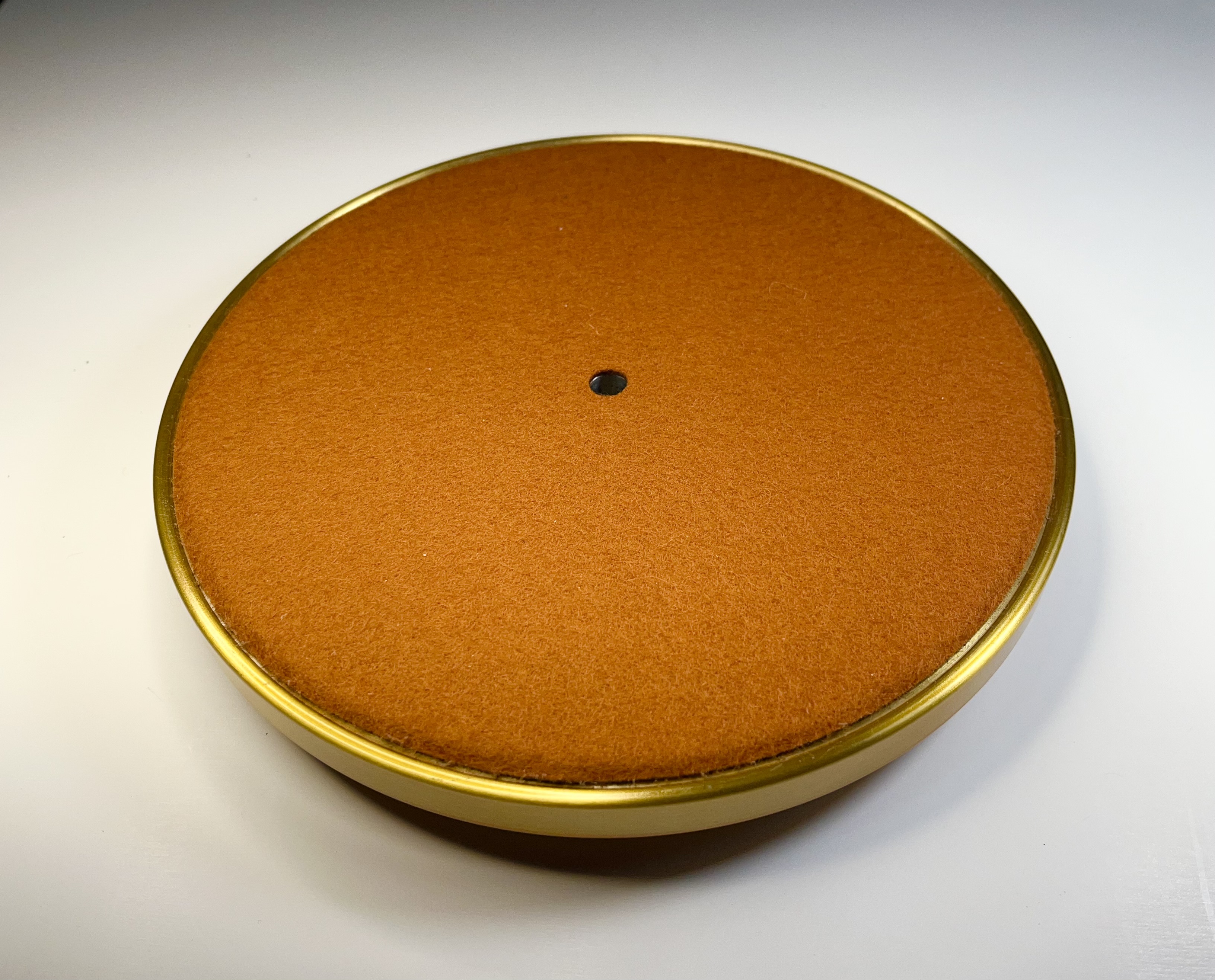

Replacement aluminum turntable for the often warped pot-metal turntables on the1927 Victor Automatics.
The changer does not work reliably without a flat turntable.
Cost is $195 plus postage. Add $10 if you want the laser-cut felt included and attached.
The felt is 100% wool like Victor used, it is the correct golden -orange color, not brownish like it appears in the photo.
Mark
