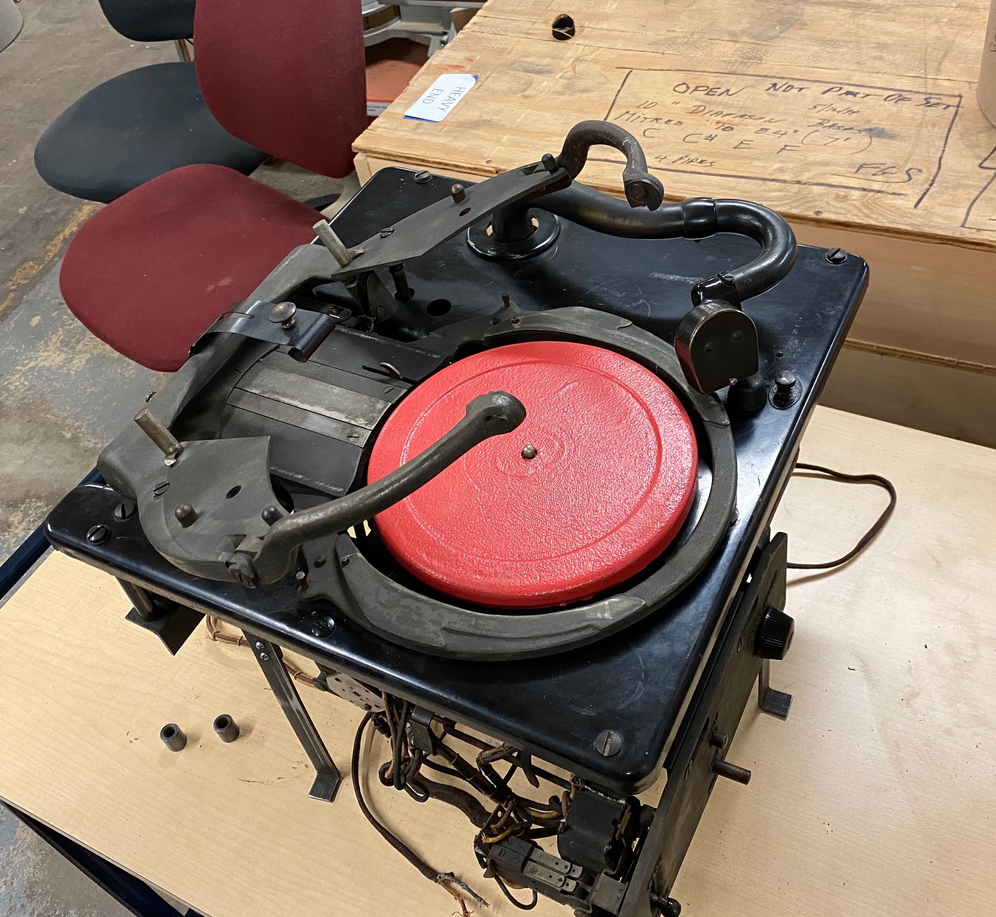

A side note: Though not technically correct, these turntables work well on the 1928 second design or Type 2 changers also. These are the ones with the heavy laminated rubber coatings that get dry/ brittle/ cracked and thus no longer "throw" the record properly when the finger pops up to throw the record. The felt has enough grip to do this. I have a 10-50 turntable on my 10-35 and it solved the appearance and function issues perfectly.
Mark- any chance of making these with a rubber coating so as to be 100% correct for these machines? As you likely know, they came in black or red, I think.

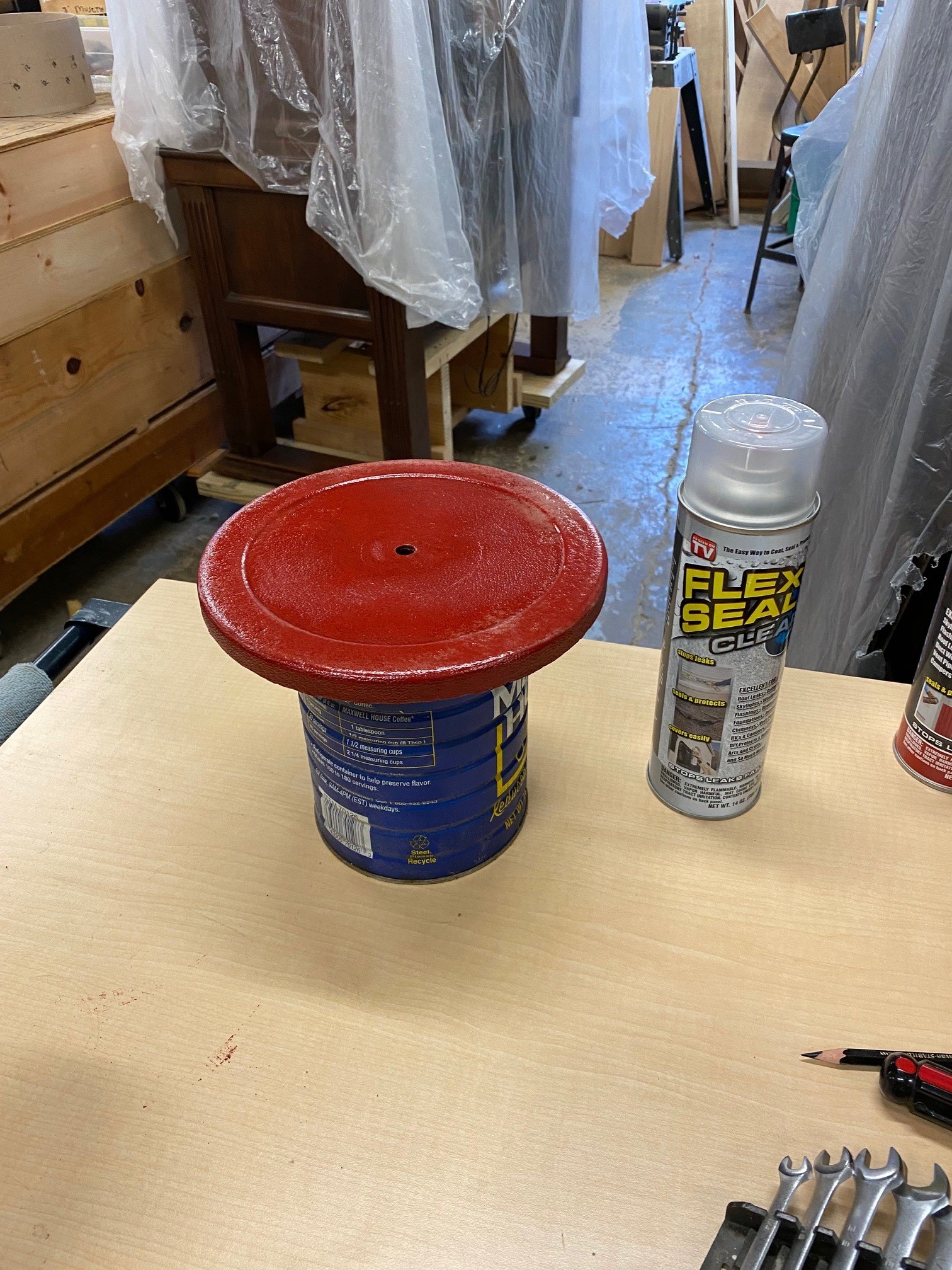

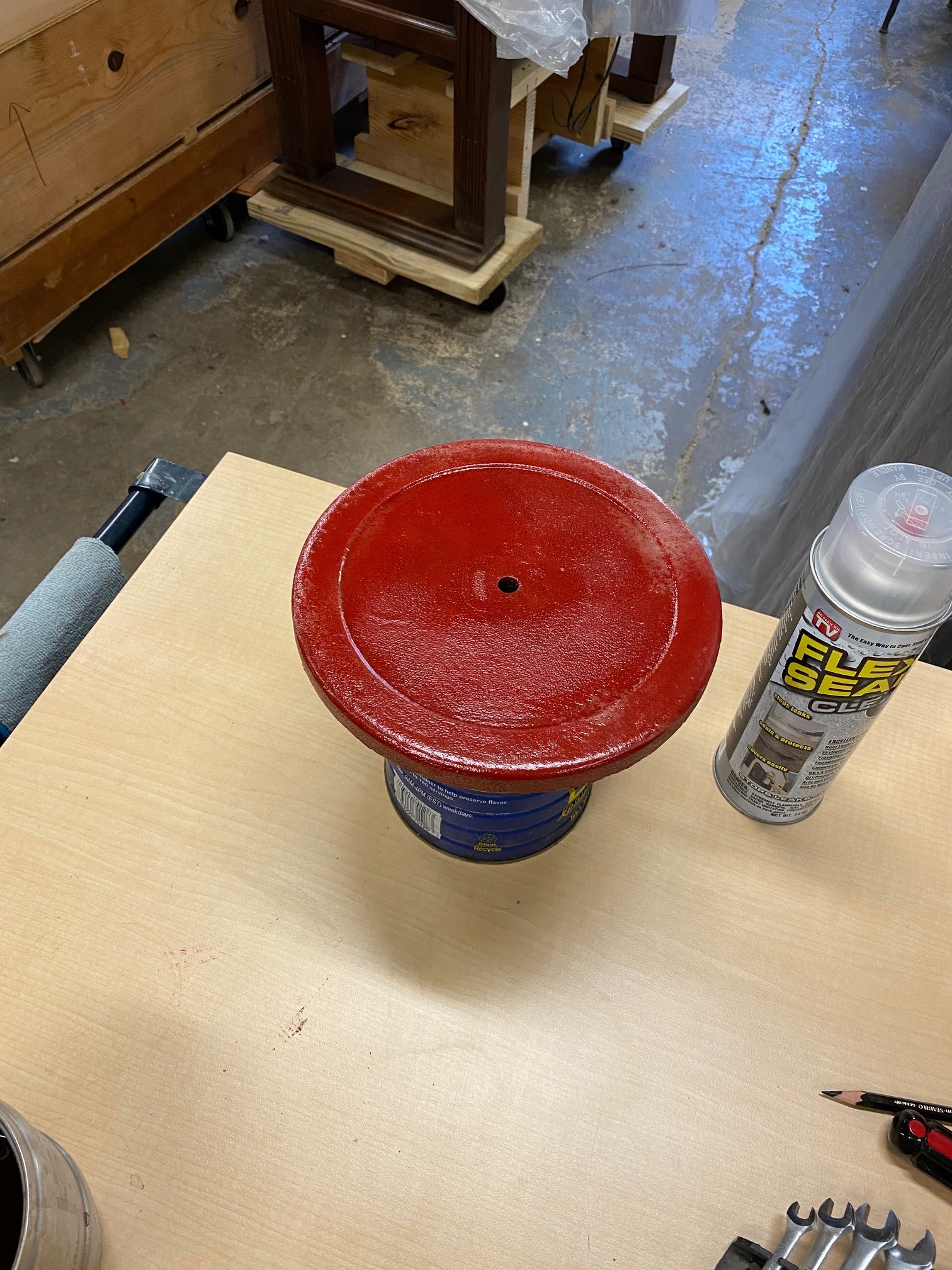

George, There are 3 methods that you can do to your 2nd generation Victor rubberized turntables. All of these methods keep the correct appearance of the changer.
First: Cover it with thin leather using spray adhesive. The leather will form all the way around the edges. This was initially how I fixed all of my 2nd gen turntables before the spray rubbers were on the market.
Second: Use Flex-Seal spray on rubber coating. Comes in black, red and clear. This is a method I have used many times. I suggest several heavy coats of the correct color then another of clear.
Third: Use spray Dip-it and coat the turntable. Comes in black and red. It is a vinyl coating. I have been told this works by other changer collectors.
Using leather:
Using Flex Seal:

Mark, so when using the Flex-Seal do you strip off the original material and then spray or keep it on and over spray?
Thx Abe
electrolaman 64
Posts: 259
Location: Indianapolis, IN
Re: FS: Replica Turntable for Victor 10-50, 10-51, 9-55 and 10-70
Post by electrolaman 64 »
need4art wrote: Tue Oct 15, 2024 5:44 pm Mark, so when using the Flex-Seal do you strip off the original material and then spray or keep it on and over spray?
Thx Abe
Carlton Abe not Mark. :lol: Clean the original surface best you can then spray on top of it.
