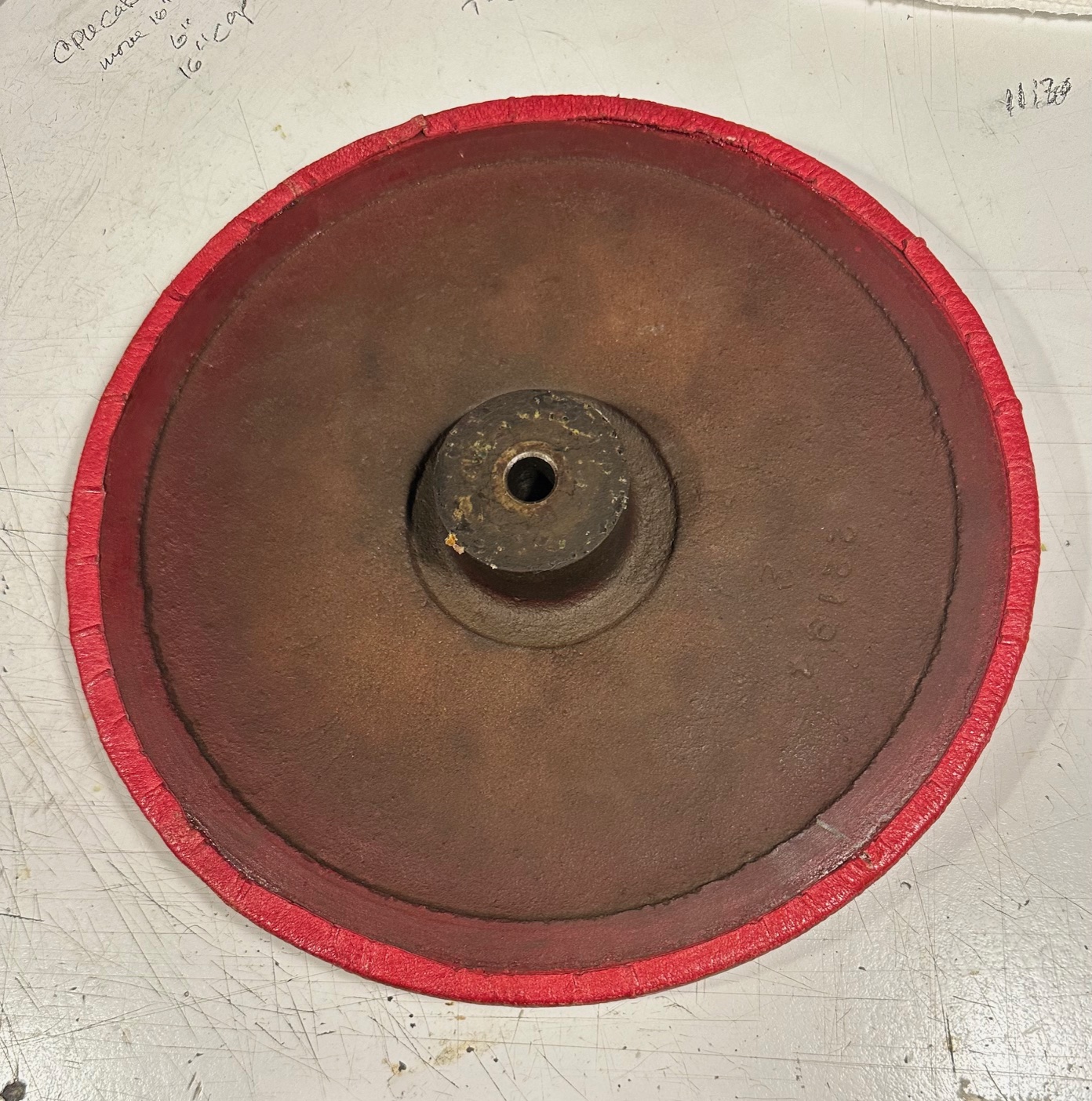

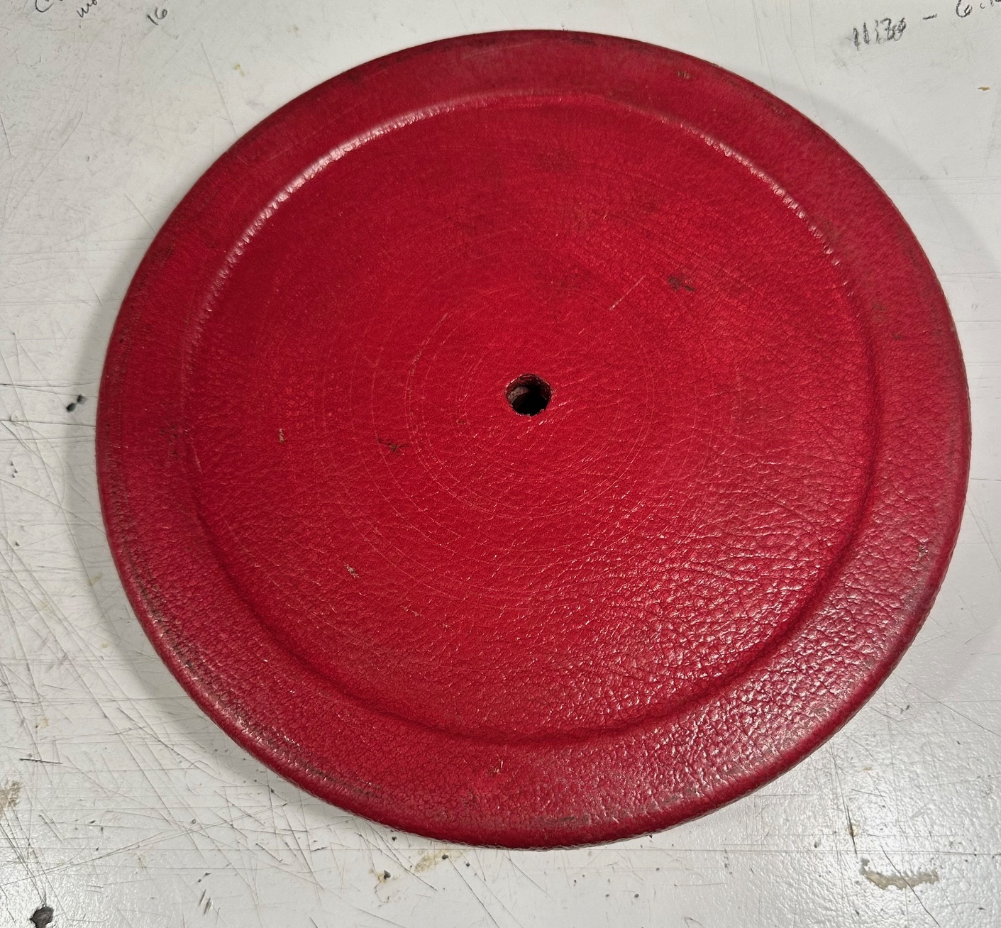

George, There are 3 methods that you can do to your 2nd generation Victor rubberized turntables. All of these methods keep the correct appearance of the changer.
First: Cover it with thin leather using spray adhesive. The leather will form all the way around the edges. This was initially how I fixed all of my 2nd gen turntables before the spray rubbers were on the market.
Second: Use Flex-Seal spray on rubber coating. Comes in black, red and clear. This is a method I have used many times. I suggest several heavy coats of the correct color then another of clear.
Third: Use spray Dip-it and coat the turntable. Comes in black and red. It is a vinyl coating. I have been told this works by other changer collectors.
Using leather: Using Flex Seal:

Mark, so when using the Flex-Seal do you strip off the original material and then spray or keep it on and over spray?
Thx Abe
Thx Abe
- electrolaman 64
- Posts: 259
- Joined: Fri May 18, 2018 7:49 pm
- Personal Text: Look for the Dog
- Location: Indianapolis, IN
Re: FS: Replica Turntable for Victor 10-50, 10-51, 9-55 and 10-70
Carlton Abe not Mark.need4art wrote: Tue Oct 15, 2024 5:44 pm Mark, so when using the Flex-Seal do you strip off the original material and then spray or keep it on and over spray?
Thx Abe
