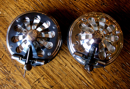

I have had one silverplated and oxidized some 25 years ago.
Dissembling a 5a without breaking is the most difficult part....

Interesting. I only need the tonearm improving, which is easy to remove without the risk of damage.
Where did you get the job done? A jeweller or a metal finisher?

I too would like to know.epigramophone wrote: Wed Oct 23, 2024 4:08 am Interesting. I only need the tonearm improving, which is easy to remove without the risk of damage.

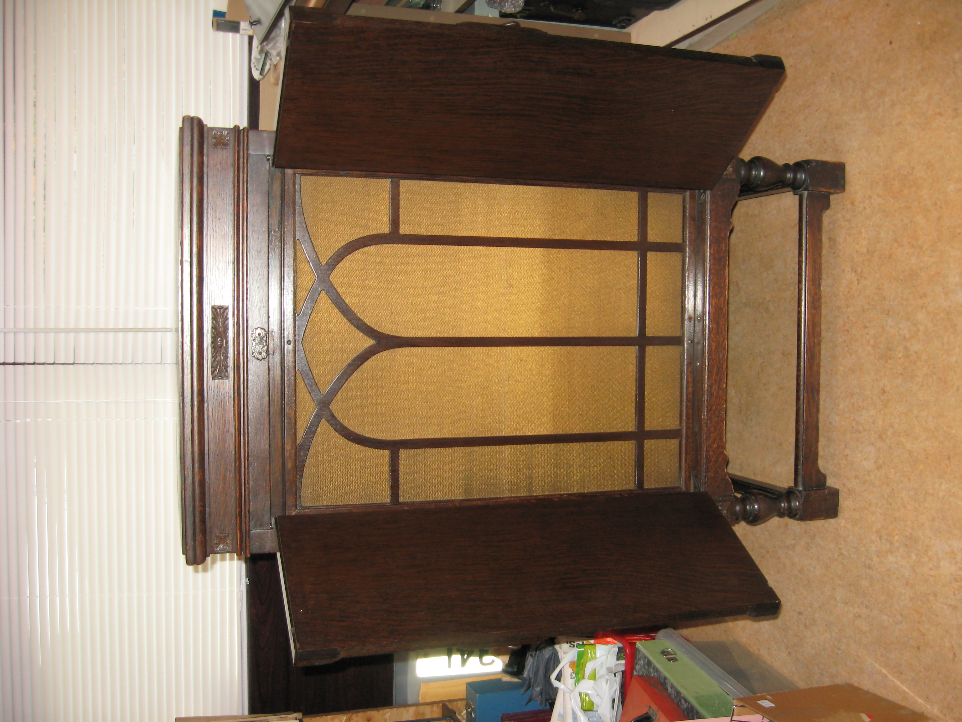

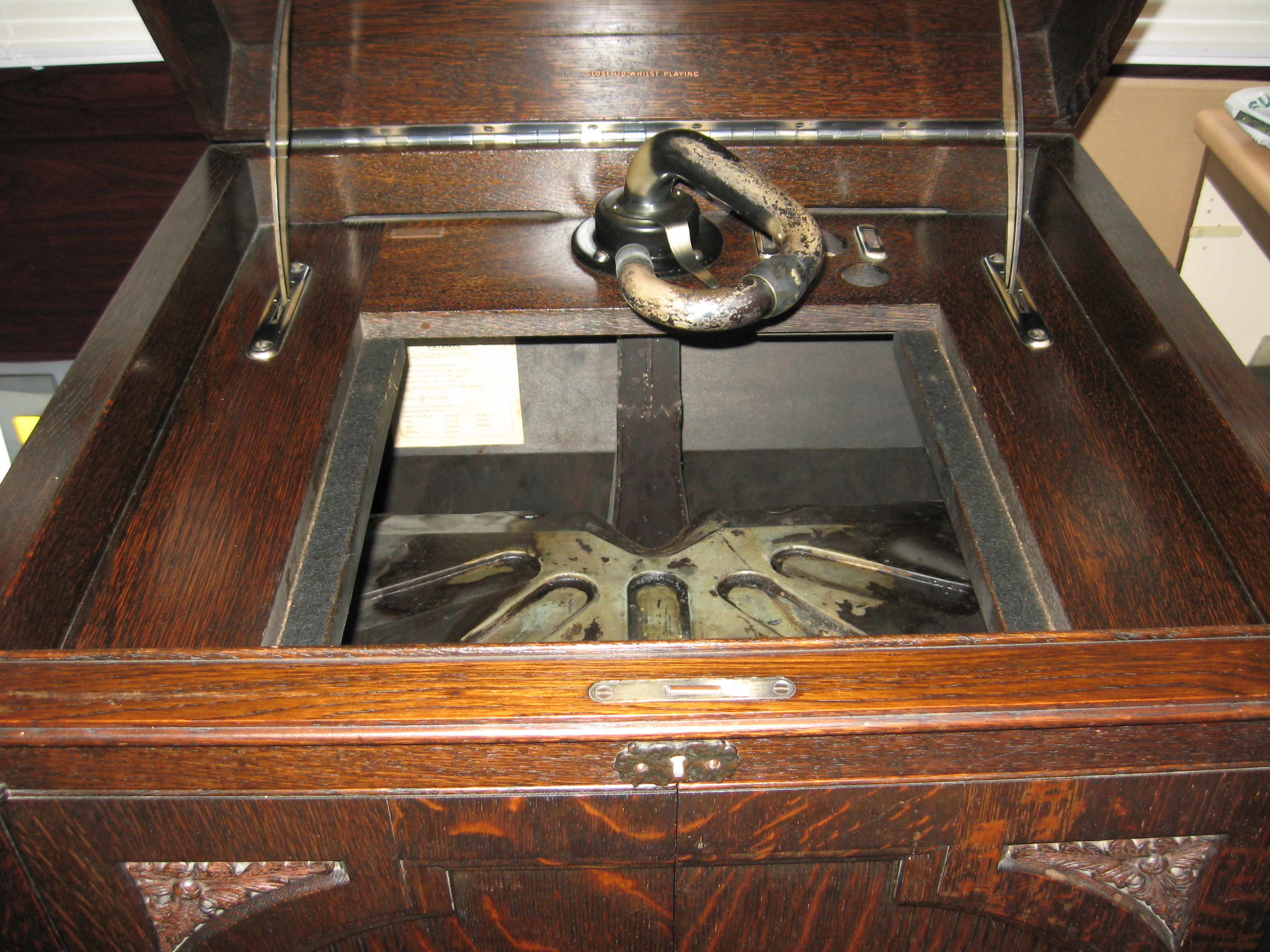

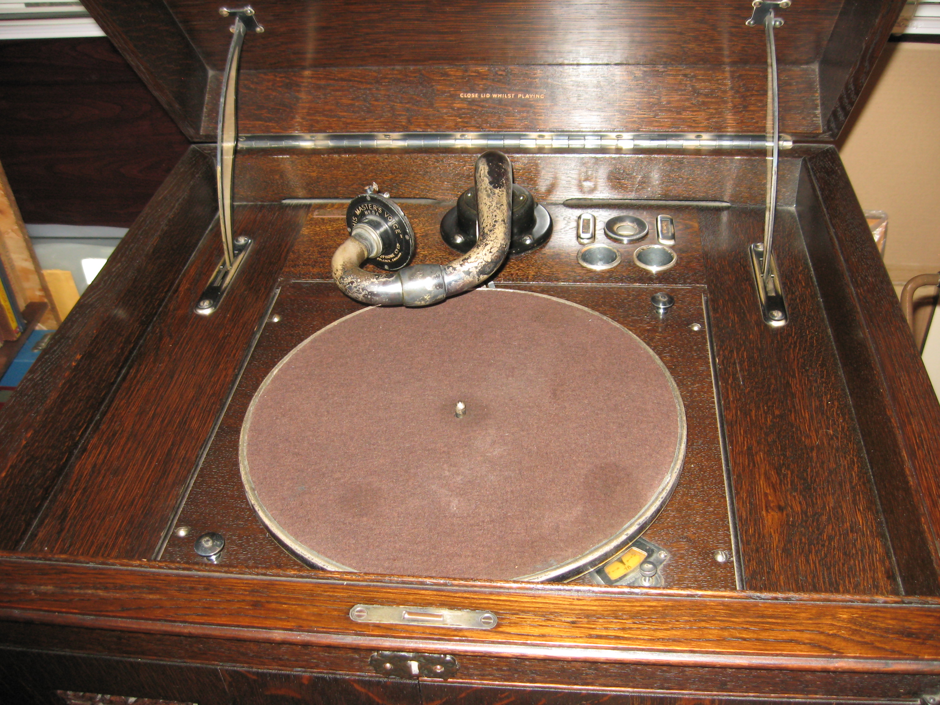

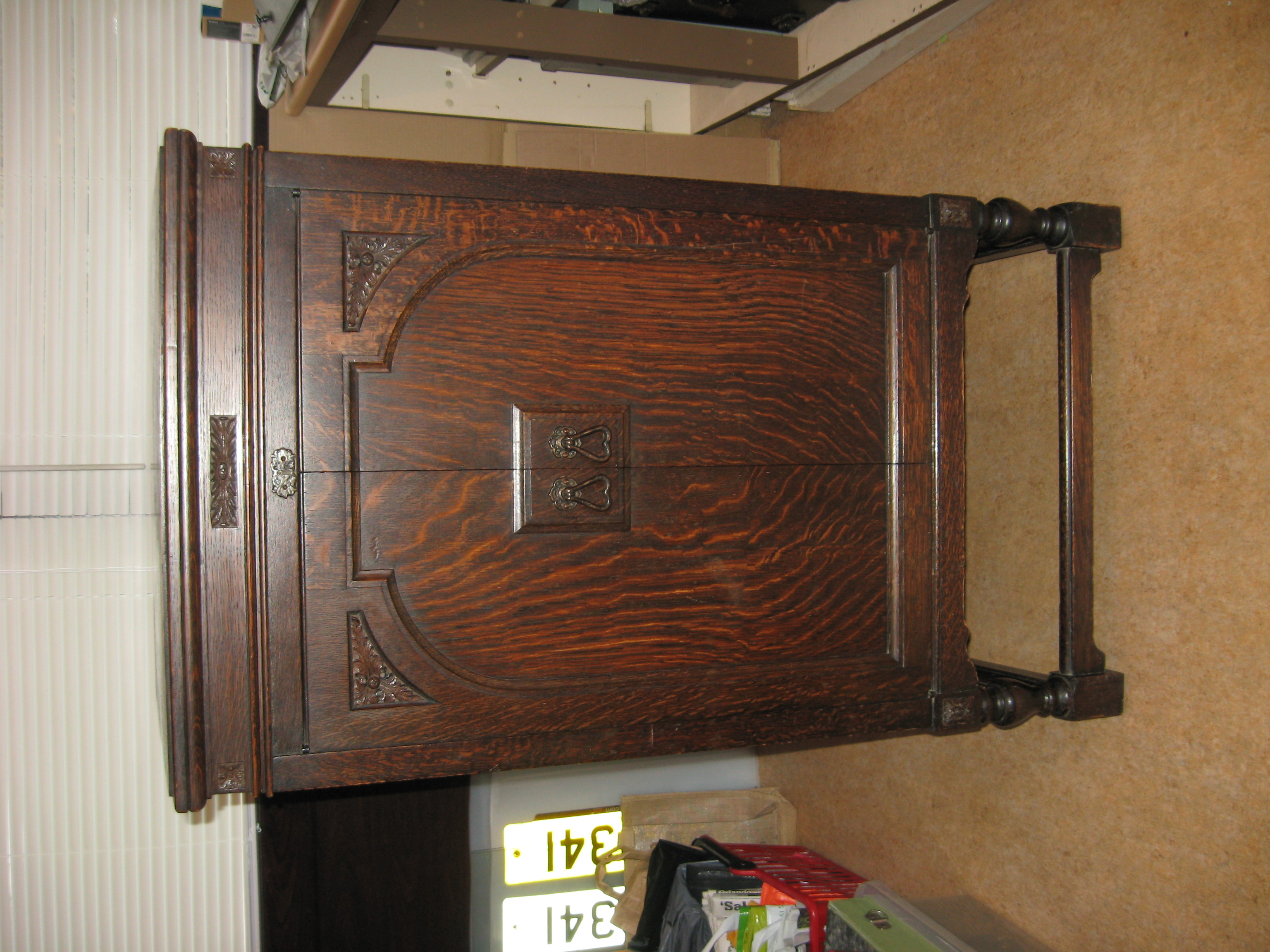

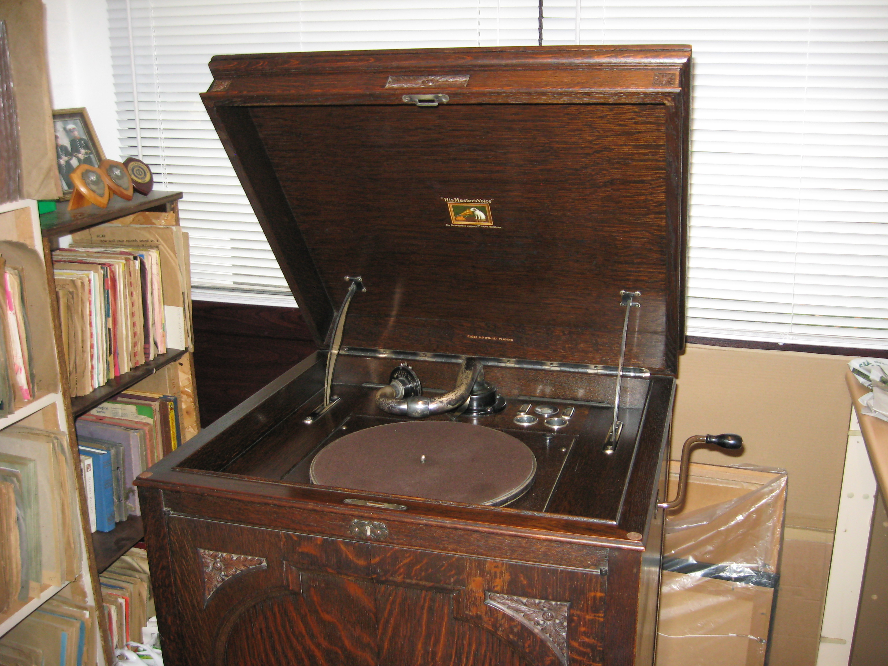

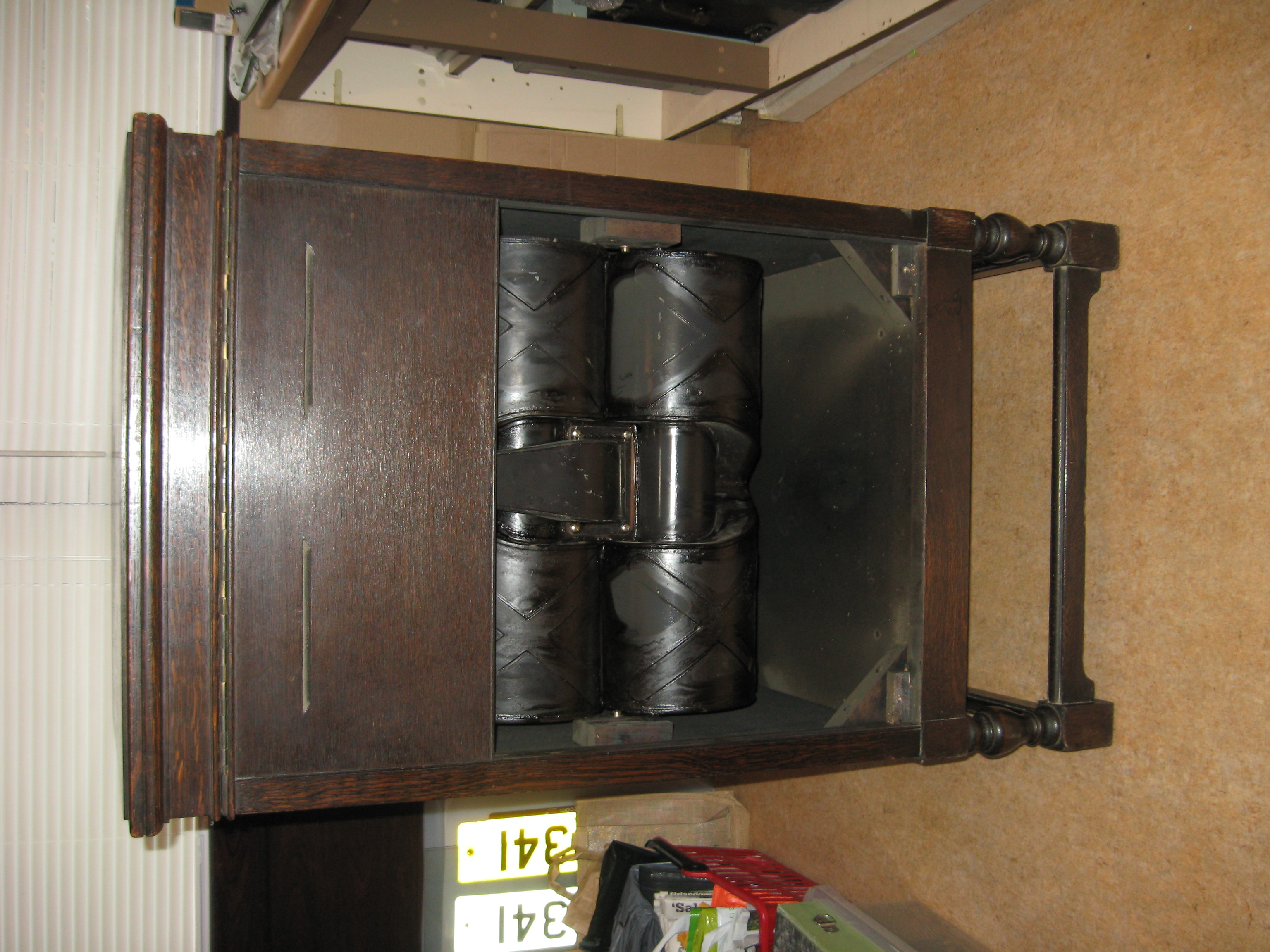

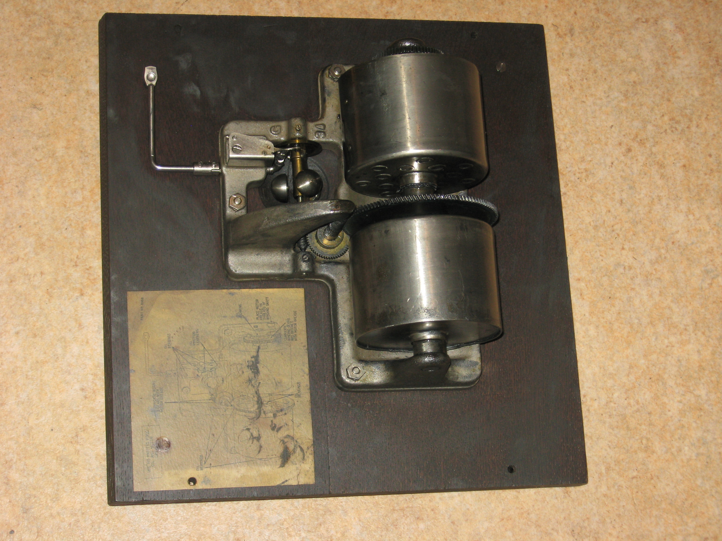

As promised, pictures of the new arrival. They were the right way up when I added them :

Fabulous machine. Congratulations, Roger, on a great acquisition. The condition is very good.
I wouldn't worry about the shadow mark at the bottom of the grille cloth. My 202 has an identical mark in the exact same spot. I think a lot of these models have the same mark in the cloth for some unexplained reason.

Thank you Steve. A friend's 163 also has the same shadow mark. Very strange.

Click on the images to reorientate. Many congratulations Roger---a fine instrument.epigramophone wrote: Sun Nov 10, 2024 11:03 am As promised, pictures of the new arrival. They were the right way up when I added them :
