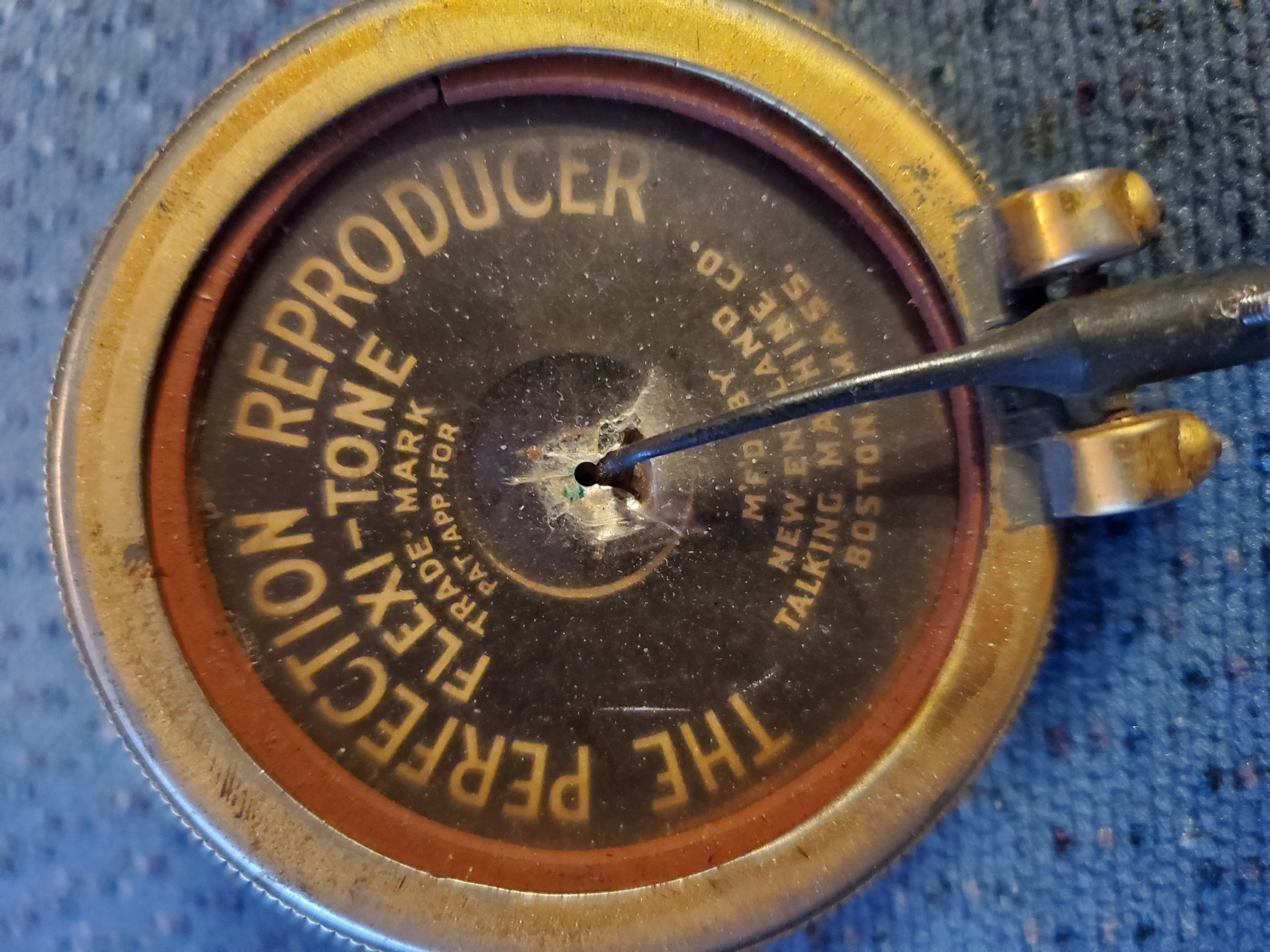

First post here. What is the best way.to repair a mica diaphragm? Can one use super glue? See attached. Thx

I have diaphragms that look as if they have been repaired using shellac, but this was for separation of layers of mica, not for a big hole. And I don't think the repairs offered optimal sound.
It is better to rebuild the reproducer. Replace the mica and gaskets. Clean up and lightly lubricate the needle bar pivots.
Mica and generic gasket tubing and bees' wax are not expensive. I have had good service from The Phonograph Shop for this stuff.
Rebuilding a reproducer is not a terribly difficult job. It just requires patience and caution. Go slowly. Don't force anything.
Watch some Youtube videos on how to dismantle and rebuild similar reproducers. Take things apart. Measure what sizes of stuff you need. I always order extra to allow for errors.
And if you don't want to do it yourself, there are people who specialize in rebuilds and who are reported to be wizards at the work.

The most difficult part of a rebuild, is keeping track of and replacing the tiny screw on the back of the mica...

Definitely not necessary to fix the mica, replacements are available from the Phonograph Shop for a nominal price. Good luck!
