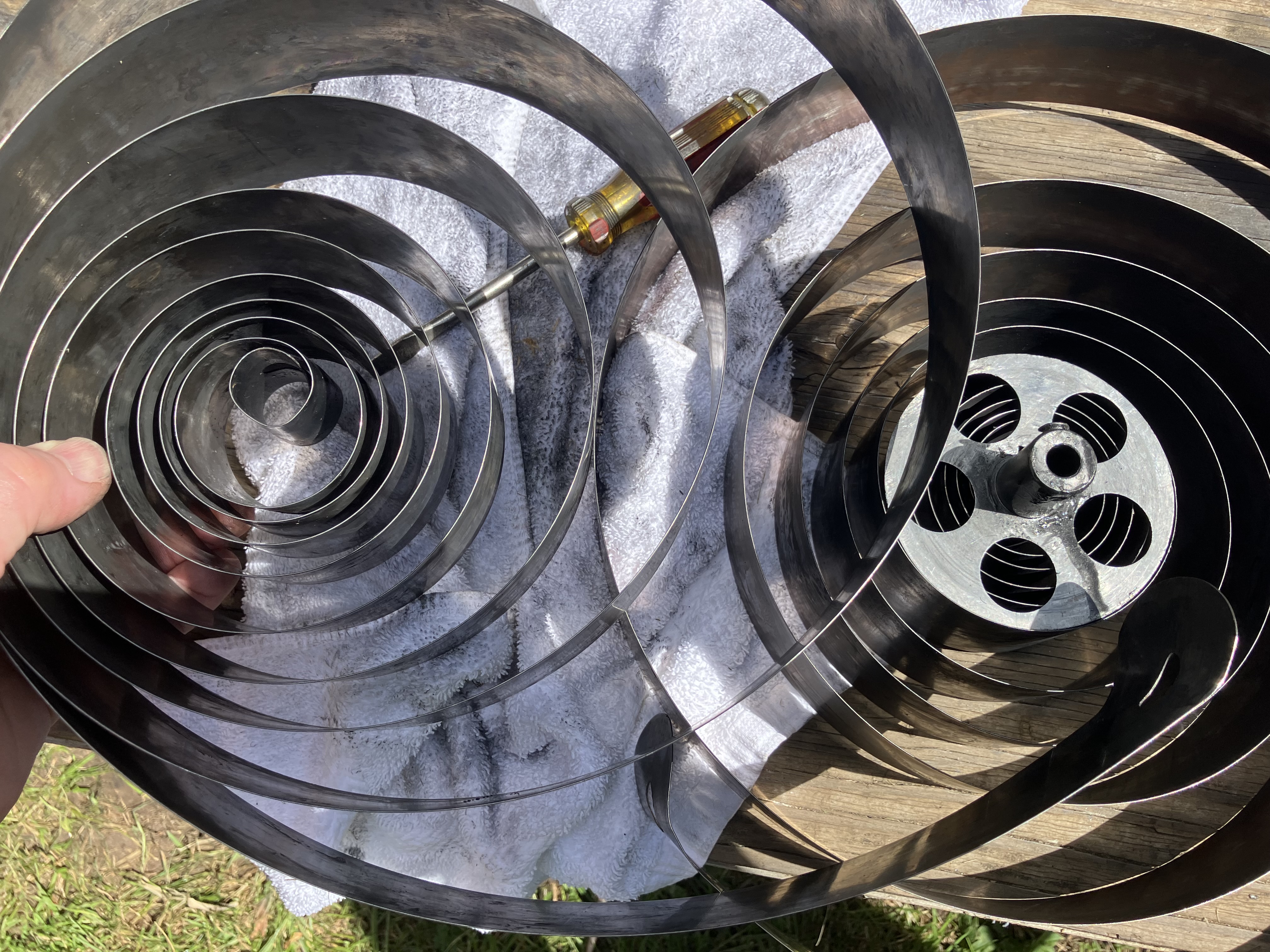

Just curious, was this from a previous disassembly, or did you disassemble it since starting this thread?
mjbarnes
- Posts: 213
- Joined: Fri Jul 11, 2014 10:34 am
Re: How many records per full wind?
I removed, cleaned, and greased the springs a few months ago. Putting them back in the barrel there was always one tricky moment just before the centre dropped in: resistance and me wondering if I was stuck holding the spring down forever. Then the final section always slid in.
