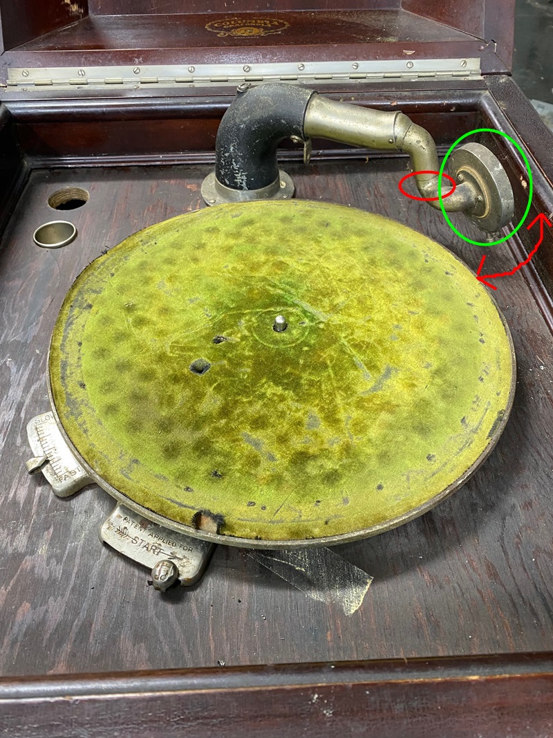

I know nothing about theses machine and look forward to any opinions you are willing to share. I recently picked up this floor model for 35 bucks with the intention of flipping the cabinet as a bar as the ad said "not working". However upon inspection it appears to be working just fine. So now I plan on reviving it for my basement bar/pool hall and playing records. It appears that the arm and plynth have been replaced over the years. The arm is a Cecilian, or it looks like that under the mica thing. I'm good with keeping it all as is. I'm think of three options:
a) Clean the cabinet and all the mechanicals, replace platter felt, and call it good.
b) All the above and refinish the cabinet and fix the missing record shelves.
c) full restoration with original parts.
Honestly I'm leaning towards a. Fully funtioning but looks cool. Also if you know the model that would be great. Thoughts????

Photos are at that imgur link in the original posting. It looks like one of the $75 Grafonolas sold as Leader and under other model names from 1914 through the early 1920s, but hard to tell for sure comparing the photos to the Brumbach book's old engraved cuts. The tonearm and reproducer are definitely not Columbia issue--probably replaced when the original arm got the dread Pot Metal Columbia Tonearm disease. The motorboard is a replacement as well; it appears to be just a piece of plywood that's been cut more or less to fit and stained more or less to match the cabinet. The platter/speed control/what have you assembly, however, looks like Columbia parts to me--but I'd be the first to admit that I am at most very casually familiar with Grafonolas. No telling from the photos if it has the telltale extra holes in the crank side that would indicate it's been remotored. The photos don't show whether it has a pushbutton ejector system for record storage, either, but reading between the lines in the original post I gather whatever was there originally has been gutted.mrrgstuff wrote: Fri Nov 15, 2024 8:03 pm I know nothing about this particular machine, but personally, all I ever do is (a). I don't even replace the platter felt unless it absolutely needs it![]()

To the original poster: First off, welcome, and congratulations on buying the Grafonola! It's an attractive machine, and it would be a shame to gut it and turn it into a bar. Frankly, I think it's a shame to do that to almost any old machine, but that's just me. If you want to put it back into original form, you'll need to get some, maybe a fair number of, replacement parts and do some work, but you could end up with handsome results. I wouldn't put too much money into it, however; it's not something that would bring a high resale value, at least in my opinion. If you just want it as a functional but not fully "authentic" accessory with which to have some fun, your (a) option is perfectly reasonable. To make it serviceable, you'll need at a minimum to have the reproducer (aka sound box, the round part with a clear diaphragm at the end of the tonearm) serviced and the motor cleaned and relubricated. Both are in the nature of "routine maintenance" items and shouldn't be terribly expensive. Replacing the by-now-rock-hard rubber gaskets in the reproducer will make an incredible difference in how good the machine sounds, and motor service is needed to prevent old, gummy grease and oil from causing undue wear to the mechanism.

Besides that, your non-Columbia tonearm and reproducer have certain advantages; when restored and well greased, i mean that ball-like junction and the junction at the base, also the revolver junction that allows turning the soundbox tho play Pathé vertically modulated groove records... It will sound quite good.

If I follow you correctly, I need to disassemble the arm and grease the junctions so all the sound travels down the tube?

Not to affect the sound, but to make sure the arm components move freely so that they won't lock up or cause undue wear when you play a record. The one at the base and the ball joint need to move with no resistance; the entire arm assembly needs to swing very freely side to side, and the segment with the ball joint needs to move freely up and down. Referring to the photo below, the joint circled in red will probably have some sort of click stops but should let you swivel the reproducer, the part circled in green, freely from pointing right to pointing forward and back again, as shown by the red curved line. Be careful; if, as seems likely, it's pot metal, it may have frozen up, in which case it will be easy to break. Unless you acquire some vertical cut records, like the Pathés that have been mentioned, there's no need to mess with this adjustment, as it's already set up for conventional lateral cut records, far and away the most common and the most likely that you will find without going out of your way to acquire them.TomGallopavo wrote: Sat Nov 16, 2024 5:14 am If I follow you correctly, I need to disassemble the arm and grease the junctions so all the sound travels down the tube?
