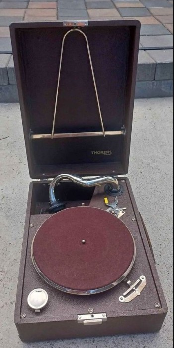

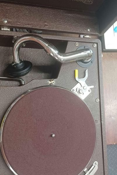

Also, I cannot fathom how what appears to be an auto-brake mechanism might work. Have there been modifications to this machine?

I've seen that break in other German en Swiss machines, it is pretty standard, You start the machine moving the arm away from the center until the rod under it touches the outer side of the fork, and then it will stop when the rod touches the inner side.

Lah Ca wrote: Sat Nov 30, 2024 10:21 am Also, I cannot fathom how what appears to be an auto-brake mechanism might work. Have there been modifications to this machine?
I was also confused by this but I believe that the vertical rod, mounted to the underside of the tonearm, is partly camouflaged in the first picture. As mentioned by Carlos this engages with the fork below.
