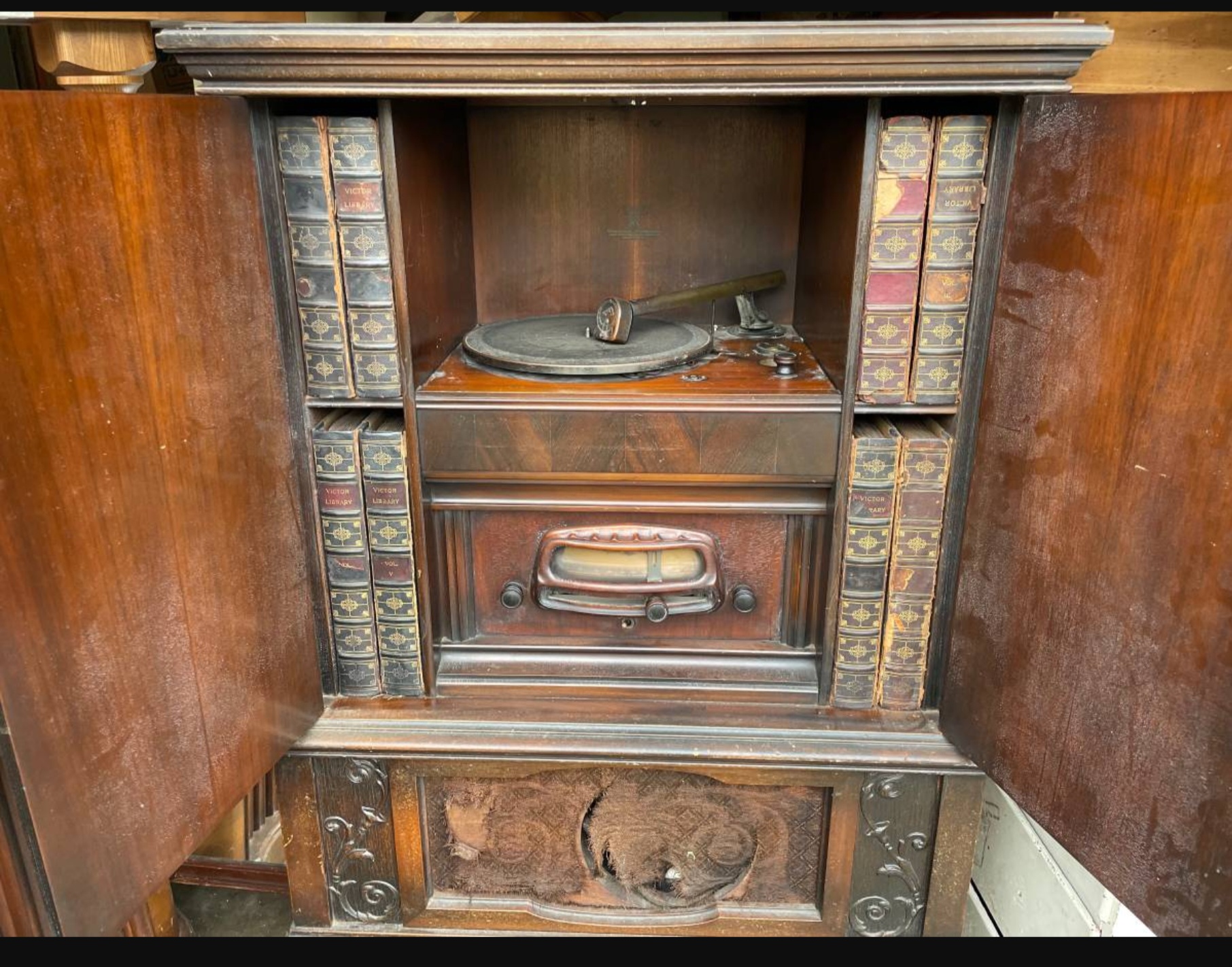

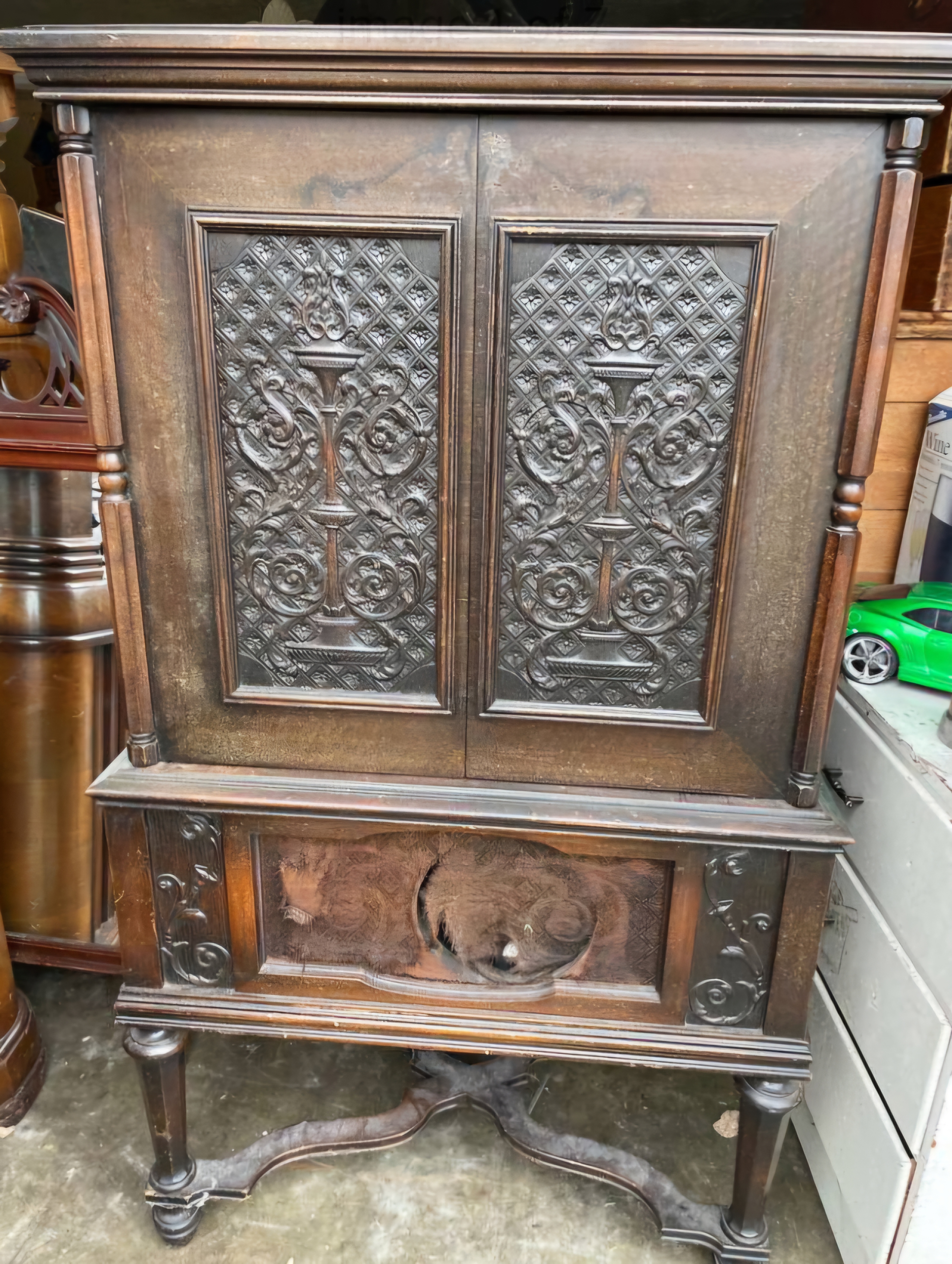

How hard are these to work on and get running? I've found one close by and was thinking about getting it if I can for a really cheap price.

Travis, The RE-75 is from 1920-1930. Most of the time this particular model electronics will still work without any electronic restoration. But the horseshoe pickup must be rebuilt with new rubber parts or you will not get any sound. The speaker surround is leather and it usually is rotten so must be replaced as well. Now that said you should really not just plug it in an turn it on without some direct fused protection. I generally use a Variac with a 15A breaker to pretest all of my Electrolas. I bring the voltage up slow. If there is a power circuit problem it will trip the breaker instantly. If it within a few minute or so trips the breaker then it can be a bad or several bad capacitors. If you do plug it in an power it up and hear a loud buzzing in the speaker then turn it off immediately as that is a sign that the capacitors in the power circuit are indeed bad. Leaving it on will burn up the power transformer. It is a shame that this RE-75 has the grille cloth is ruined as it is a unique tapestry print that you cannot find reproduced today. It is a plus that is has the original leather bound albums even though they may be fragile, they are important to retain historically. If you would like to hear one of these you can listen to my videos:

I reworked one of these a few years ago. Especially if you know how to solder, no big deal. I checked the main voltage divider resistances and replaced a few sections of it with resistors, and then I replaced the 5(?) or so paper capacitors with modern replacements. Chuck A did my pickup. It sounds great!
