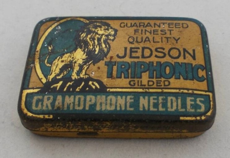

Patheno0 wrote: Fri Dec 06, 2024 5:53 pm Thanks I was a bit worried. Is it really true that you need to change the needle once per side of a record?
Here are some Jedson Triphonic needles. They are known as Spearpoint needles, and were marketed by several manufacturers.
They were said to vary the volume depending on the orientation of the needle in the chuck, and there is the usual reminder to use each needle once only. Good advice, but of course the manufacturers wanted their customers to buy as many needles as possible.

Re: Does my 1920s gramophone damage newer records?
Post by Patheno0 »
I have a few of those spear pointed needles, I was wondering what they were thanks.

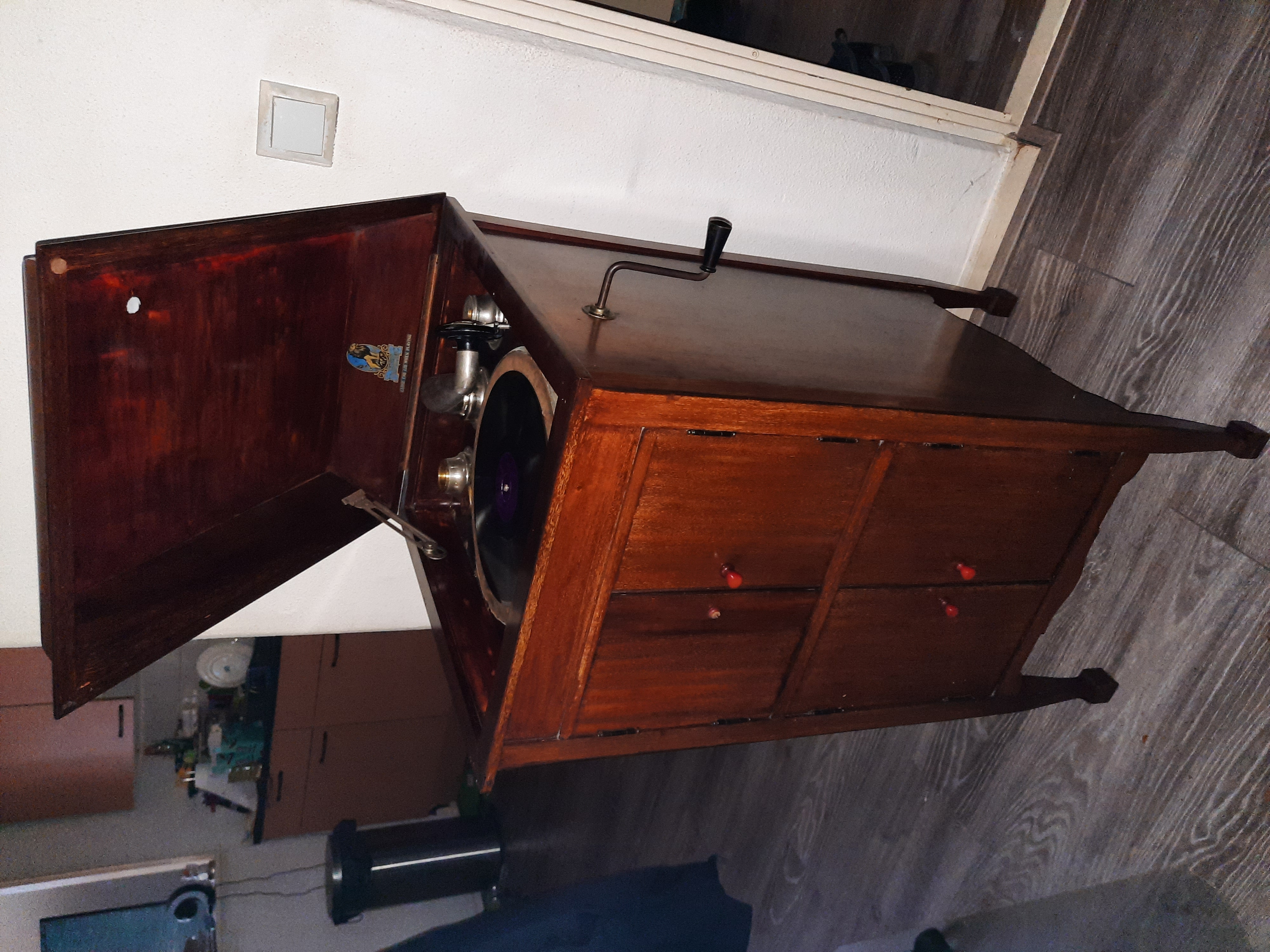

Here's my machine by the way, I hope you can find out something about it, I haven't been able to find anything online.

Your Reddit "Expert" was wrong on both counts. It is not a "Columbia knock-off" whatever that is supposed to mean, and you can play electrically recorded 78's on it. So much for the wisdom of soclal media.
Here is an old thread about Jedson. Unfortunately the accompanying pictures have long since disappeared.

Thank you, now I know a bit more about my machine, would love to know which year it was built but that's impossible to find.
