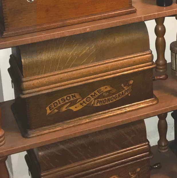

I've had a long case Edison Home phonograph for a while now, and every surface of the case & lid (aside from the face with the banner) had been stripped and refinished in polyurethane by a previous owner. The end result of this refinishing job, is that all the wood is noticeably lighter than the front, which was left original.
Now that I've stripped the polyurethane off, I'm left with the bare wood that has about 50% of the "green" color it should have. Does anyone have any tips for imitating this "green oak" look before applying a shellac finish?
I'm not sure what process the Edison factory used to achieve the green color, but my best guess is some water soluble dye wiped over the wood before finishing.

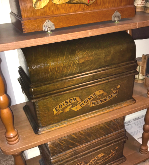

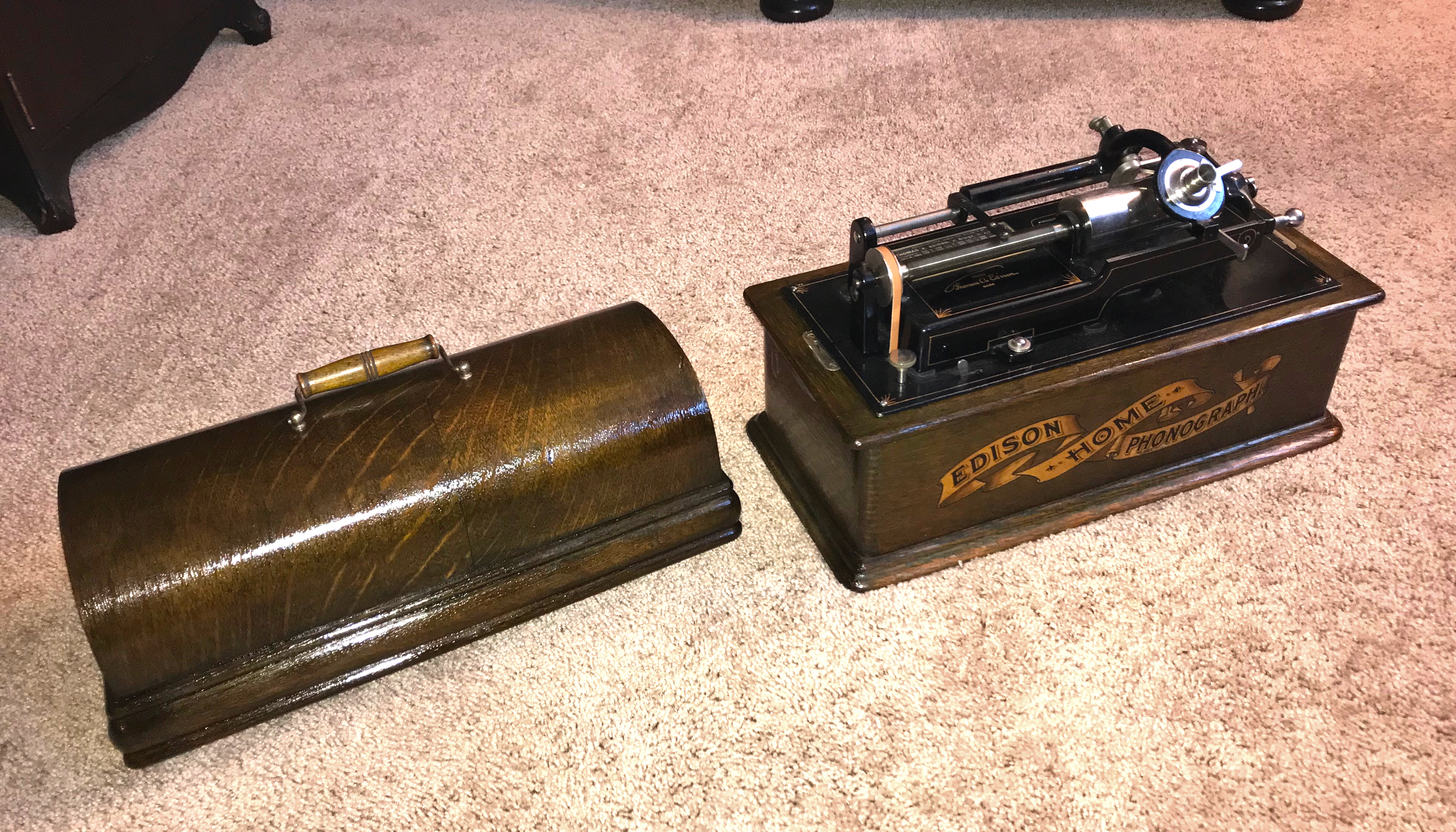

Finally got around to this project, and in my opinion, the results are satisfactory.
I ended up using two different water based stains/dyes for the color matching. The first being Minwax water based stain in walnut. While effective, it has a working time of less than two minutes, which took some time getting used to. The second being TransTint green dye. I thinned it with water, and applied numerous washes, letting the wood dry in between until the green began to show through. After everything was fully dry, I finished the case and lid with amber shellac.
Before: After: If I had to do this over, I wouldn't go with the Minwax water based stuff. The working time is far too short, and unlike oil based stain, is prone to leaving blotchy patches if you're not careful.

A great job, it looks fantastic...!
How did you apply the amber shellac? Diluted? Several layers? With cotton pad, sprayed, paintbrush...?

Thanks!Inigo wrote: Tue Jan 07, 2025 1:14 am A great job, it looks fantastic...!
I used three coats of shellac thinned in a 2:1 ratio with denatured alcohol, and brushed it on with a synthetic artists brush.
Admittedly, the pores could probably stand to be filled better. I had Aquacoat pore filler on hand, but it had been sitting for over a year, which I thought was getting too close to its reported shelf life.
Might just bite the bullet and use it anyway down the road now that the wood is sealed.
