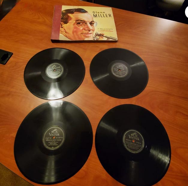

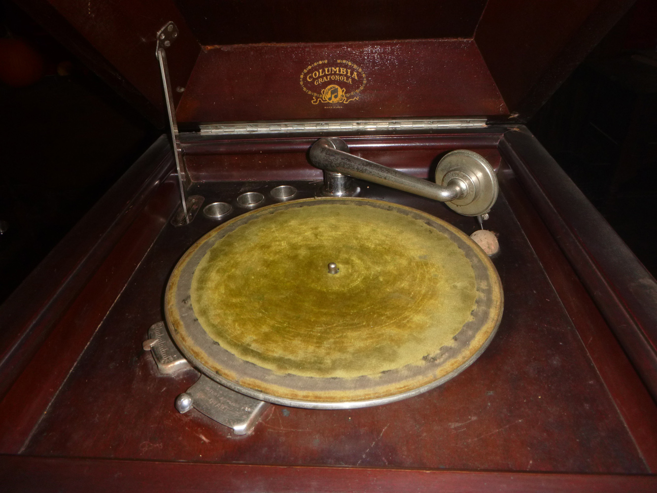

The Grafonola is going off to Vollema's shop for a tune-up and repair right after New Years so I bought my first 78 album. Went with a 1947 Glen Miller set that includes In the Mood, Stardust and some other good songs.
What type of needles would be best? Medium steel or the bamboo? This album was a bit pricey so I don't want to damage the records. Any good articles or tips on cleaning these without spending a fortune on devices? My impulse-buy phonograph is costing more than enough as it is.

Perhaps more important than the choice of needle is to take great care when turning the record pockets of the album. If a record slides too close to the spine there is a risk of nipping off the edge when the pocket is turned. The manufacturers were aware of this potential problem, and to prevent it some of the better quality albums had pockets with reinforced corners.

These records, if they are from 1947, are likely made from vinylite mixture, certainly not designed to be played with such a heavy tonearm. Steel will scratch the grooves, and bamboo will burn them.
My advice is, if you appreciate these records, don't play them except with a modern record player. The Grafonola is intended to play the harder records from 1900-1925, made of hard shellac mixture and with soft modulation in their grooves. Later records have to be played with care, probably better using fibre needles and a counterweight to leave away some of the heavy weight of tonearm and soundbox.

Oh $%^! The ebay description says it is shellac. I am very disappointed, I don't have a modern record player and don't plan to buy one. Guess I just wasted $65.
Thank you for telling me. I knew modern records couldn't be played but didn't realize these couldn't even play records 10-20 years newer than the machine.

Collectors have different opinions/preferences about this. Not meaning to contradict Inigo's viewpoint at all, but personally, with a nicely rebuilt soundbox and a freely moving tonearm, I wouldn't worry. The records may degrade very slowly over time if you play them a lot, but they aren't rare.

Orchorsol wrote: Fri Dec 20, 2024 10:31 am Collectors have different opinions/preferences about this. Not meaning to contradict Inigo's viewpoint at all, but personally, with a nicely rebuilt soundbox and a freely moving tonearm, I wouldn't worry. The records may degrade very slowly over time if you play them a lot, but they aren't rare.
Good to hear. I messaged the seller, he is throwing in a couple of more Glen Miller records and if I can play them occasionally it is a fair deal. Realistically this machine will be a conversation piece for the guest room/parlor and only played on the rare occasion that I have house guests.
I am also looking at 1920's dance tunes (fortunately there are uploads of every song on youtube!). They are rated "good" not "very good" but when records are over 100 years old I would think that is pretty typical?

V (= VG) is supposed to be a typical condition 78 with wear from playing and/or handling. G+ and G are on the rough side of that - despite the linguistic meaning of "very" and "good"!
Different sellers grade variably. It's a good idea to look through some of their feedback where you might see something like "fairly graded" or better or worse.

Those Millers will play fine on your Grafonola with a serviced reproducer and soft tone needles.
