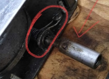

While it's finally working, what I find it weird is that when I unwind the crank handle anti-clock wise trying to remove the handle from the motor, it will also turn the shaft backwards. I think this may be why the spring was unhooked when the seller tried to remove the handle for shipping. I read that it may be issues with the non-returning spring but I am not sure how to resolve it. Have attached a video of it. Would appreciate it if you could share your view on how to fix that.

Can you see the coiled wire spring wrapped around the winding axis and attached to the motor plate with a screw?
That is a retainer that is not working properly, just seems to have been forced out of shape. It should be tight around the winding shaft. It is a simple device (which must be also free of oil or grease) which due to the direction of the coils, when the crank is turned to wind up, the shaft tends to open the coils and the spring allows the rotation of the shaft inside. When the crank is turned the opposite, the shaft rotates in the direction of the coils, and the wire spring tends to press tight around the shaft and so it blocks the rotation and the crank is unscrewed.
You'd need to disassemble it, clean spring and shaft from oil or grease, and try to make it into shape, or replace it. Place an add in the trader section to find who can supply this part, likely from the UK. Member soundgen, from near London, may have a fresh replacement, or others if you're in other part of England or Europe.
It seems a common failure in many motors of this type, as we've seen other threads in the forum with similar problems.

What is the white stuff I see between the crank and the winding shaft? If it's some kind of thread locker, glue, etc., it needs to go. Just about any non-return spring will slip, or break, if removing the crank requires too much torque. It almost appears to have been installed backwards. These springs can be problematic and "fiddley".
If you can, show more detail of the non-return spring itself. Your video jumps around and only shows the spring action for a split second. Don't bother showing the reversing gears.

The retaining spring is clearly out of shape and doesn't wrap properly tight around the winding shaft...

Inigo wrote: Fri Jan 10, 2025 12:00 pm The retaining spring is clearly out of shape and doesn't wrap properly tight around the winding shaft...
No disagreement there, Inigo.

Thanks for your reply and pointing out that the non-return spring may be faulty. I had a more closer look at the non-return spring and noted that the screw holding it seemed a bit loose. I have screwed it tight and it seems to work better. Now at least when the spring is fully unwound, I can somehow turn the handle anti-clockwise and while it will still go reverse a bit, the handled can be loosen and removed. So the non-return spring still works despite not perfectly. I cant remove the handle when the spring is wound up, and turning the handle anti-clockwise at this point in time will be unwinding the spring. As it somehow works, and I do not have access to experienced gramophone repair expert near me, I think it's best to leave it as it is now. The wood structure/cabinet of gramophone has been badly damaged by delivery and while I had made some simple temporary repairs to hold the structure in place, the gramophone is sadly no longer portable. So I guess it is not imminent to get the non-return repair now when the gramophone will act more as table top model.
