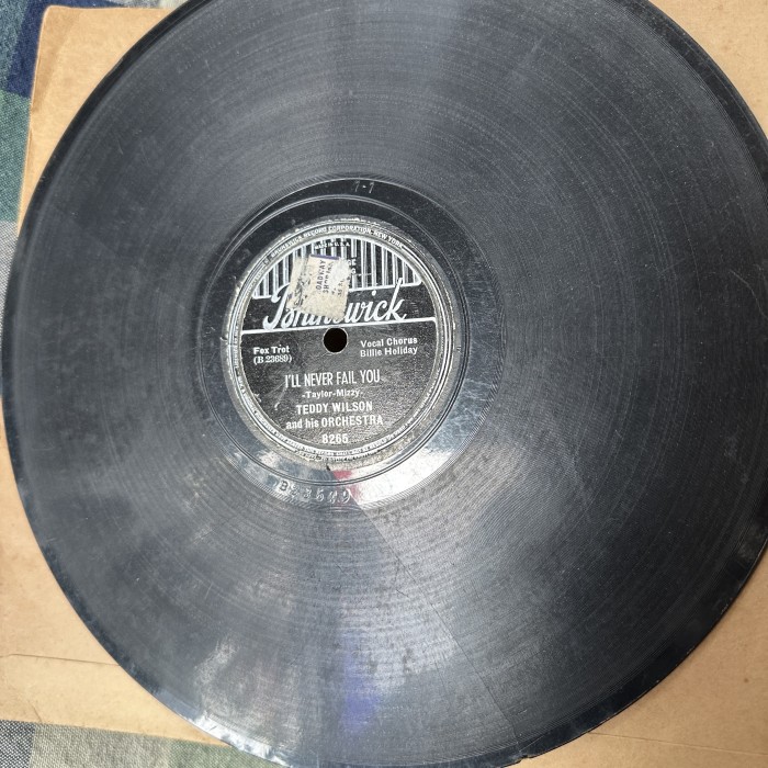

My joy quickly turned to dismay as I pulled the disc out of the sleeve and was immediately greeted by a crack running along the diameter of the record.
I didn't mind the sticker remnants on the label, those often soften and slide right off with warm water but cracks are usually a no-go for me. I did find an Ink Spots blue Decca that I didn't have and so I picked both records out and walked throughout the store. I figured, if nothing else, for .50c the Holiday needed rescuing. My plan was to attempt to clean it absolutely as carefully as I could when I got home and see if anything was salvageable.

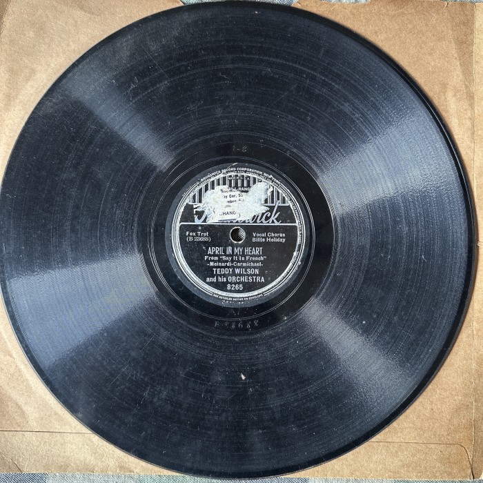

Much to my surprise, the crack is only visible on one side. Has this ever happened to you before? When I saw the crack on the B side it never even occurred to me to turn the disc over:
You better believe I handled this with kit gloves whilst cleaning. I did not want to make a crack appear on the other side. I removed the stickers on both sides, dried the disc and gave it a spin on my 8-30X. I was shocked that there wasn't even a tick from the needle.

It's a lam crack, and if it does not sound it likely will not get worse. That era Brunswick is laminated like a Columbia.

It's a crack only in the outer fine mixture layer. As there are paper layers between these and the coarse mixture record inner body, the crack will not progress to the core {maybe) nor to the other side. If you have seen many red Columbias you maybe have seen the same case, if only at the record edge... It's an advantage of this type of record.
