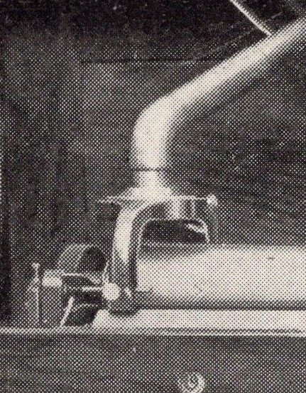

Why do you suppose they went to the Model D reproducer? The extra clearance was not needed for the same reason as for the Concert machine. Wouldn't a B or C work just as well?

That is an excellent question, Jerry! The short answer is, I haven't figured that out yet. The model B, C, and D were all introduced in 1902. And yes, a model B or C works just fine in the machine. The Bijou, the smaller Edison peer of the Excelsior used a Model B.
I originally thought it was a typo in the catalog (should have been "B" not "D"). However, I've seen multiple variations of different catalogs for the Excelsior. All state it came with a model D. And In fact, if you look at the close up picture in the catalog, you can see a tail weight, with a shallow angle - a Model D.
So there you go!
Shawn
So there you go!
Shawn

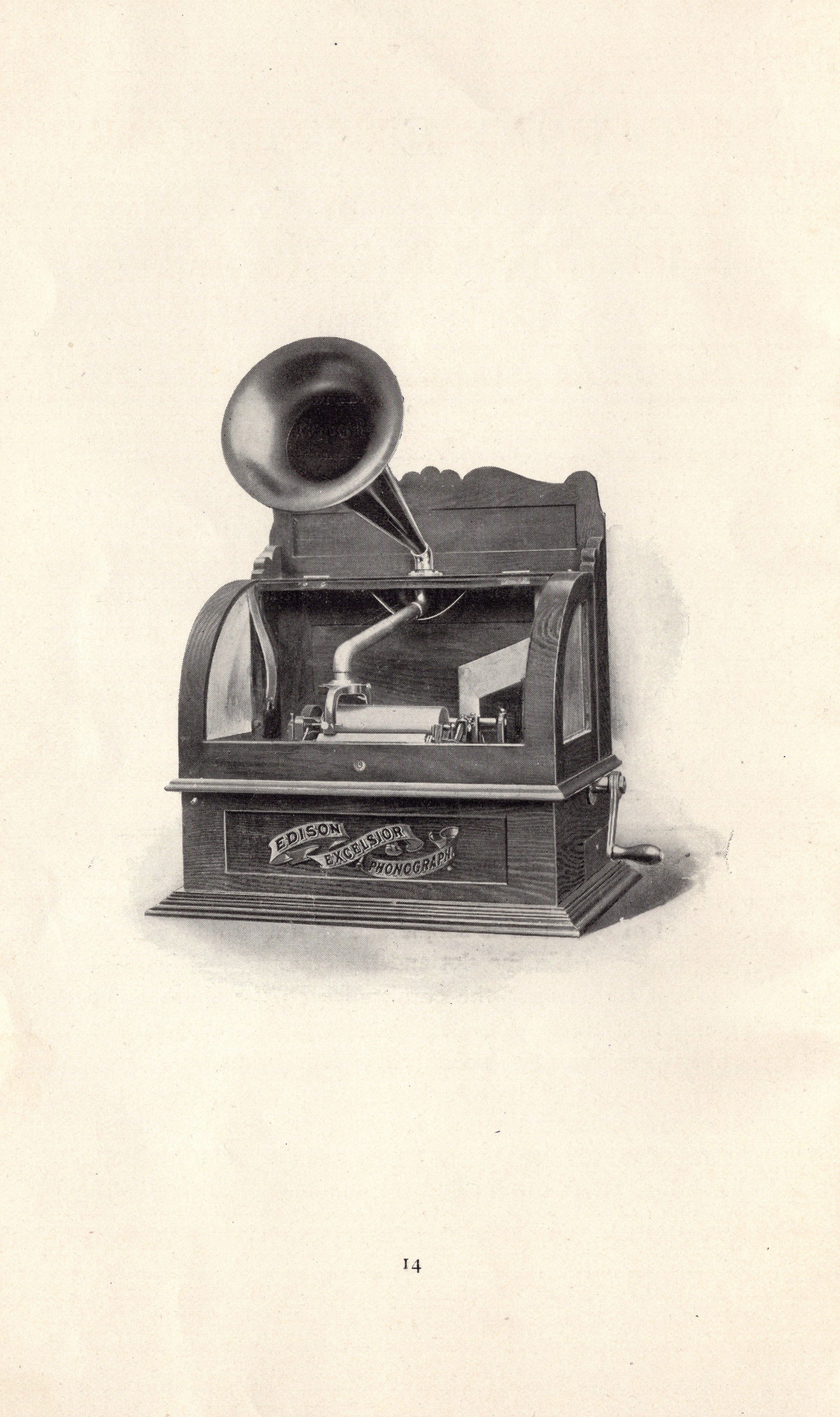

Shawn wrote: Fri Jan 10, 2025 10:31 am That is an excellent question, Jerry! The short answer is, I haven't figured that out yet. The model B, C, and D were all introduced in 1902. And yes, a model B or C works just fine in the machine. The Bijou, the smaller Edison peer of the Excelsior used a Model B.
So there you go!
Shawn
I should have known, the answer is, "You saw it in the catalog"!

Awesome!!! The ad looks like it came with a brass bell horn?
