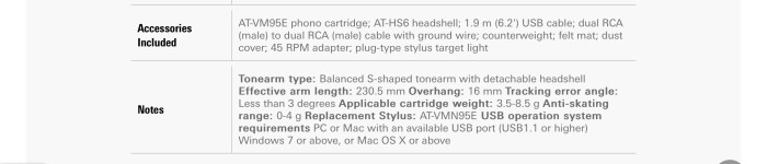

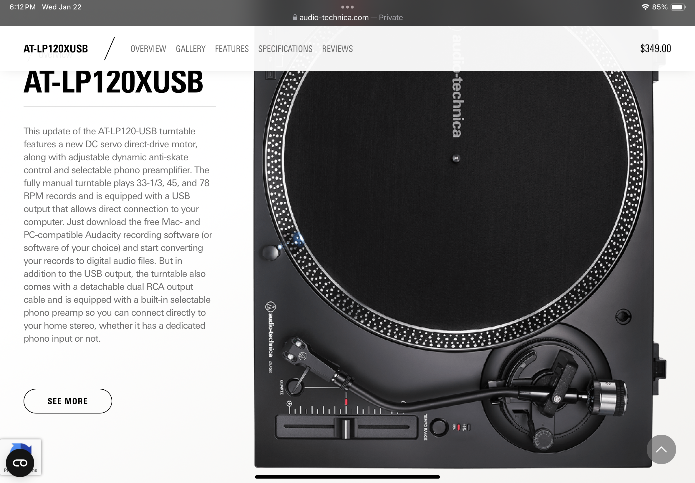

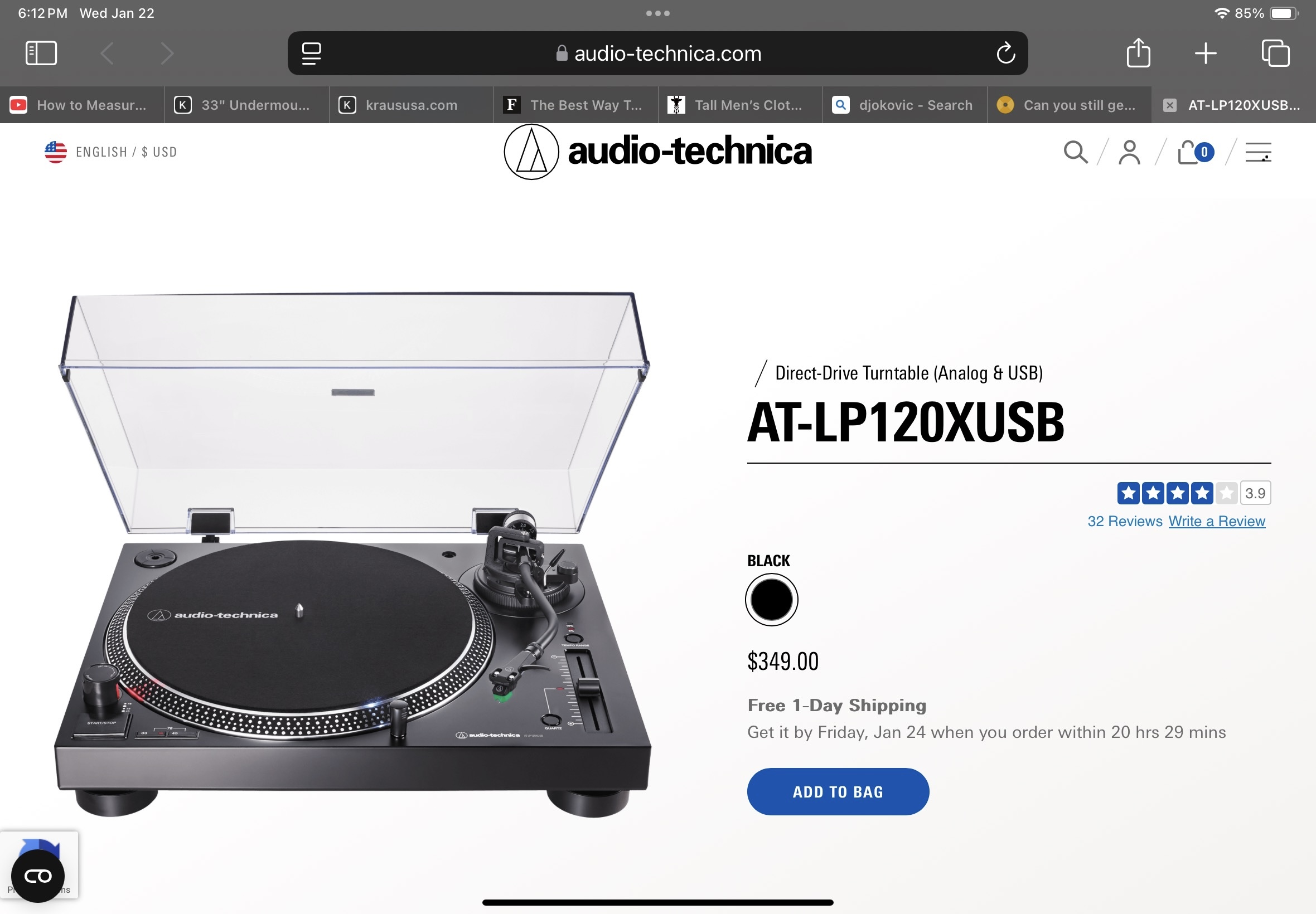

I do not want horrible sound. I am attaching information on my son’s turntable and cartridge.

You already bought a turntable of very reasonable quality, it's an excellent starting point. You won't get anything "better" than this in strict terms of sound quality out of a 78 RPM record. In the future, you might want to buy a more "phylological" turntable, or even try to play your records on a period gramophone, but that would preminently change the overall listening experience, not the quality in strict terms. However, I suggest that you begin listening with this setup for a while, until you get an idea of how much you are involved into listening to records as old as these.DRT wrote: Wed Jan 22, 2025 9:46 pm If I were to buy a turntable new, what would a recommendation be for a turntable and cartridge to get the best playback for these old records?
As I figured, what your setup is missing is a 78-specific stylus. Swapping styli is relatively easy, so in order to get going quickly I suggest you purchase this additional stylus:
https://www.lpgear.com/product/ATVMN95SP.html
Later, for convenience, you might want to buy a second shell and a second pick-up permanently set up with a 78 RPM stylus.
