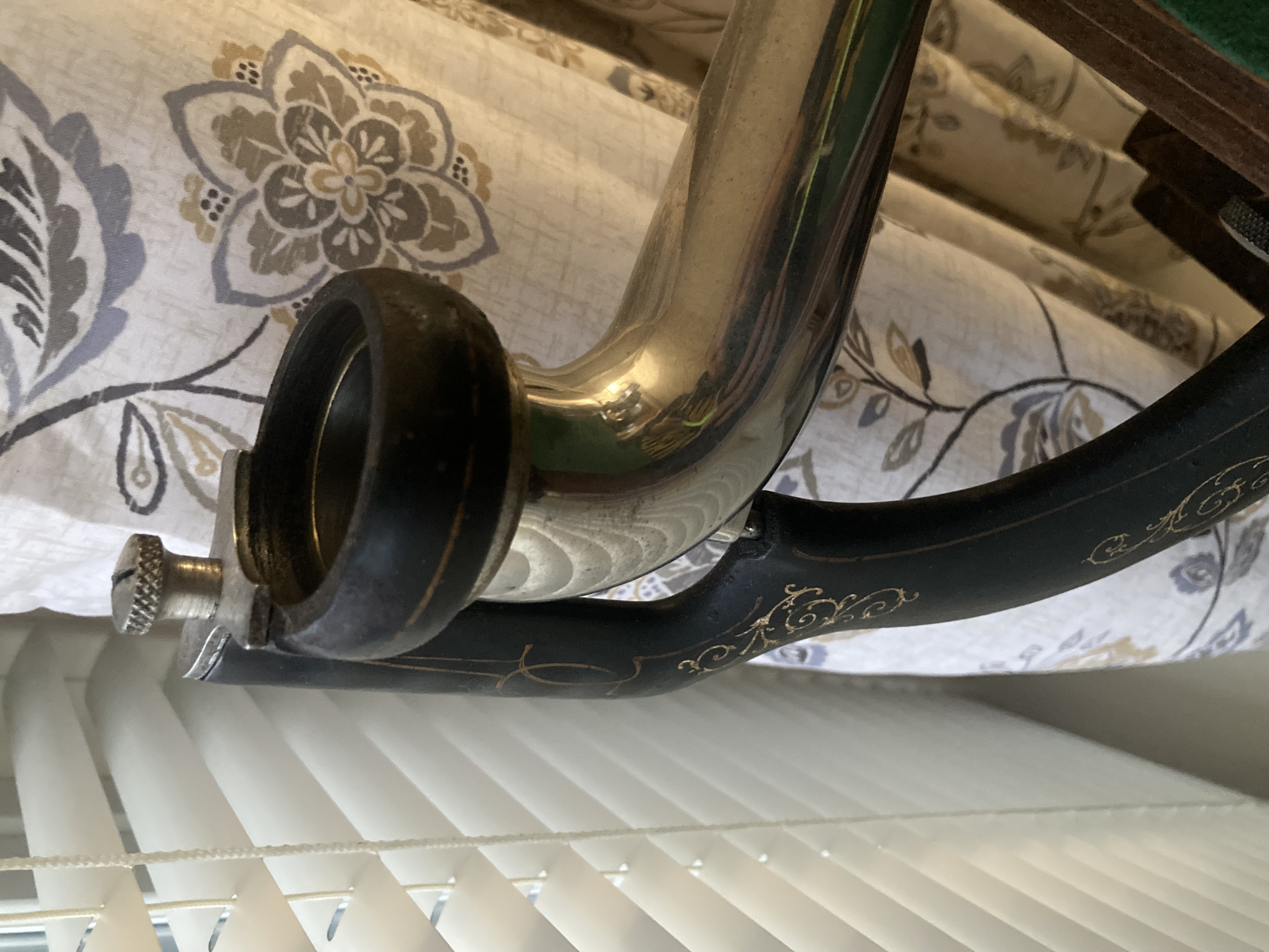

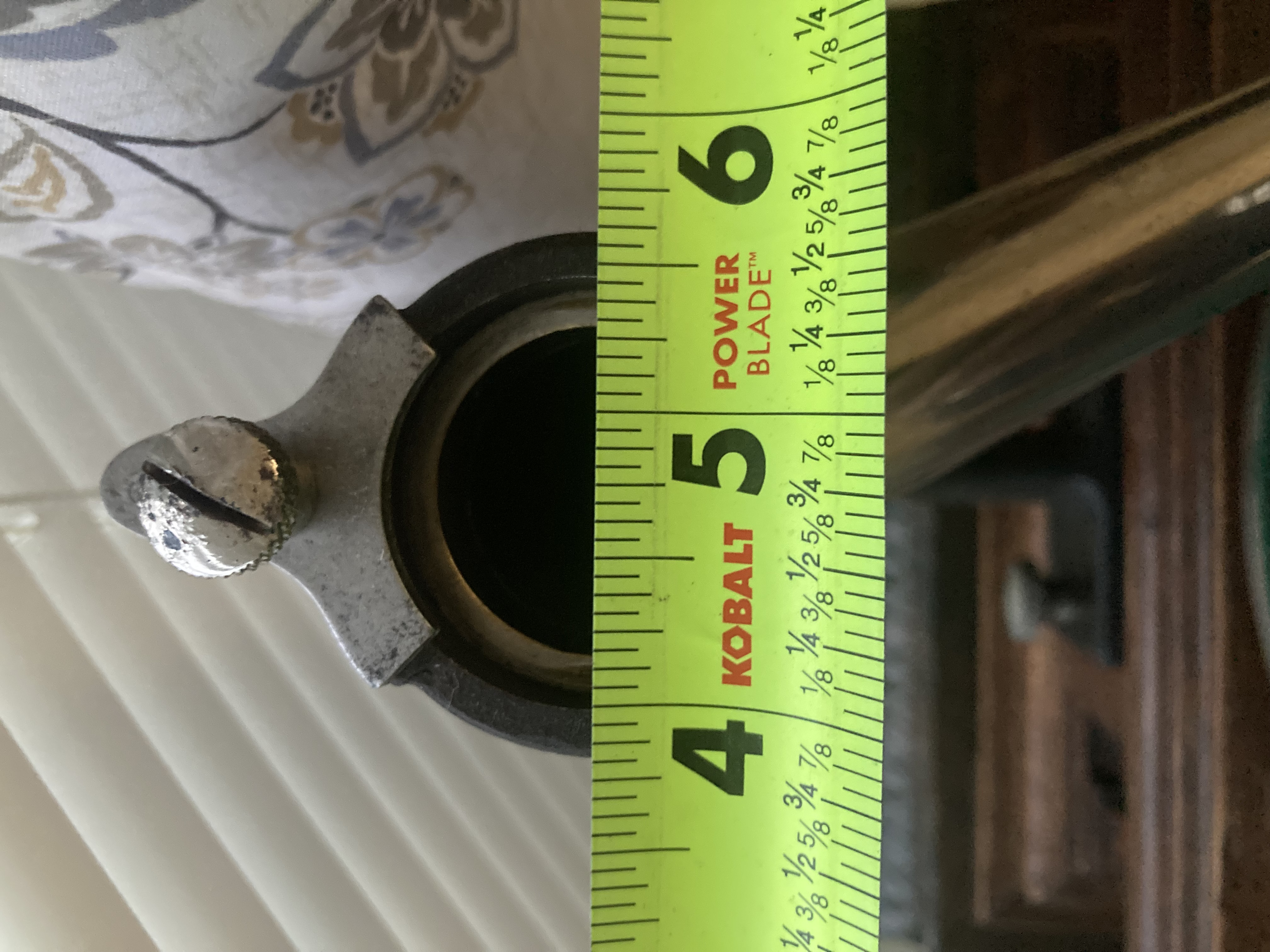

Re: Wanted: victor ii humpback elbow

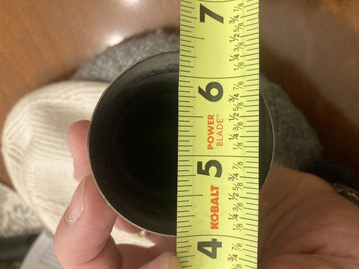

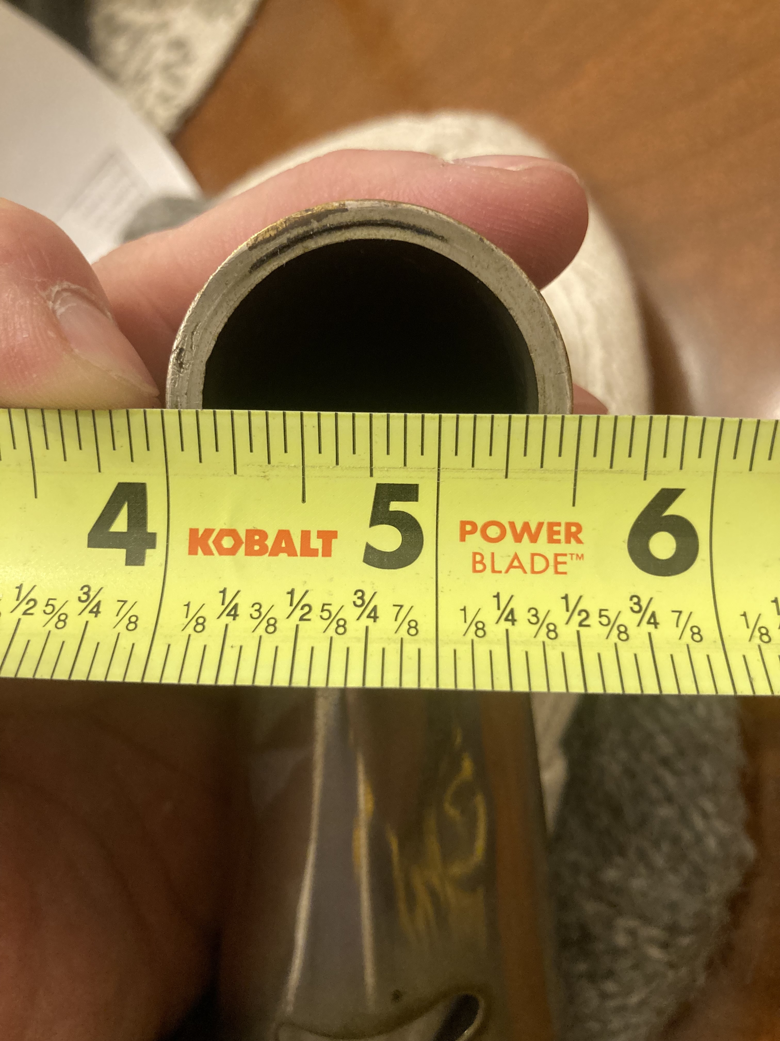

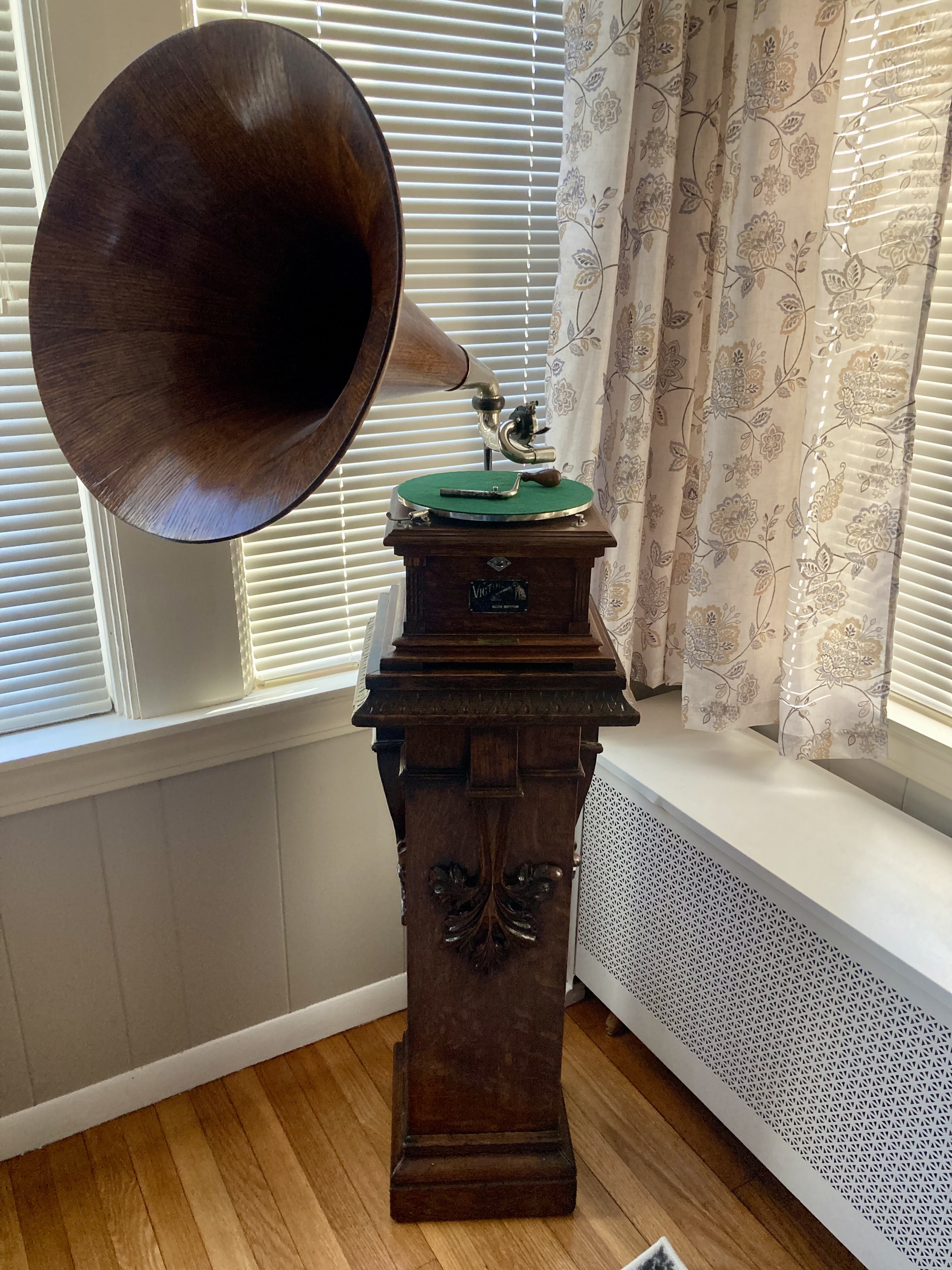

No problem. Looks like the horn base part that gets locked into the “Y” clamp is about 1.5” and the part that locks into the horn cone itself is about 2 ⅜”. Best of luck finding what you need!! Mike
The photos should show oriented property when clicked on to enlarge.

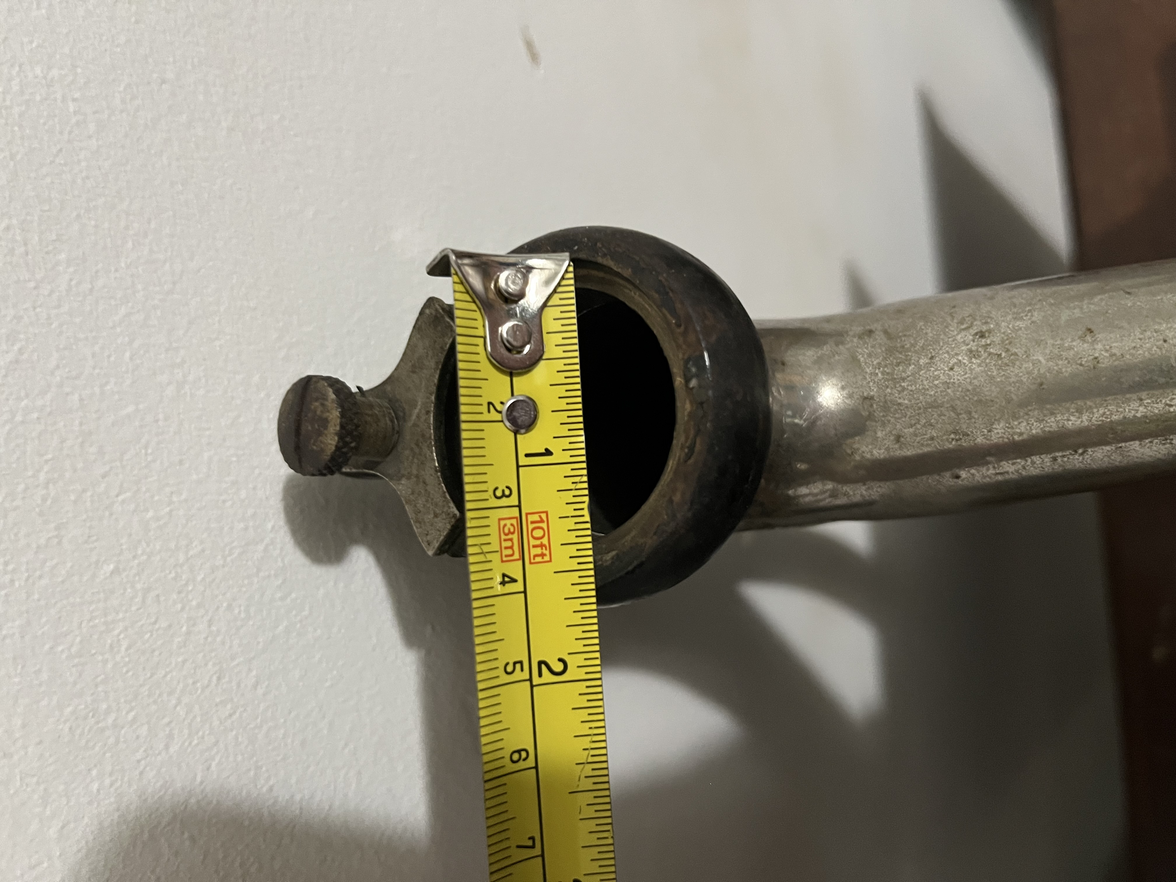

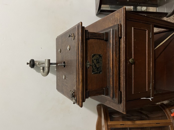

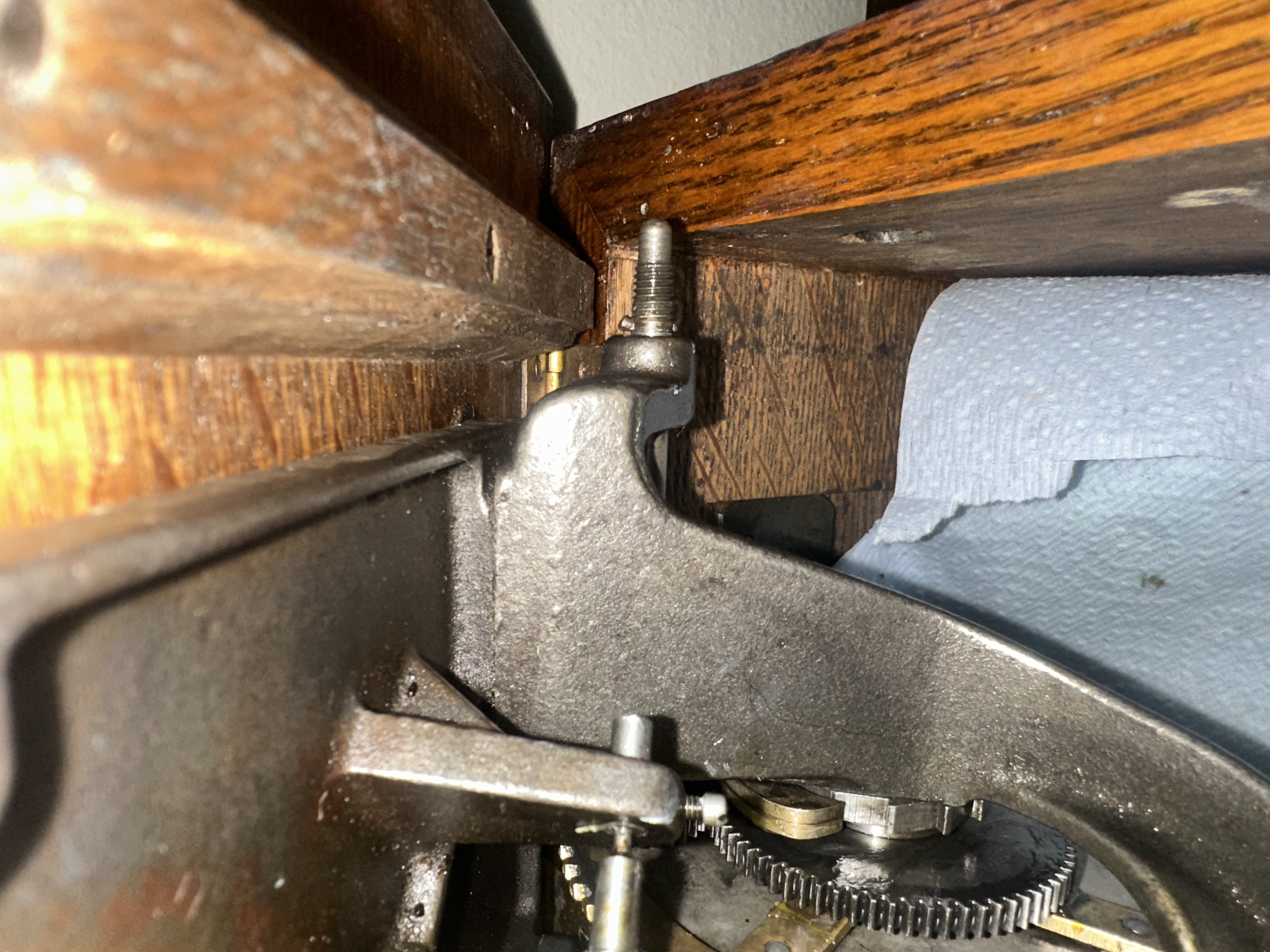

Thank you for the pictures of your machine. They are very helpful. As requested here is a picture of the winding shaft and i took a picture of the bracket opening for comparison aswell. Im also not sure the brake is correct either. But to be honest i do not play records on my machines. I do want them functional and as close to original as possible but the brake isn't a huge deal at the moment.
Thanks again to everyone

That winding shaft seems short…I’ll compare with mine when able. Doesn’t seem like enough “meat” for the female end to grab. I may be mistaken..
The brake is a match for what is on my example…

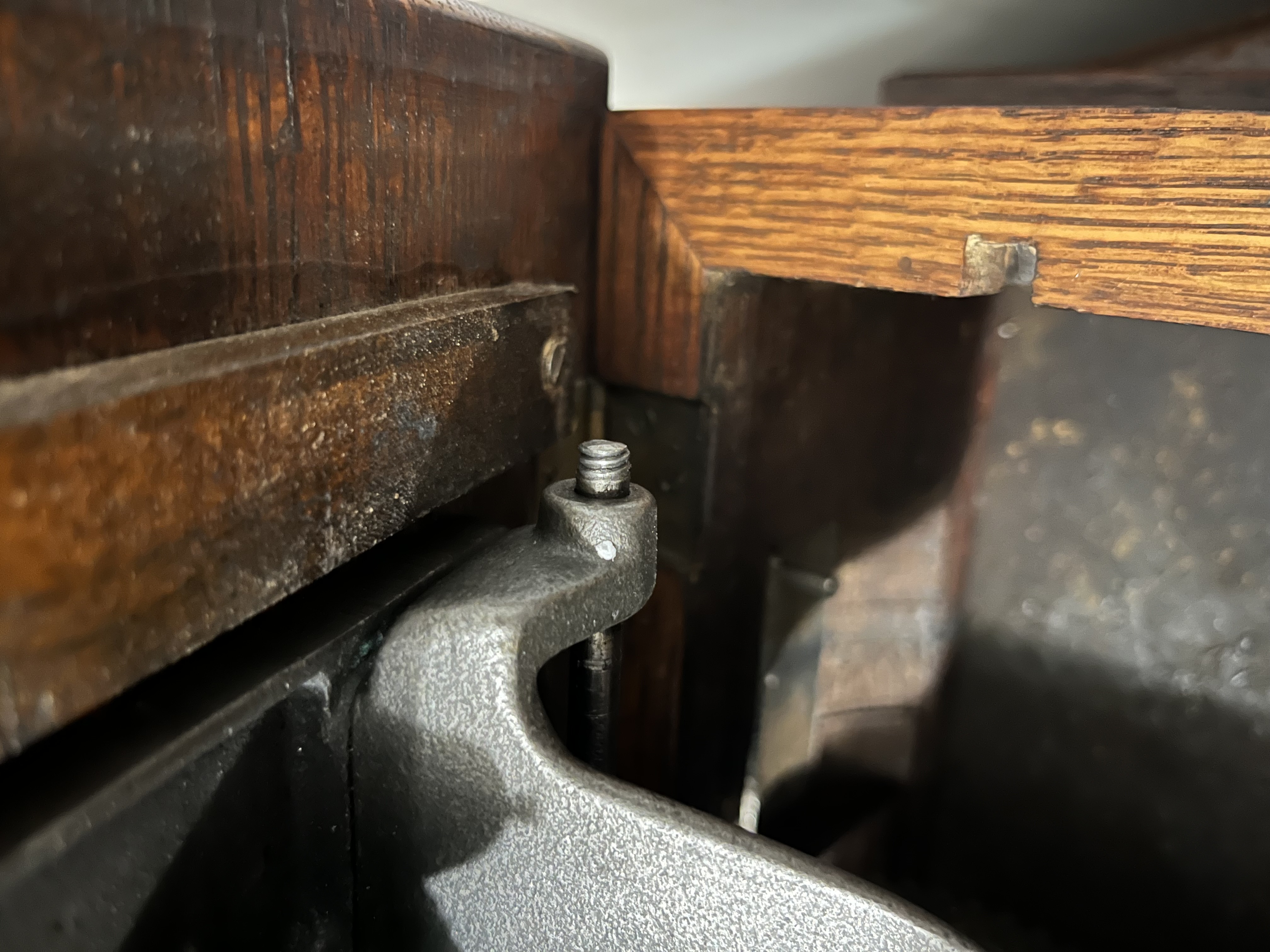

The Humpback II is one of my Victor favorite machines. The brake is correct for the machine. The winding shaft looks like it's been shortened. Here is a photo of the one on my Humpback II. Hopefully, someone will have a replacement winding shaft for you.Flying Dutchman wrote: Mon Feb 03, 2025 1:59 pm That winding shaft seems short…I’ll compare with mine when able. Doesn’t seem like enough “meat” for the female end to grab. I may be mistaken..

As the OP explained, it's been broken off.Flying Dutchman wrote: Mon Feb 03, 2025 1:59 pm That winding shaft seems short…I’ll compare with mine when able. Doesn’t seem like enough “meat” for the female end to grab. I may be mistaken..

The winding shaft should be 3-¾" overall length. The notch cut in the edge of the cabinet should not be there. BTW, is it possible that the broken off end is stuck in your crank?
If you can't find one, I can make a new shaft for you.
The funnny thing is, in checking this out for you, I realized that my Vic II has the wrong crank
. Can you post a pic of yours please?
