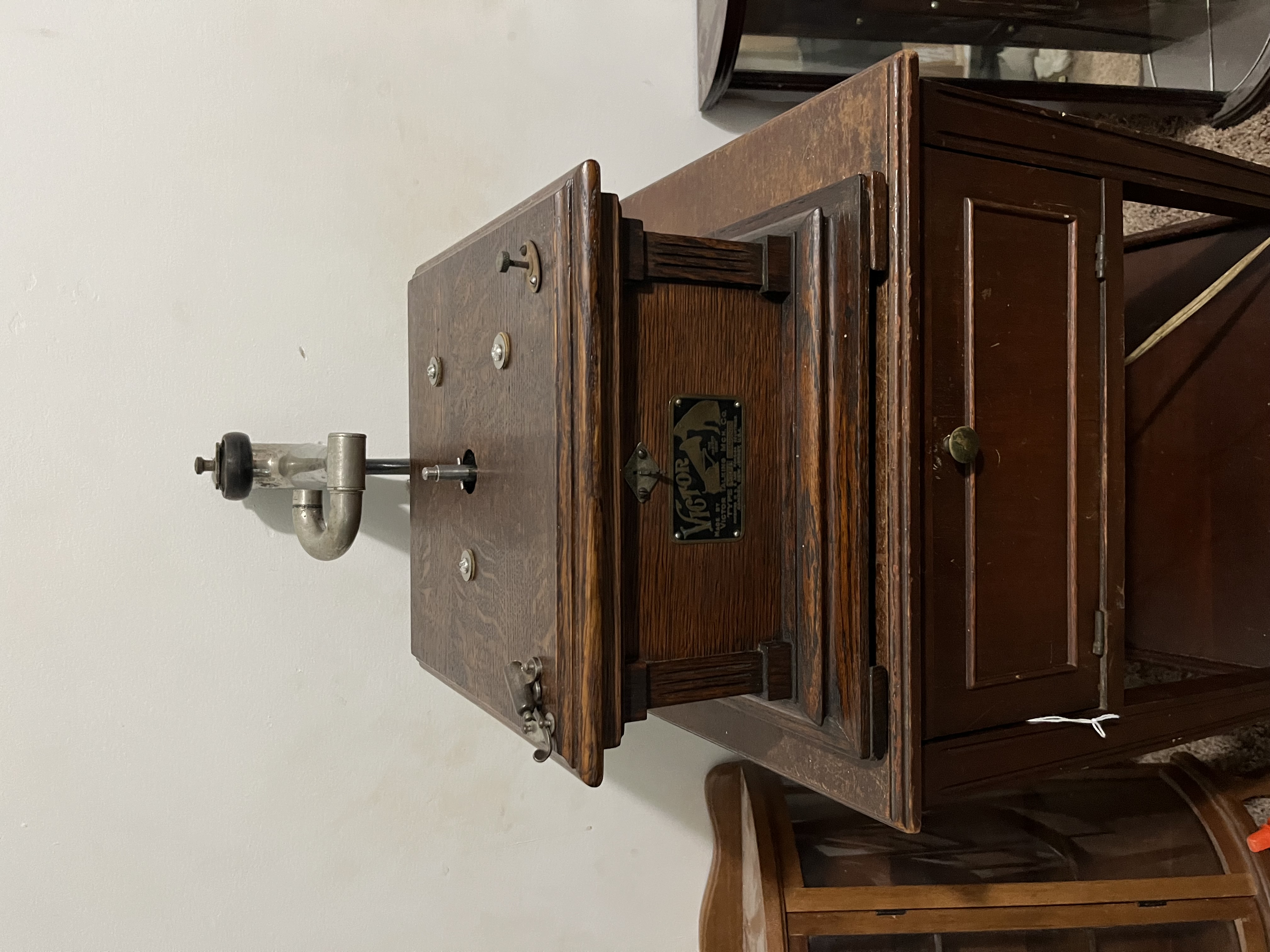

				No problem. Looks like the horn base part that gets locked into the “Y” clamp is about 1.5” and the part that locks into the horn cone itself is about 2 ⅜”. Best of luck finding what you need!! Mike
   The photos should show oriented property when clicked on to enlarge.
