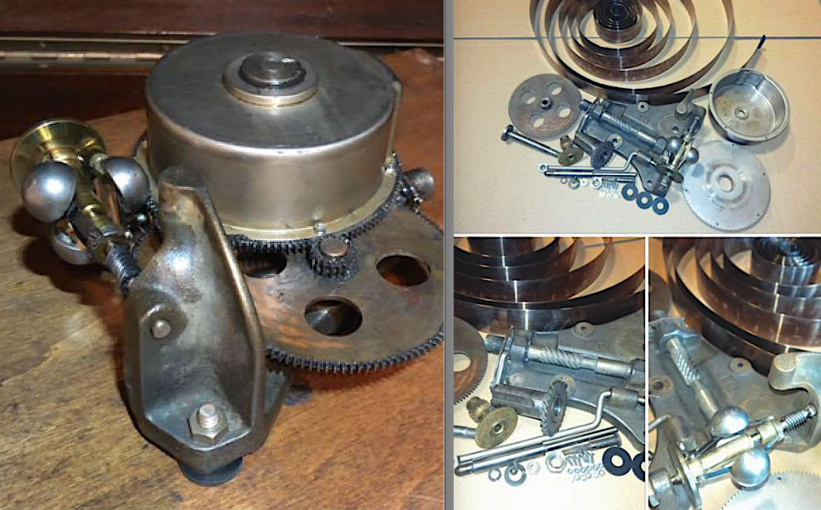

Maybe this seller has advise?
https://jp.mercari.com/item/m8012244683 ... 6SAnwRiatb
Here are photos of the motor from the above link ...
James.
James.

Thanks! I opened the machine with some help from my father and I see that the small cog in the center has worn down to where it no longer catches. Probably what is causing the problem!
