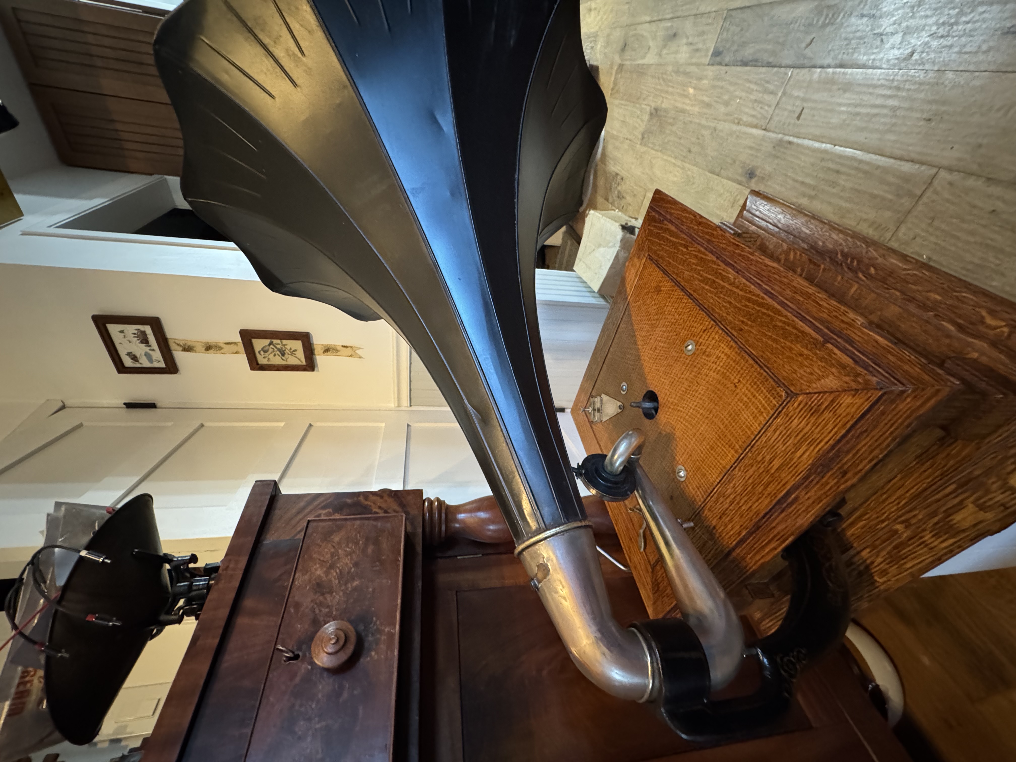

Hello - I know this had a previous discussion but no suitable solutions except using tape or a pipe spreader - so I am asking again. I have an oak horn which does not sag because it is lighter weight - I cannot get either elbow/coupling off either horn to swap. I am guessing I need to replace the elbow that is attached to the horn but any solutions other than that or using tape would be appreciated. I am going to try to find a couple o-rings and try that. TIA - Jim

My "opinion" only (I may be wrong), but your horn looks too big (long) for your machine and the weight is dragging it down... a shorter horn or a lighter weight horn would probably correct the problem. If you can't remove the elbow - buy a replacement... problem solved.

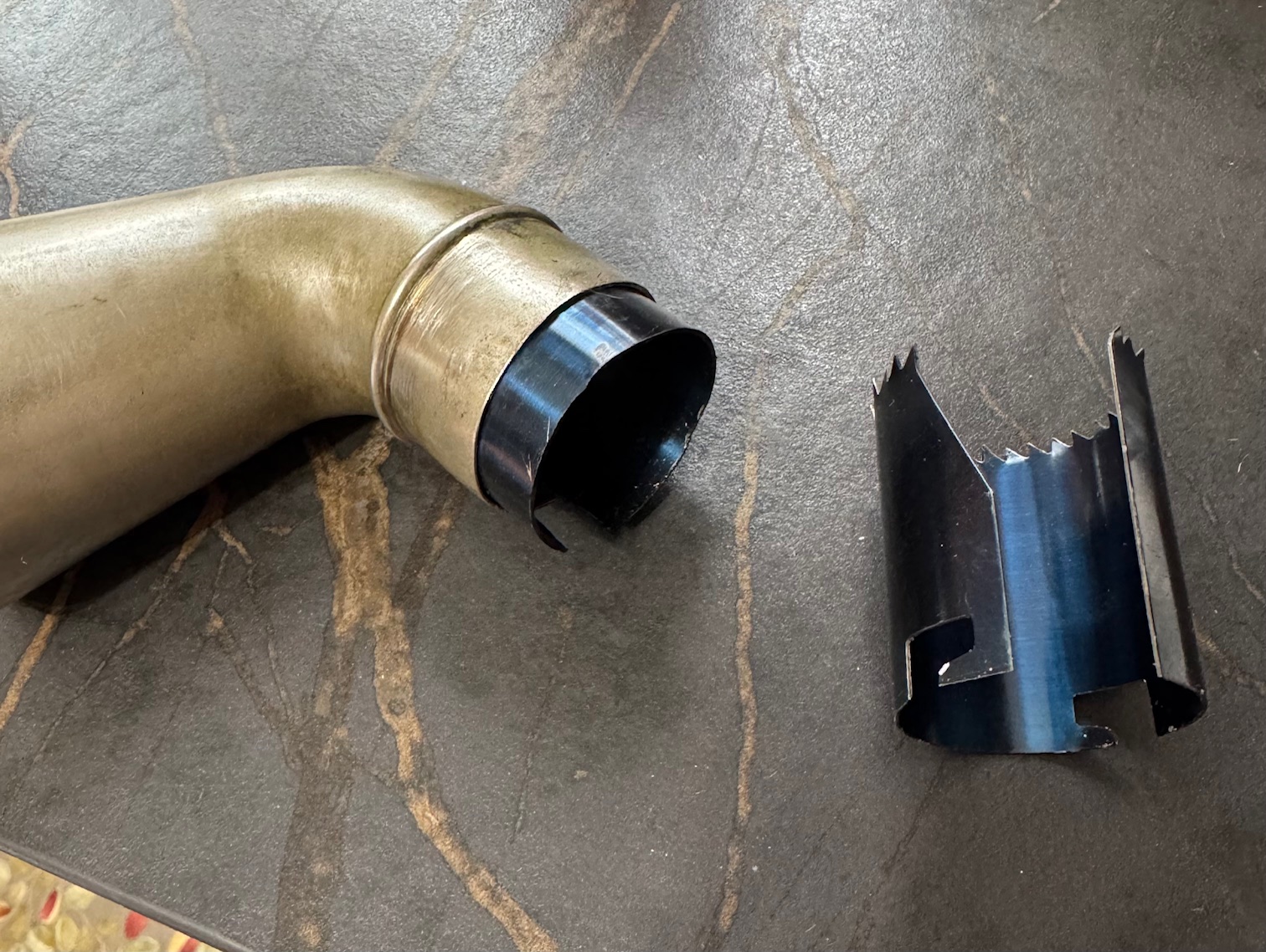

Hello - this is the same as cheapo harbor freight hole set except now it is Great Neck from Amazon - When I referred to the HF hole saws I don't think it was understood what I was thinking about. These are very thin and flexible and do not function well at all as a hole saw.
I cut a piece out of one of the thin hole saws to insert into the inside of the elbow after re-rounding it (the end of the elbow) the best I could - this is to make it structurally overall more substantial. It is much tighter now in the bottom of the arm bracket and will/should be less prone to bending. It is made to be pushed in flush with the end of the elbow - I pulled it out a bit to photograph it. It may not need to be shimmed.
Thanks Bob for your ideas which led to this possible solution - I have some thin governor spring steel pieces around I can fool with if I still need to shim. Best - Jim

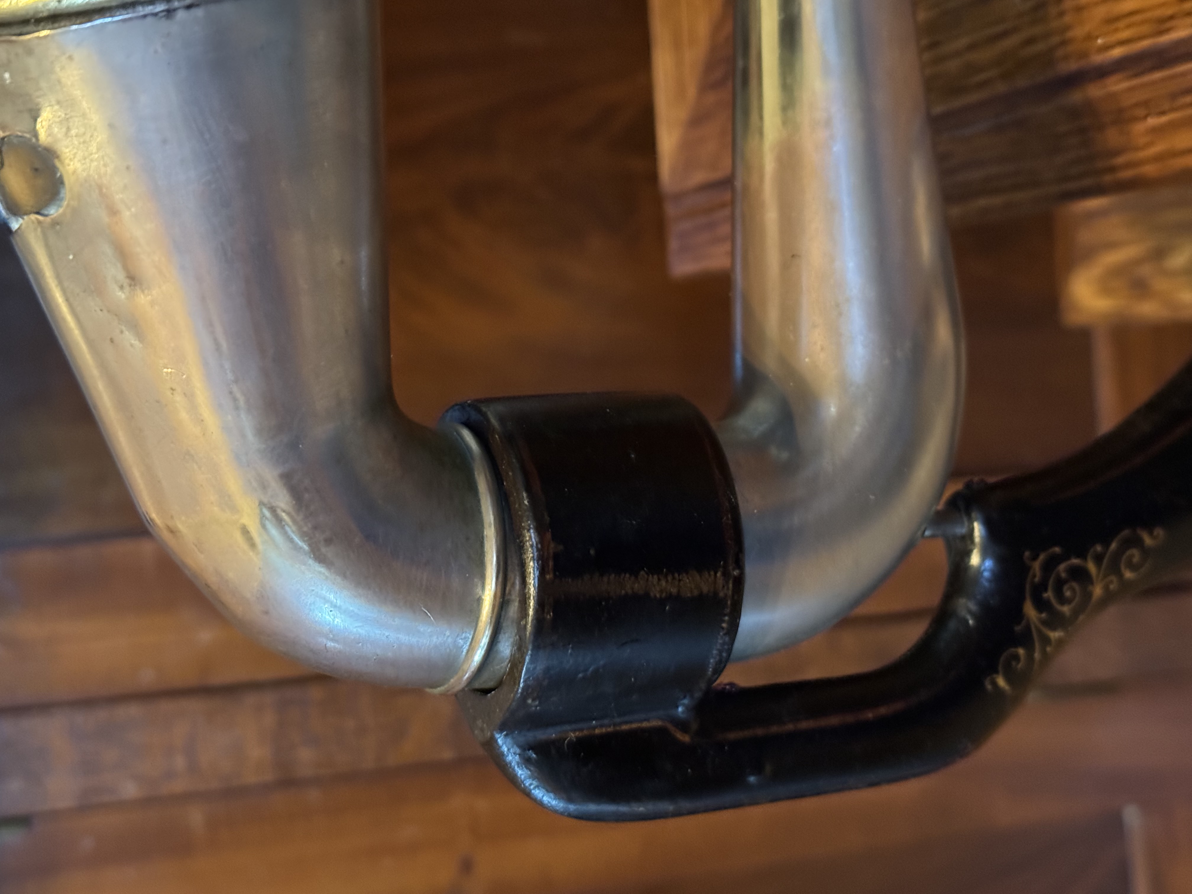

Jim,
You miss-understood my fit for your elbow.
What you need to do is use a small ½ inch to 1 inch piece if spring steel in the location indicated by the arrows when you press in your elbow.
You'll be amazed how well it works!
Bob S.
Bob S.
