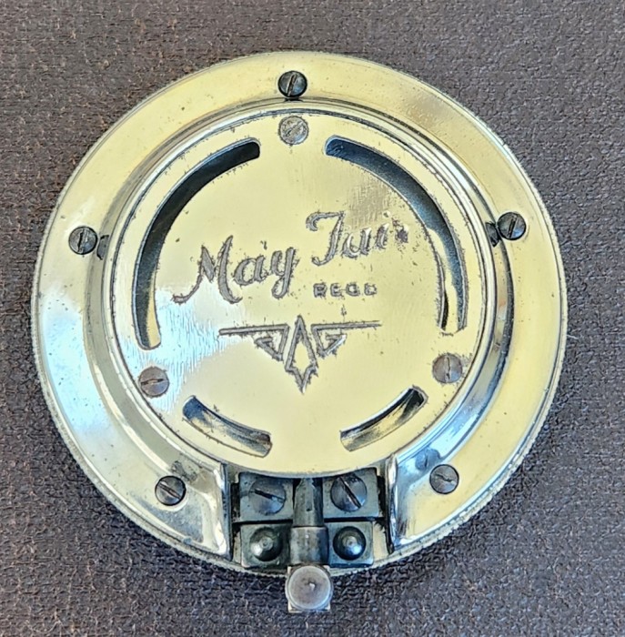

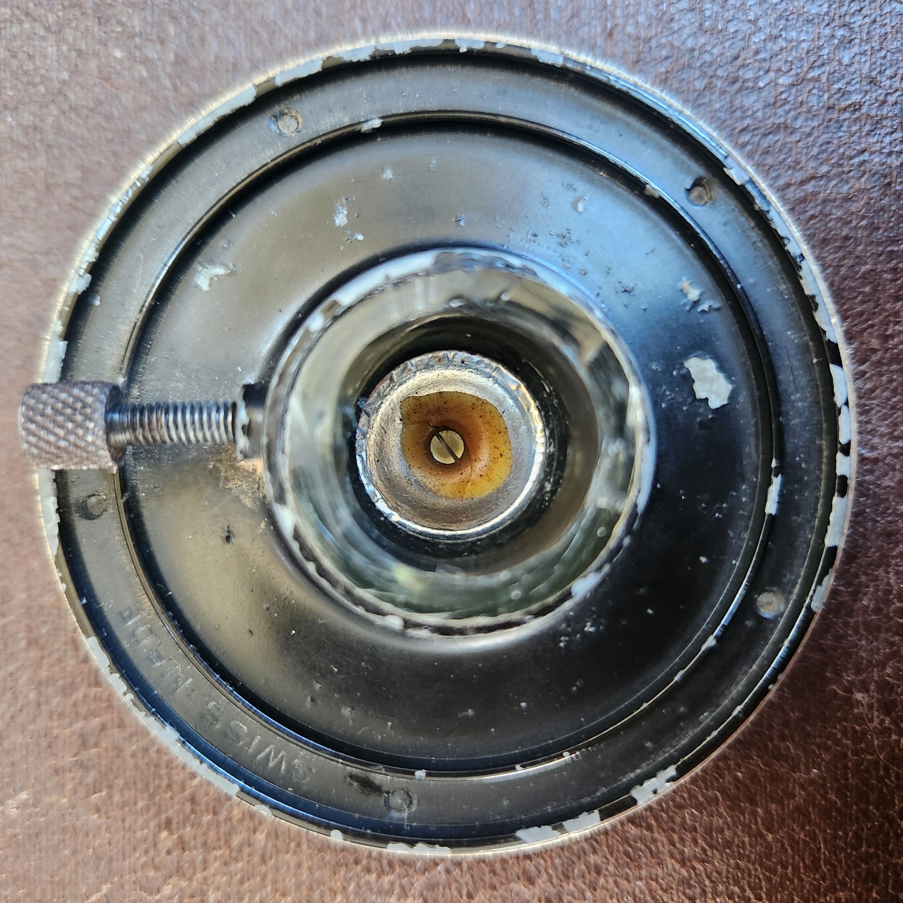

Post pictures of the reproducer. Front & back sides. We have no way of knowing if your reproducer is pot metal or not otherwise. Even if it is pot metal, it can still be rebuilt if the metal has not degraded.

Here's the reproducer. It is a May-Fair machine with a matching (i assume) reproducer.
Posts: 6631
Re: Slight buzzing from reproducer.
Okay, the reproducer is pot metal but it's very stable and should be safe to work on. However, if you have not done anything like this before, it may be best to send it out for a rebuild. The diaphragm is very thin aluminum and very delicate. Even to a trained hand it can be tricky to disassemble without damaging it. Old, dried gasket material tends to stick to the diaphragm and can tear it while separating the front and back of the reproducer.

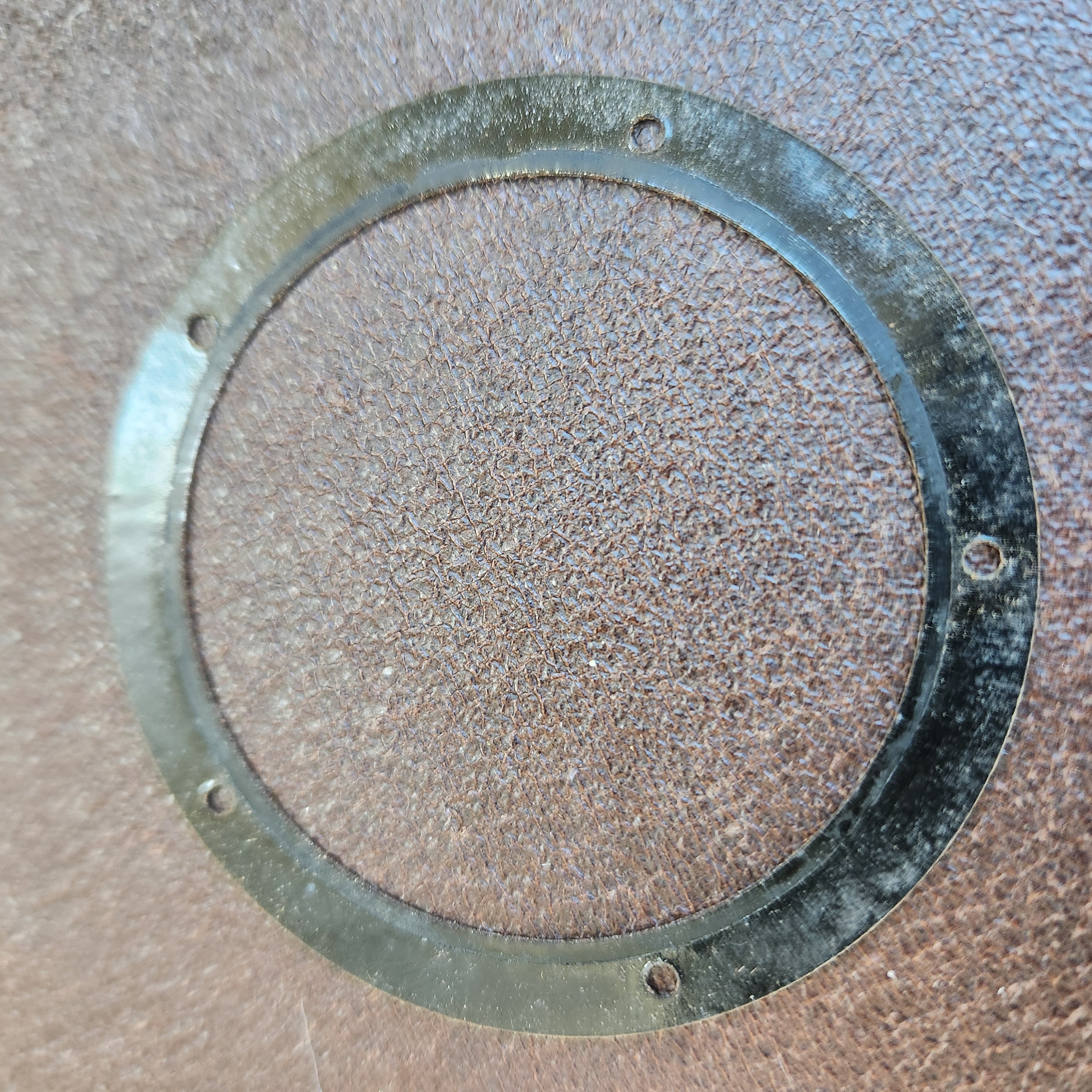

Probably against my better judgement, I tried to take it apart. and the back & front separated from the diaphragm, and i was able to get the gaskets separated from the diaphragm with no damage. Do you know what material it is/where I could get new ones from?

Great! Good for you! :)
Double check with the thickness of the old tubing, while taking into account that it's probably now crushed flat, with no spring-back.
https://thephonographshop.com/products/ ... 8-od-304pf
(I assume they're selling this by the foot.)
They also have it a little bit thicker, if needed. https://thephonographshop.com/products/ ... -foot-9030
Look very closely for any holes or rips in the diaphragm. Hold it up to the light and look for even the tiniest pinholes.
