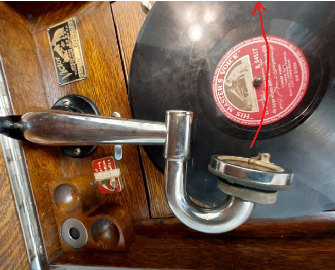

I recently purchased a Victrola VV-VIII (S/N 69632F)
Since I know very little about this machine, I was wondering if you might be able to share your wealth of knowledge with this "New (old) Guy"?

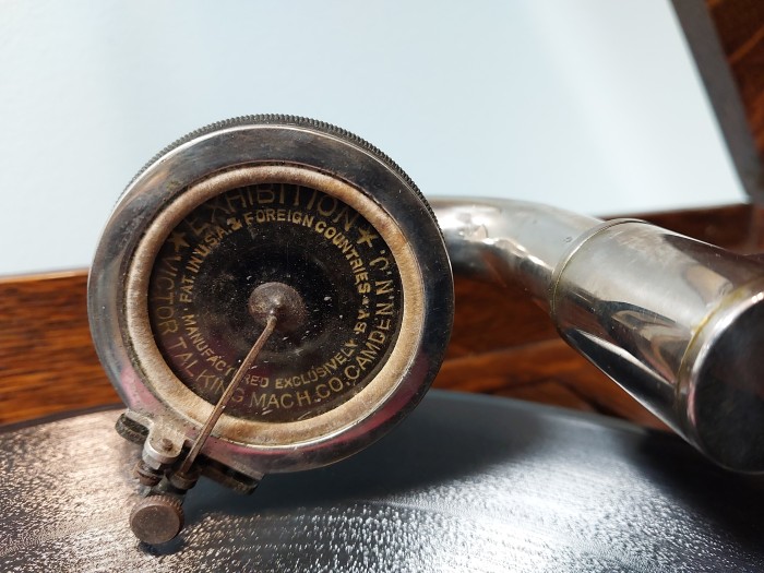

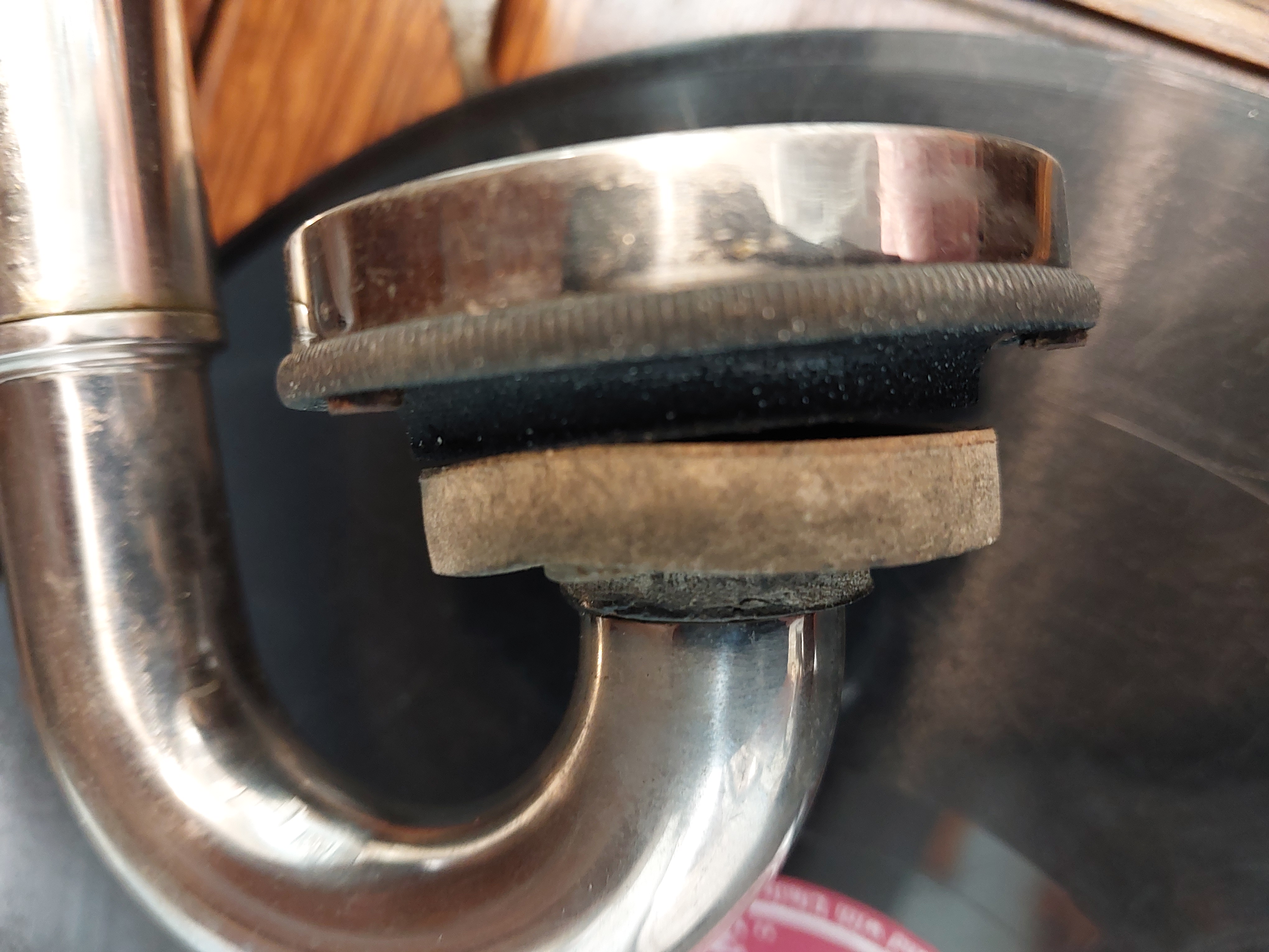

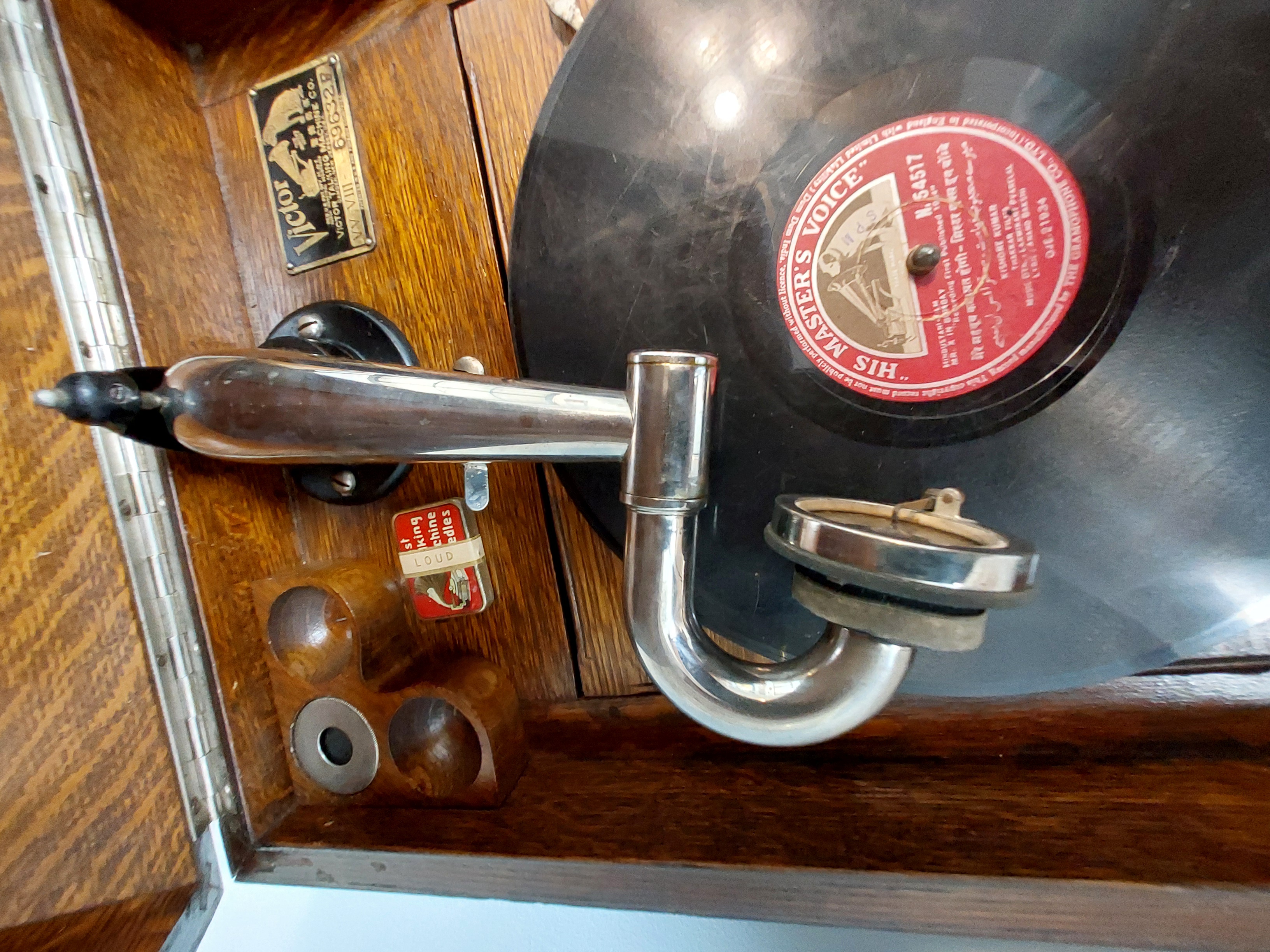

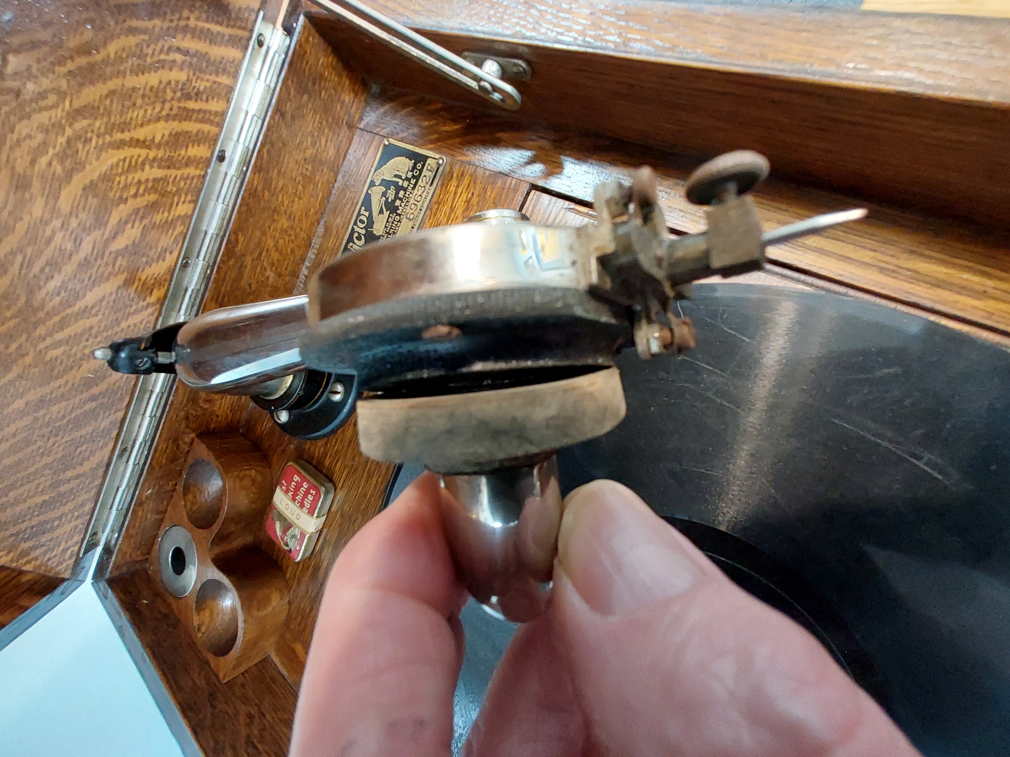

The unit cranks and plays. (But sound us barely audible). HOWEVER, the reproducer is loose and appears to be "warped" where it connects to the tone arm itself. (Please see photos) The (2) screws holding the reproducer onto the tone arm are tight. However, there is a gap between the reproducer and the tone arm. ANY help would be GREATLY appreciated!

The reproducer should be rebuilt with new rubber gaskets installed, then tuned. The hardened rubber piece on the back of the reproducer is called an isolator. It makes an airtight seal between the reproducer and arm and provides vibration absorption to prevent overtones. Both gasket material and the isolator are available from www.thephonographshop.com. Send them your old isolator as the brass ring inside of it will be recycled.

As John stated, the reproducer (or "sound box") definitely needs an overhaul, which isn't too difficult if you have steady hands, and the right size screwdrivers.
You can do it yourself, following these instructions -- https://www.nipperhead.com/old/reproducers.htm

You've been given some great advice here. I'll just add this, do NOT play the record with the reproducer positioned as you've shown. The needle/reproducer needs to be positioned to the right side of the record. I realize you may just have pictured it that way, but just in case...
