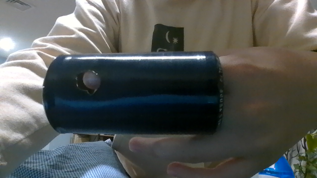

one time i had a very badly warped one ( got it free from a flea market) and thought that if i used a torch lighter and mildly warmed it up, i could mold it back into shape. it was going well until it wasn't. long story short there is a small hole within the warped section, but the end that wasn't warped plays very well

If I'm not mistaken, celluloid is highly flammable. Leaving aside the undesired results of this experiment, probably best not to expose it to open flame.

My immediate reaction:phonograph guy3435 wrote: Sun Mar 02, 2025 7:12 pm one time i had a very badly warped one ( got it free from a flea market) and thought that if i used a torch lighter and mildly warmed it up, i could mold it back into shape. it was going well until it wasn't. long story short there is a small hole within the warped section, but the end that wasn't warped plays very well
GAAAAAHH
There used to be a saying: to 'go up like a celluloid collar'. Just be glad the FD didn't have to show up.

welp, now i knowdrh wrote: Sun Mar 02, 2025 7:55 pm If I'm not mistaken, celluloid is highly flammable. Leaving aside the undesired results of this experiment, probably best not to expose it to open flame.

I tested this by removing the celluloid from two cracked BA's which had split the entire length of the grooves. Put the two celluloid sleeves inside each other, lit a match, and got a six-foot fireball that refused to go out until the whole thing was a tiny palmful of ashes.
You about had a very very bad day!

yeah i waved it around right after it started up so the flame kinda shot out of the end for a few seconds and it just made a lot of smoke.

finally, it contains an oxidizing agent which means you could throw it in water and it still wouldn't go out.
