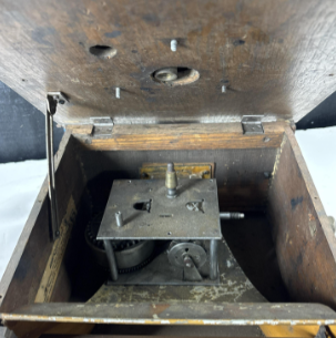

I've got a broken mainspring inside of my Grafonola 15 (single-barrel), the pear-shaped hole broke off (I had known that the mainspring was cracked on one side of the pear, I noticed when I first tore the machine down when I first got it to grease it).
I have removed the spring from the barrel and I got the broken end of the spring.
Mainspring is in a pear-pear configuration btw
Not my image, I got this one off an auction side from one in bad shape since my motor is disassembled, same motor nonetheless; You can't lay out the parts piece by piece, resistor by capacitor and expect to get an answer such as "Ah yes, that is a 1948 RCA Victor 65u"
Inside the 15 (not my image, but same motor).png (158.97 KiB) Viewed 942 times

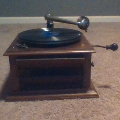

Blind-style horn door
Front (open).png (161.13 KiB) Viewed 942 times

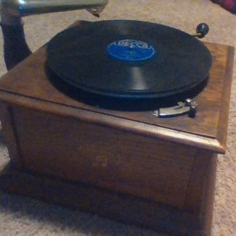

Direct photo of the left side
Left side.png (174.9 KiB) Viewed 942 times

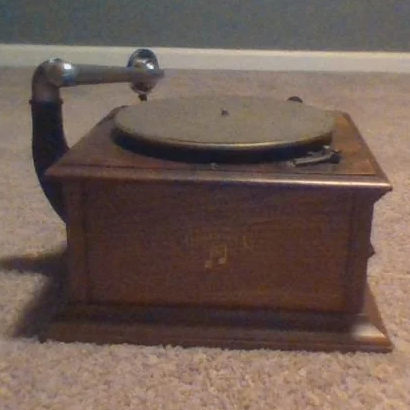

Left side at an angle
Left side electric boogaloo.png (250.87 KiB) Viewed 942 times

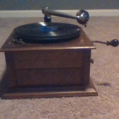

Front (closed).png (151.88 KiB) Viewed 942 times

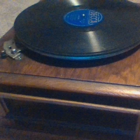

Grafonola up close.png (253.36 KiB) Viewed 942 times

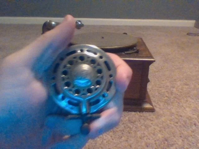

Reproducer (blurry).png (337.83 KiB) Viewed 942 times

Solder? NO.
Contact the phono shop and tell them what machine you have. They'll likely know what you need.
As to repairing the old one, yes, you can. You'll need to heat about 2" of the spring end with a propane torch. Get it red hot, then let it cool slowly. This will soften the hard spring steel*. With a tin snip, (or a grinder), trim the broken end of the spring. (Notice the rounded end of the original.) You'll need 2 drill bits, a large one, and a smaller one, to match the end diameters of the original pear shaped hole. Drill two holes in the spring end, spaced apart to match the original pear hole**, and located exactly along the centerline of the spring. With a small file, file away the material between the two holes, to connect them and to form the pear shape.
*It will soften the steel, but the steel will still be fairly tough. Use sharp, high quality drill bits.
**The original pear shape may be so short the holes will overlap. If that's true, then space the holes far enough apart so that doesn't happen. It makes drilling the second hole near impossible.
