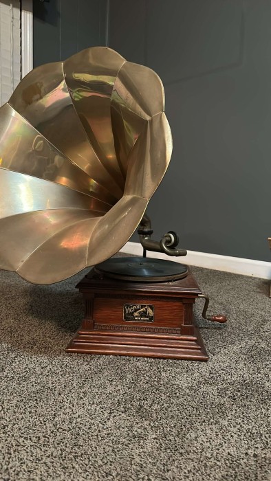

Questions about this Victor Monarch (or is it a Victor III?)
That's the first question: Which is it? I know some Victor III machines bore Monarch ID tags, but I can't tell if that's the case here or if this is just a Monarch. How can I tell? (The crank sure looks like a III...) Also: Doesn't this horn look like a 9-panel Columbia nickel-plated morning-glory? Did someone make these for Victor, too? If so, I've never seen one.
- Posts: 6831
Re: Questions about this Victor Monarch (or is it a Victor III?)
It's a Monarch, or M. The fancy trim piece above the base molding is telltale. The crank is wrong for this machine.

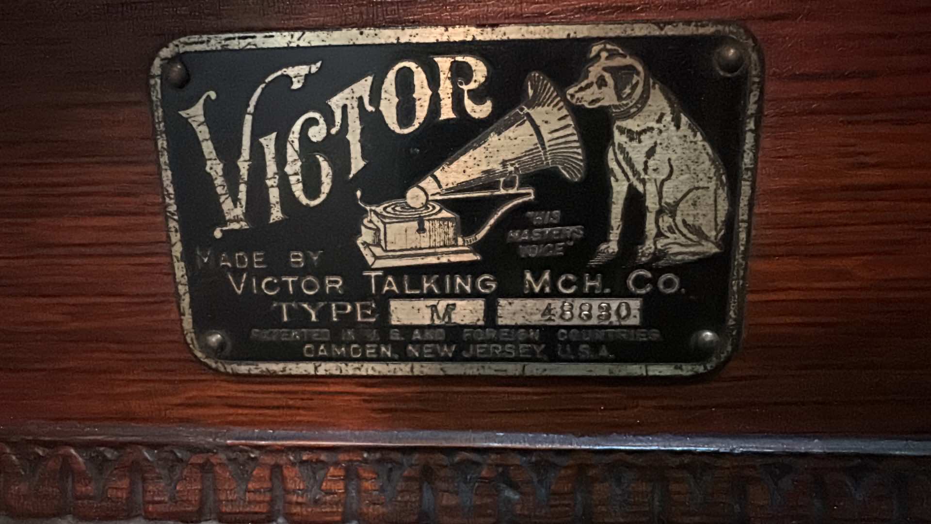

I identify a Victor by the information on the ID tag assuming the tag has been on the cabinet since leaving the factory. Your machine looks like a very attractive Victor M and the ID tag confirms this to be true. Confusion comes from catalogs offering the complete lineup of models. The page showing the likeness of the Victor M says Victor III. (I don't have a copy of the catalog so it may say Victor the Third or Victor 3 or Victor III.)
Victor R was the price leader or Victor 1 (or I or the first)
Victor E was slightly more expensive and a Victor 2 (or II or 2 or the second)
Victor M was slightly more expensive and a Victor 3 (or III or 3 or the third)
Victor MS was slightly more expensive and a Victor 4 (or IV or 4 or the fourth)
Victor D was slightly more expensive and a Victor 5 (or V or 5 or the fifth)
When the excellent "The Victor Data Book" was written the known information (or lack of) was combined for each machine position in the Victor machine lineup. So information about the Victor M was added together with the Victor 3 which became the Victor III. I can be a bit confusing. So is a Victor M the same as a Victot III? You can argue a position of yes, no, maybe because they shared some common parts.
Aftermarket, nine-petal, nickel-plated horns made to fit Victors were manufactured. I have one also. Just make sure the horn pictured is unmolested, and not a "modified" Columbia horn before buying.

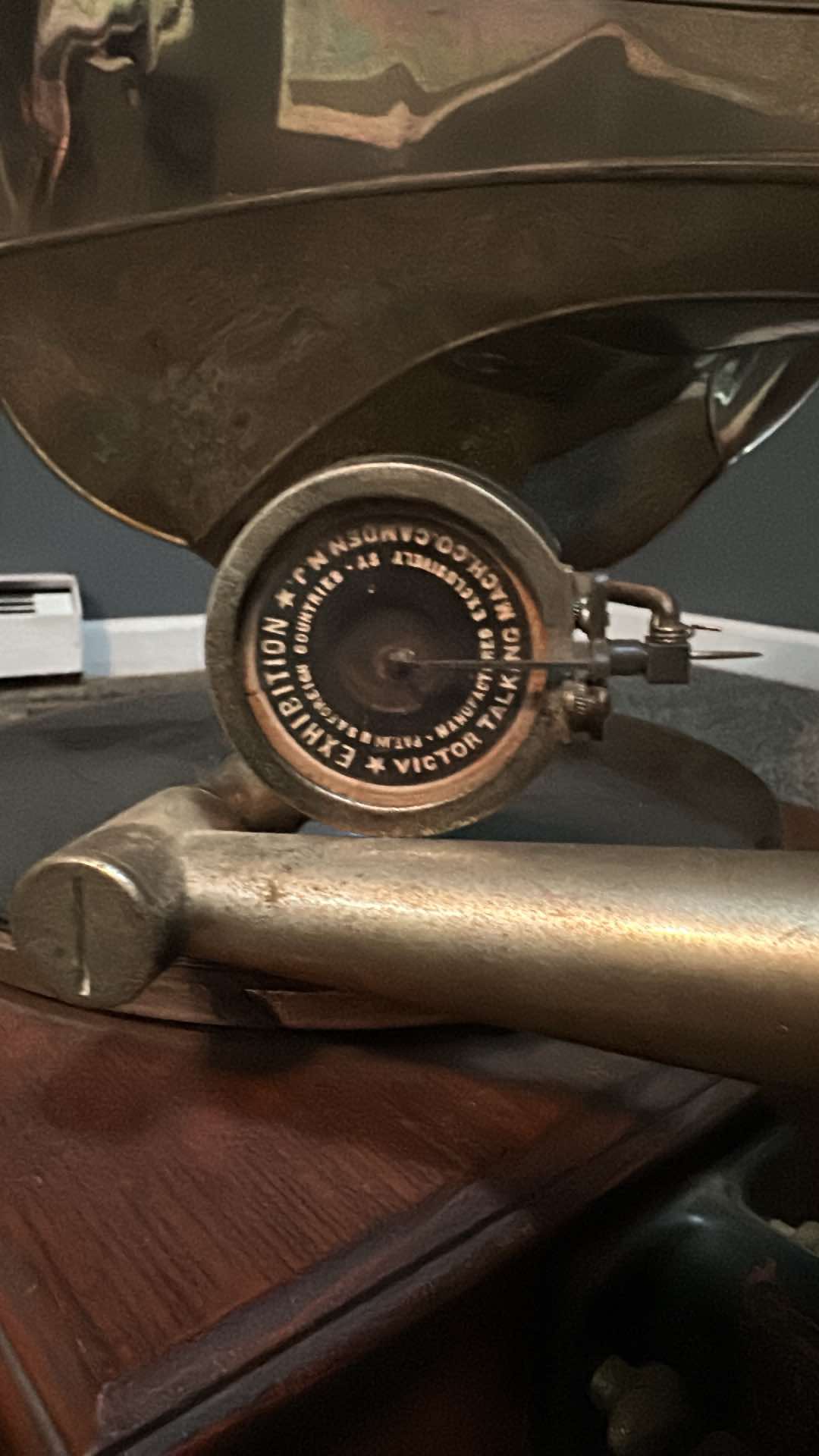

I have a Victor M, and I consider it to be an outstanding machine. Yes, it does sound a bit loud because of the beveled gears, but that’s just part of the beauty of the time period in which it was made. I believe that some people will install fiber gears to get it quieter, but I would never do that. You also need to remember that these machines came with a round hole Victor exhibition, which really didn’t hold a medium or small needle very well. I learned early on, that they will sometimes come out when playing. Since I’m generally using a loud needle, you generally don’t hear the motor anyway, unless you want to put a sock in it as they say. It also helps that I have an oversized horn, which is original to the machine and just an upgrade that was purchased in 1903.

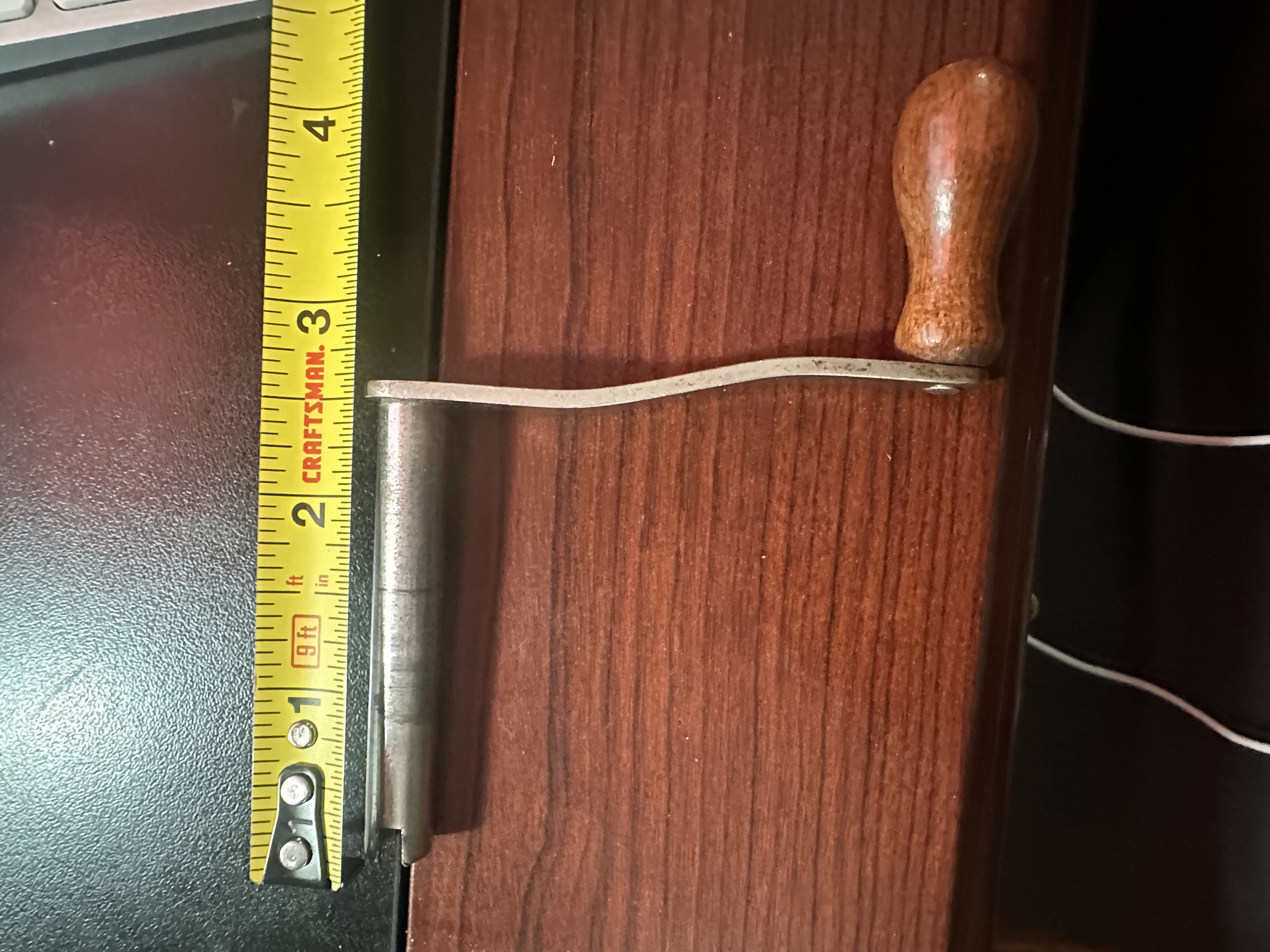

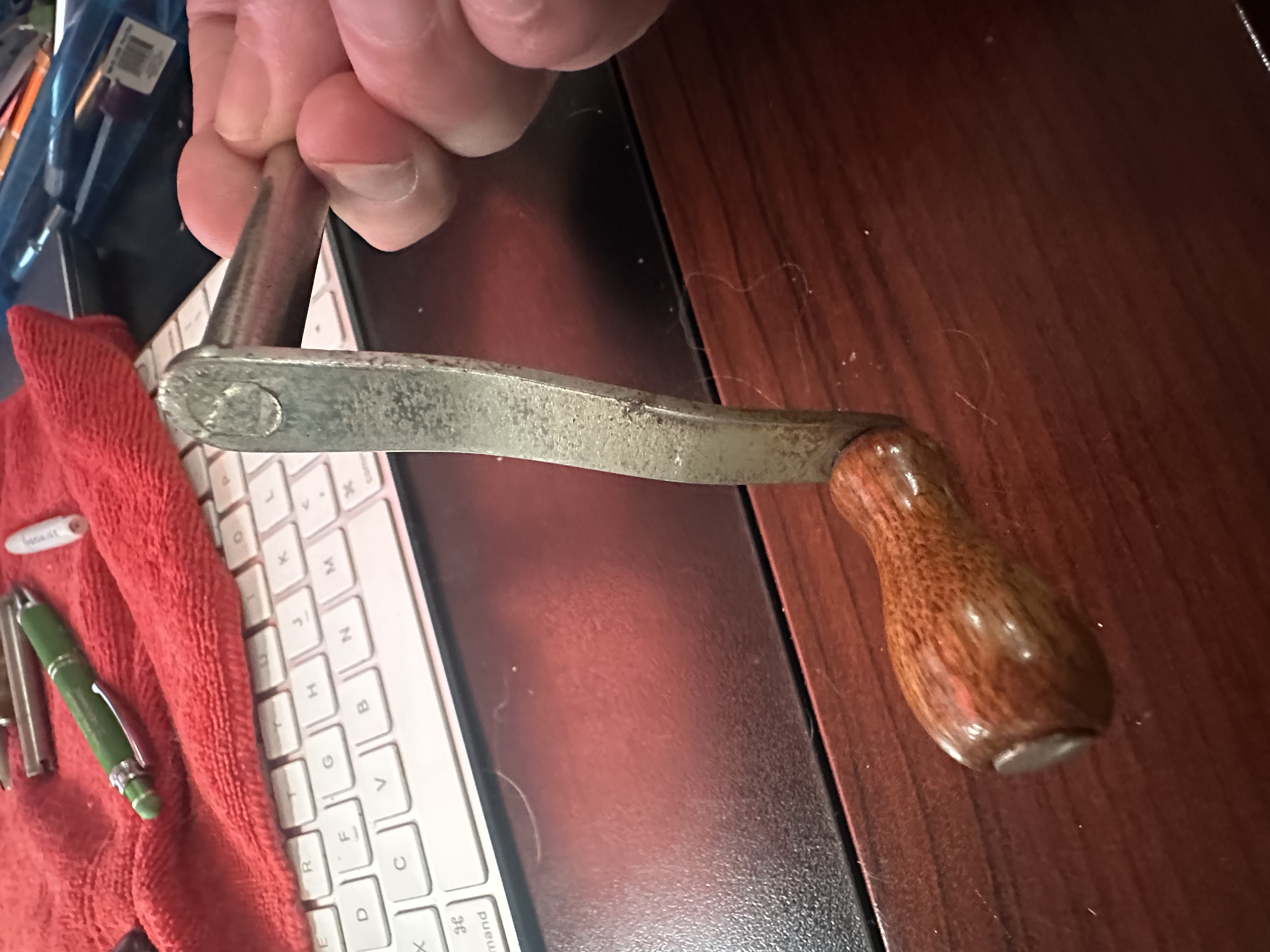

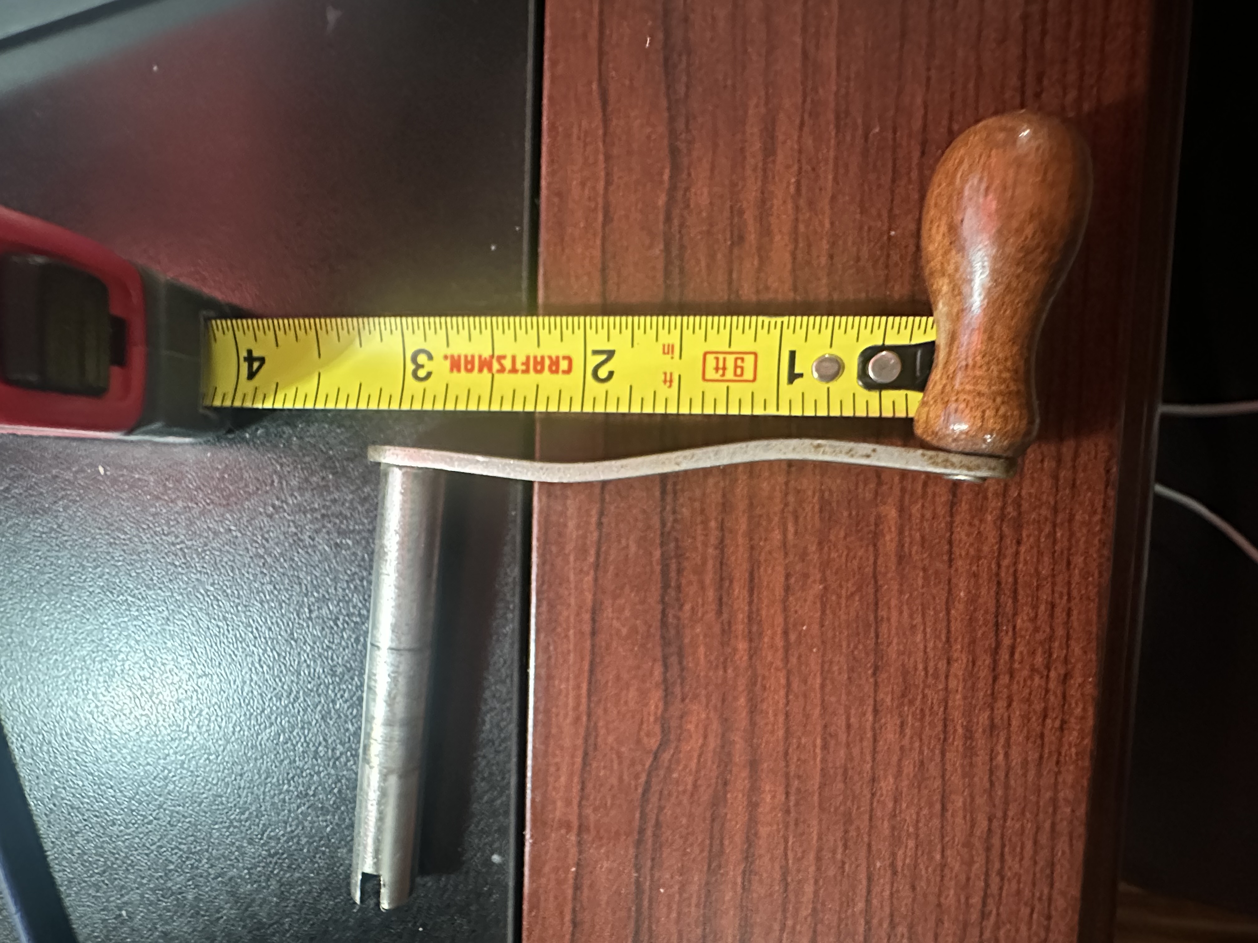

Thanks, everyone. The next time I get to storage I will examine the horn more closely to see whether or not it's an adapted Columbia horn, but I suspect not. In the meantime, could someone kindly post a picture of the proper crank for this machine? A picture with measurements would be even more helpful, if possible.
Also: Did Victor make long-throat Exhibitions?
Yes, Victor made long-throat Exhibitions. See photos and measurements for the crank.Zenger wrote: Wed Mar 05, 2025 8:06 pm Thanks, everyone. The next time I get to storage I will examine the horn more closely to see whether or not it's an adapted Columbia horn, but I suspect not. In the meantime, could someone kindly post a picture of the proper crank for this machine? A picture with measurements would be even more helpful, if possible.
