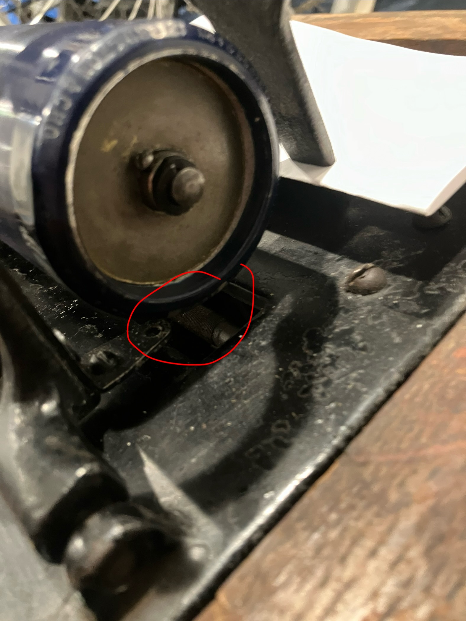

Re: Amberola 30 Repeating
Hi everyone, after inspection I am missing both the lower screw and the little plate that is circled. Does anyone know where i can get this piece? (or have one to sell?)
