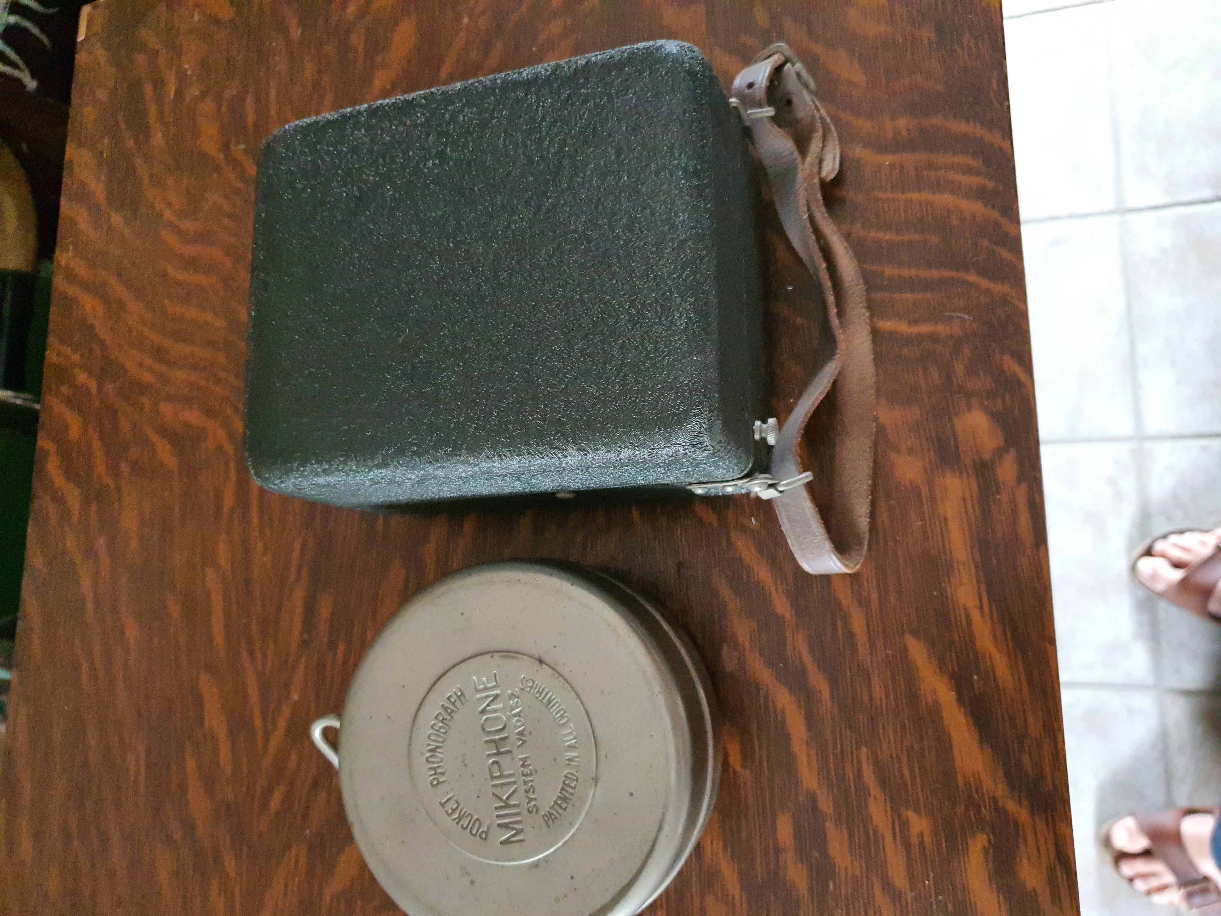

If we're talking strictly commercially available mass produced machines then the correct answer of course is the Swiss Mikiphone.
I don't know about cylinder machines!

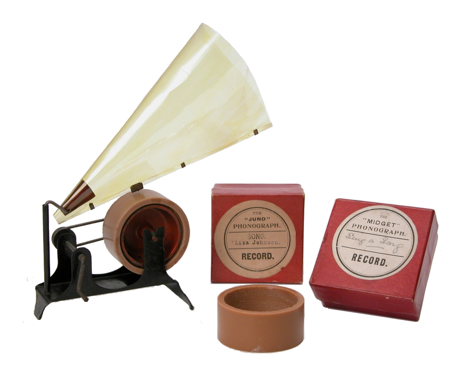

Named the Juno phonograph, this small toy was built by the Juno Phonograph Manufacturing Co. in London, based on patent No. 7594 filed on 23 June 1900 by William Phillips Thompson.
The originality of the Juno is due to its horn consisting of a yellow celluloid horn, on the basis of which is fixed a sapphire by means of a small iron clamp. In order to ballast it and place it on its support, a piece of lead was placed in the tip of the horn.
This tiny phonograph (the length of the base of black sheet measures 10 cm), plays interchangeable wax cylinders with a diameter of 56 mm and a width of 24 mm.
The Juno was also sold under the name The Midget, so it could play the identical cylinders of both brands.
Other small cylinder phonographs are described on this page of my site : https://www.phonorama.fr/phonographes-divers-p2.html
