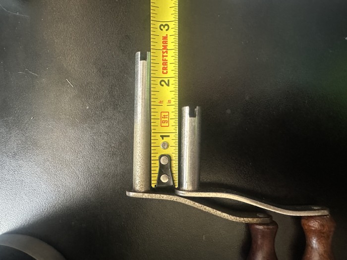

Greetings. I'm looking for an early Victor slotted crank, the kind that would go with a Victor C, E, Monarch, etc. If you have one or even a lead for me to pursue, please PM me. Also, if you just have a picture of one (I don't, unfortunately), would you be so kind as to post it here, perhaps even with measurements? I would really appreciate it. Thanks!

The early Victor machine cranks had different barrel lengths. The early ERJ M, Victor C, R and Victor Jr were 1 ½" long and the later style M, E, MS, etc 2 ½" long. At least on my machines anyway. The longer barrel will fit all machines and could be cut shorter if need be.
I'm sure some of the experts here will chime in.
