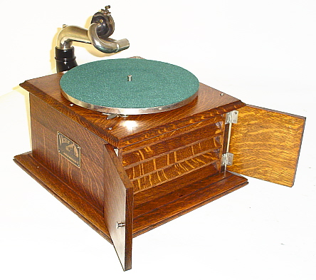

I had a chance to do some more research, and before you say "no," take a look at this video -- https://www.youtube.com/watch?v=wEudTWn ... yN&index=2
Based on the way the louvers are positioned, it looked like it might have a legitimate horn.
...especially compared to the way the louvers are positioned in a model without a horn.
VV-IV Victrola.jpg (104.43 KiB) Viewed 2014 times

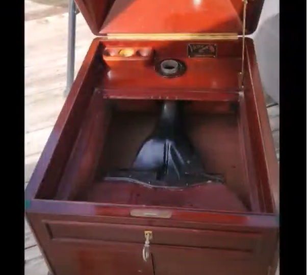

So I checked out more videos on The Phonograph Stop YouTube site and spotted this:
https://www.youtube.com/watch?v=vke_5TQ7gPo
OrthoFan
Table Model VV-XI horn.jpg (57.84 KiB) Viewed 1971 times
So, while it's not a "floating" horn, it is, indeed, a horn.
pellicano1, who posted the linked video on his YouTube page, is a member of this forum. You might want to get in touch with him for more information.
