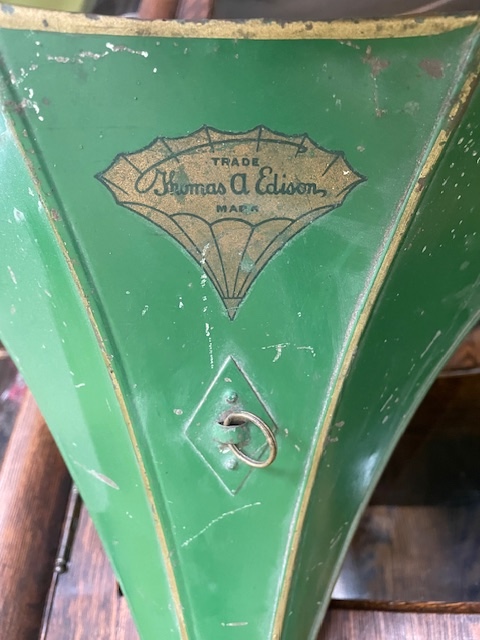

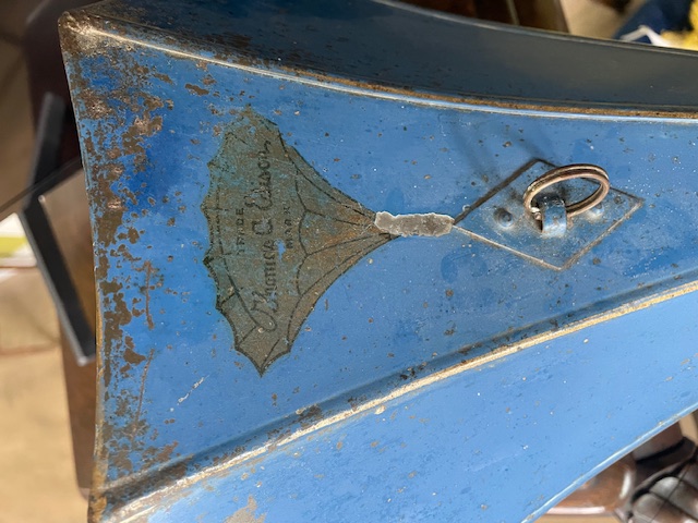

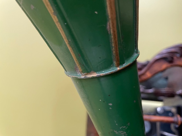

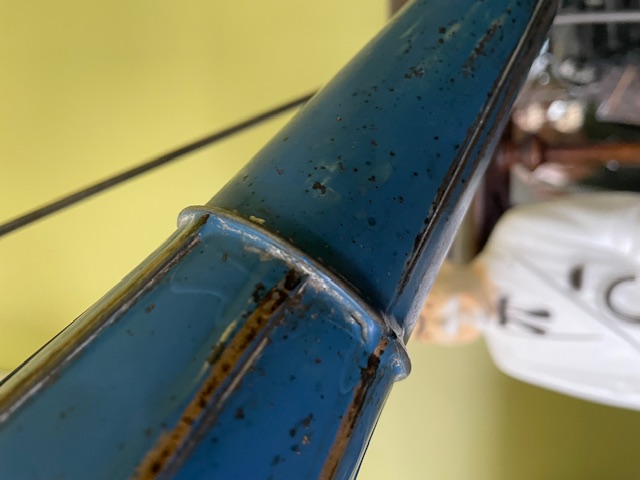

Here are some detailed pics that indicate the green and blue horns are original. Owner says they are from Australia.
- Attachments
- Unknown-1.jpeg (74.59 KiB) Viewed 2106 times
- IMG_4234.jpeg (60.38 KiB) Viewed 2106 times
- Unknown.jpeg (117.93 KiB) Viewed 2106 times
- IMG_4232.jpeg (135.71 KiB) Viewed 2106 times
