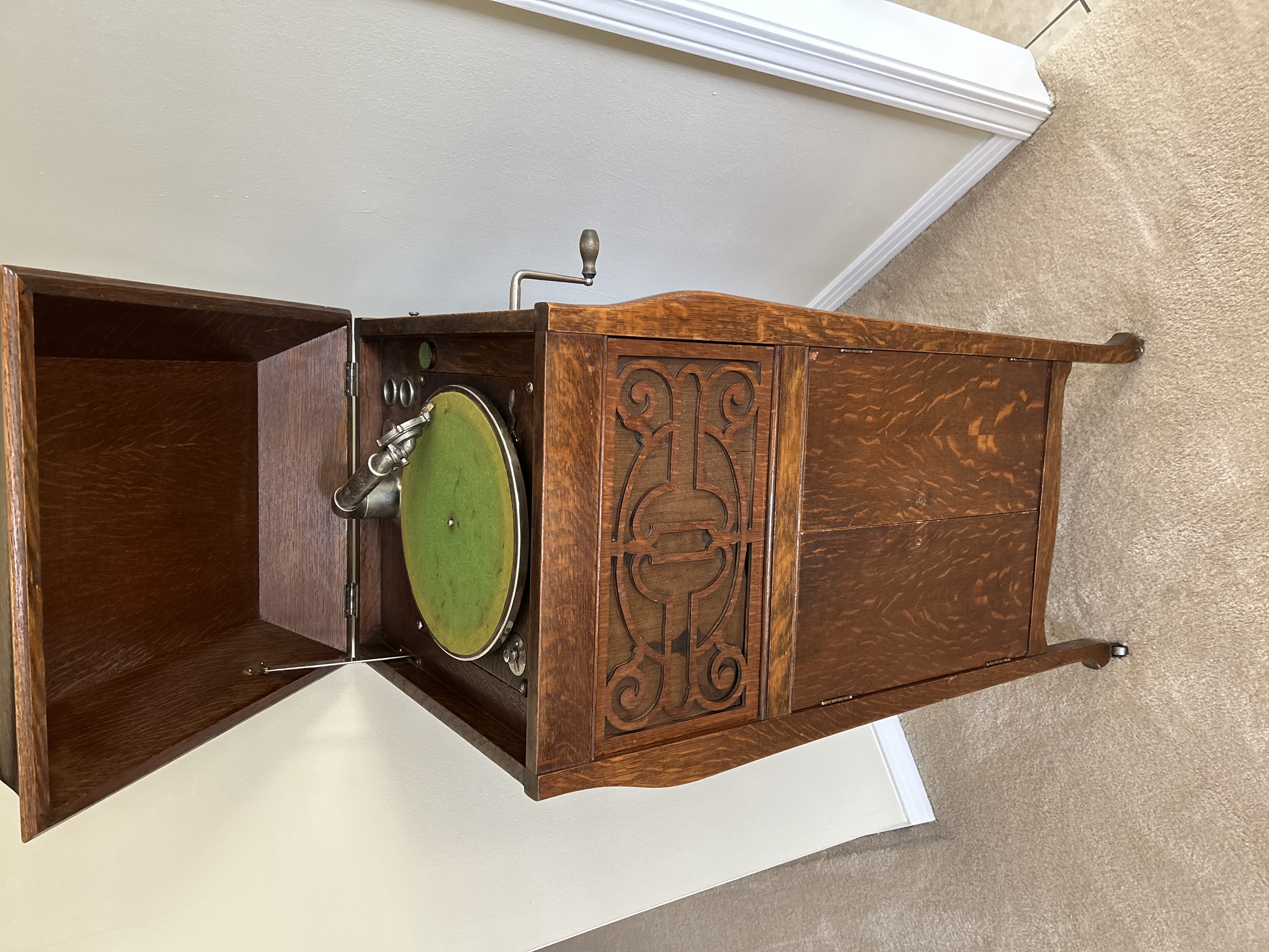

My father has passed along a nice phonograph to me this past weekend. It was originally purchased by my great grandfather around 1920. My grandmother had it for quite awhile, then my father for the last 15 years.

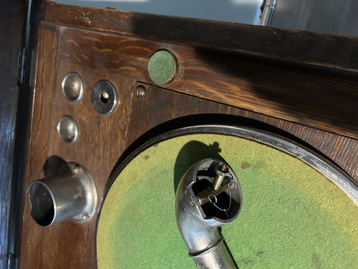

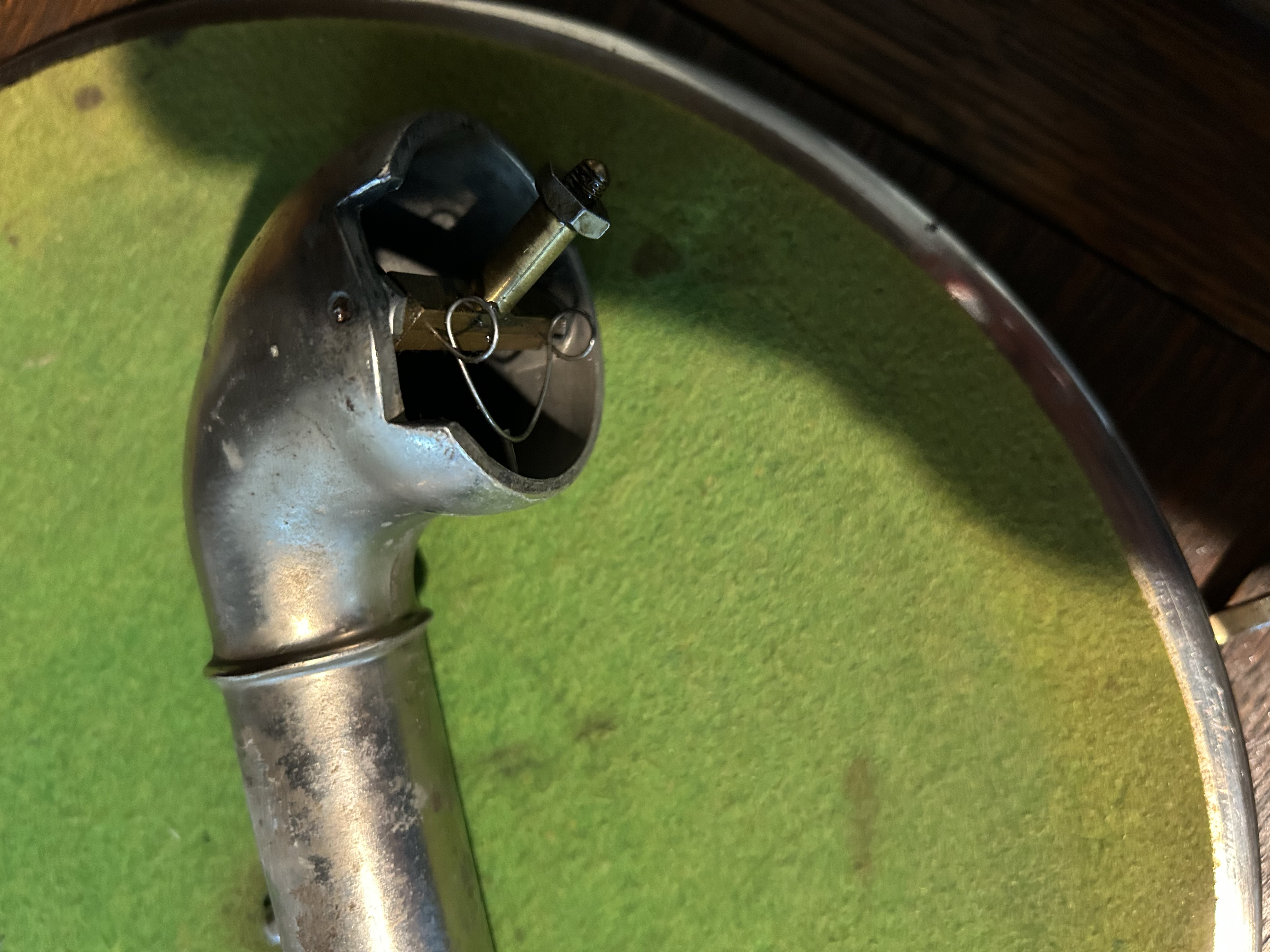

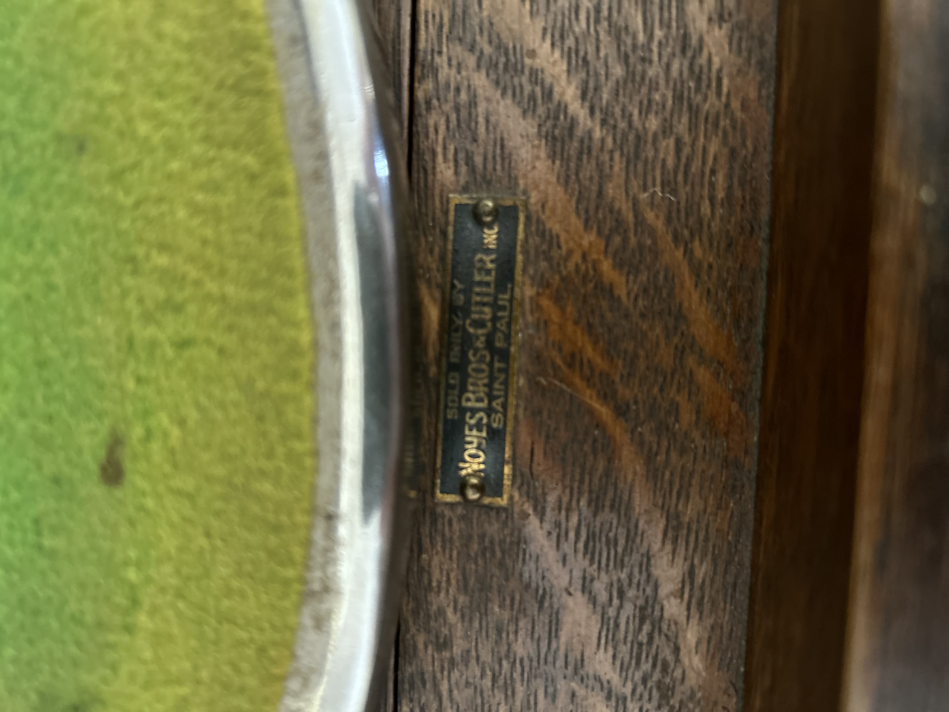

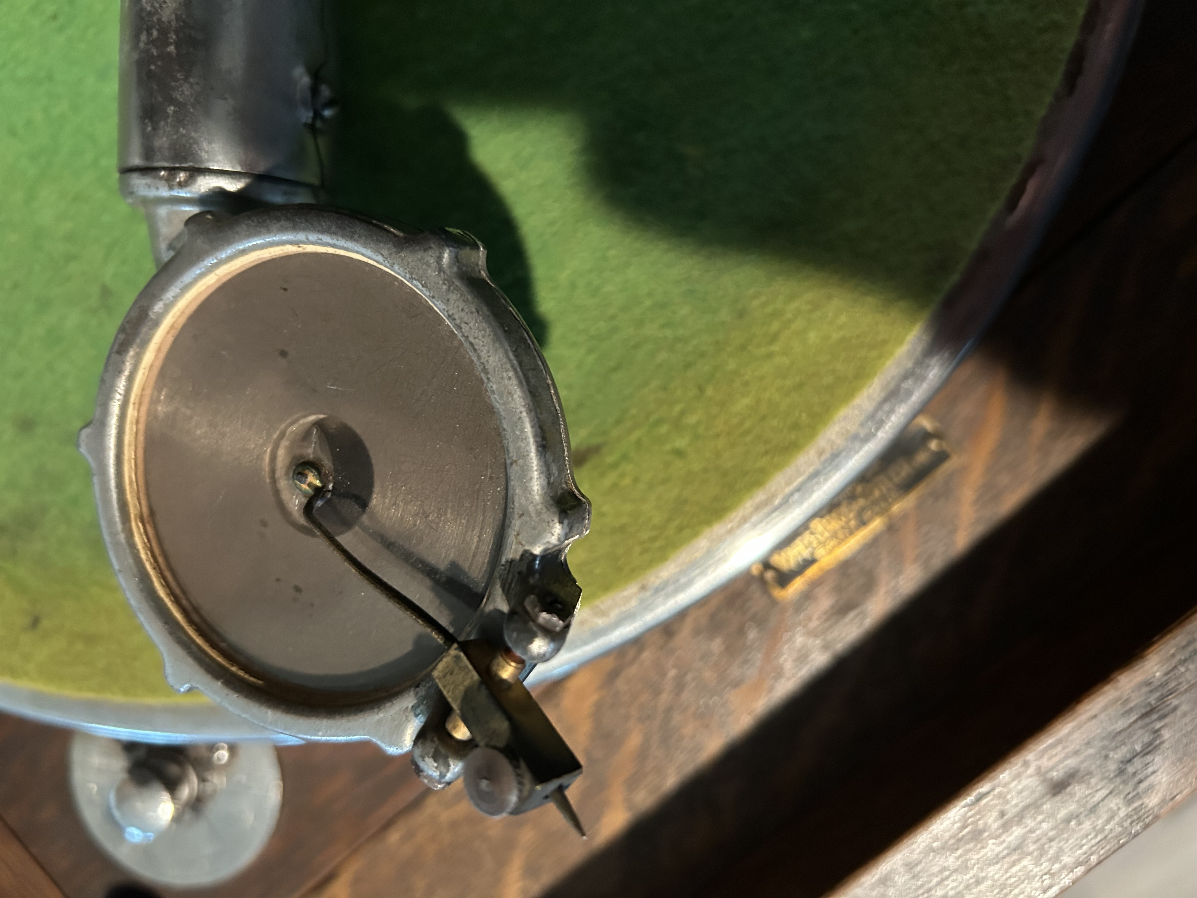

It has a plate that says “Sold only by Noyes Bros & Cutler Inc, Saint Paul”. From my research, this is a Paramount c1920. At least the cabinet is. I have not dug into this machine any further. It still winds up some, the turn table and brake work, but it chatters some.

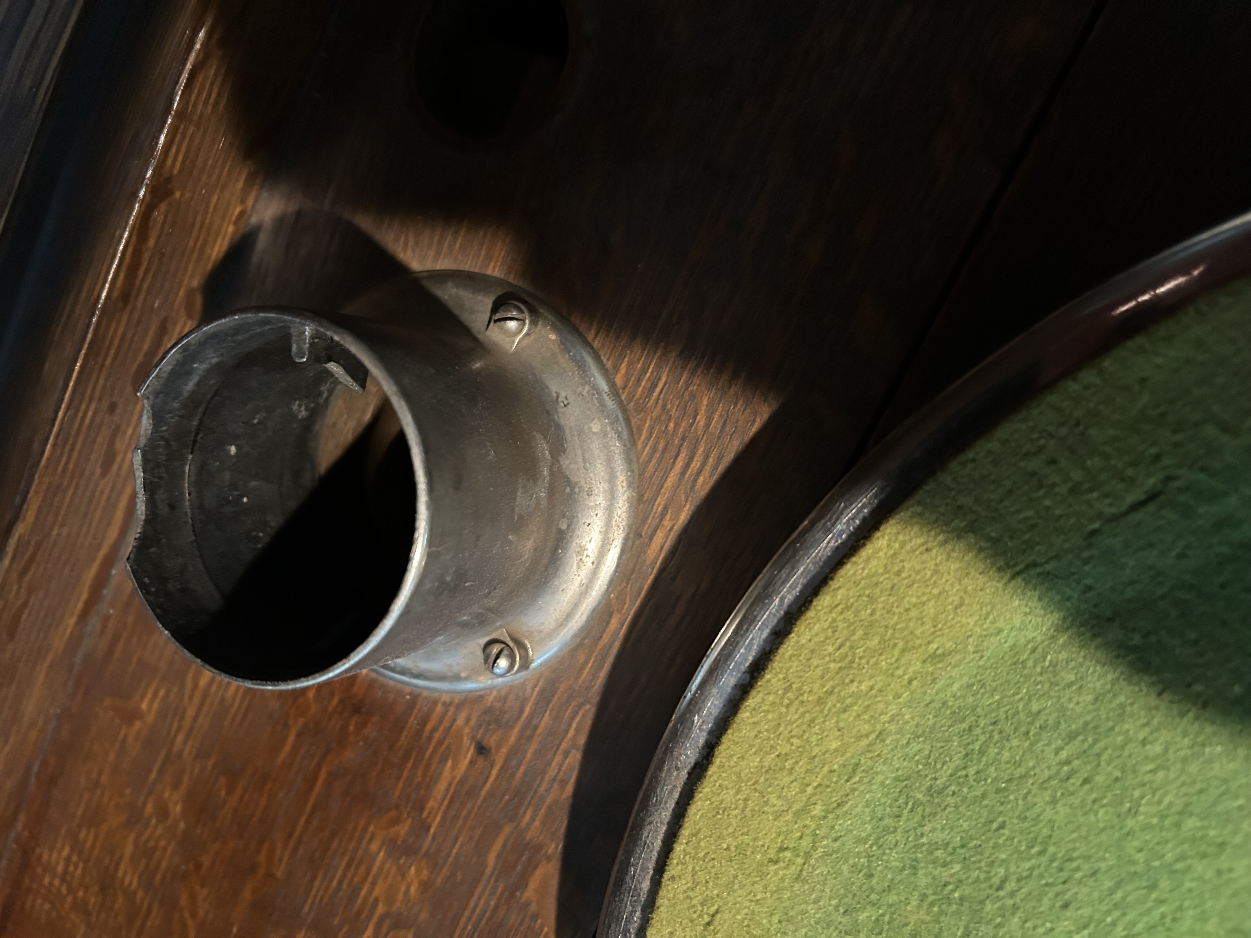

The tonearm is broken where it mounts. I need a new one! Either an original, or even another one that gets the job done at this point would make me happy.

It's good that you're open to using an appropriate but not exact tone arm replacement. The one critical dimension in sourcing one, will be the distance from the center of the turntable spindle to the center of the hole where the tone arm mounts. You'll want to find a tone arm that has that length from its rear pivot point to the tip of the needle. It doesn't have to be exact. Maybe +/- ¼". Also, the base will need to fit up well with hole in the cabinet motor board.
Posts: 4619
Re: My first machine. Need advice and help!
Looks like the tonearm base has lost some clamp pin to engage on these parts inside the tonearm. The missing bits would have likely fallen down are may still be inside the internal horn...!

Inigo wrote: Tue Mar 25, 2025 12:36 pm Looks like the tonearm base has lost some clamp pin to engage on these parts inside the tonearm. The missing bits would have likely fallen down are may still be inside the internal horn...!
I looked behind the grill last night. No luck unfortunately.
