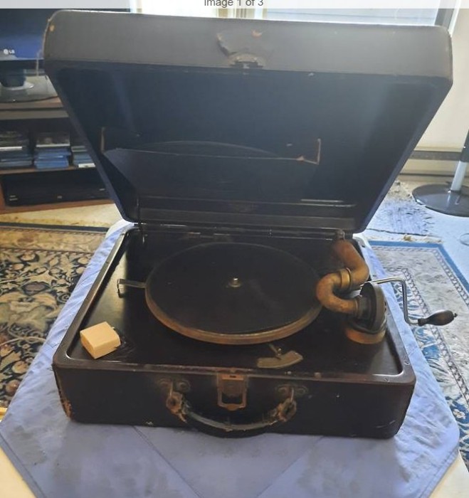

Is this a VV2-55?
Is it being used as a cheese tray? ;)
What is the thing that looks like a cube of white cheese sitting on top of? I don't ask about the cube itself because I suspect that it is not a stock item.

Looks like a small block of wood serving some sort of purpose.
CharliePhono
Posts: 923
Location: North Fork, CA
Re: Is This a VV2-55?
Post by CharliePhono »
It is indeed a 2-55. I wonder if that block is something like foam rubber which the owner used to rest the reproducer on when the case is closed? That's just conjecture. Those reproducer rests are either missing usually or the rubber has hardened to the point of being no longer usable.
Or, is it perhaps a small container for needles? The 2-55 had no needle cups, and the only provision for storing needles was to use the Tungs-Tone styli, which that clip type holder was designed for.

CharliePhono wrote: Sun Mar 30, 2025 2:03 pm It is indeed a 2-55. I wonder if that block is something like foam rubber which the owner used to rest the reproducer on when the case is closed? That's just conjecture. Those reproducer rests are either missing usually or the rubber has hardened to the point of being no longer usable.
The little "bowl" in the needle tin holder is the needle cup. It's covered when the tin is in place.

My pleasure. I'm still trying to figure out what the block of wood is for. It would be held in place with the lid closed, so maybe it's taking the place of a tin?

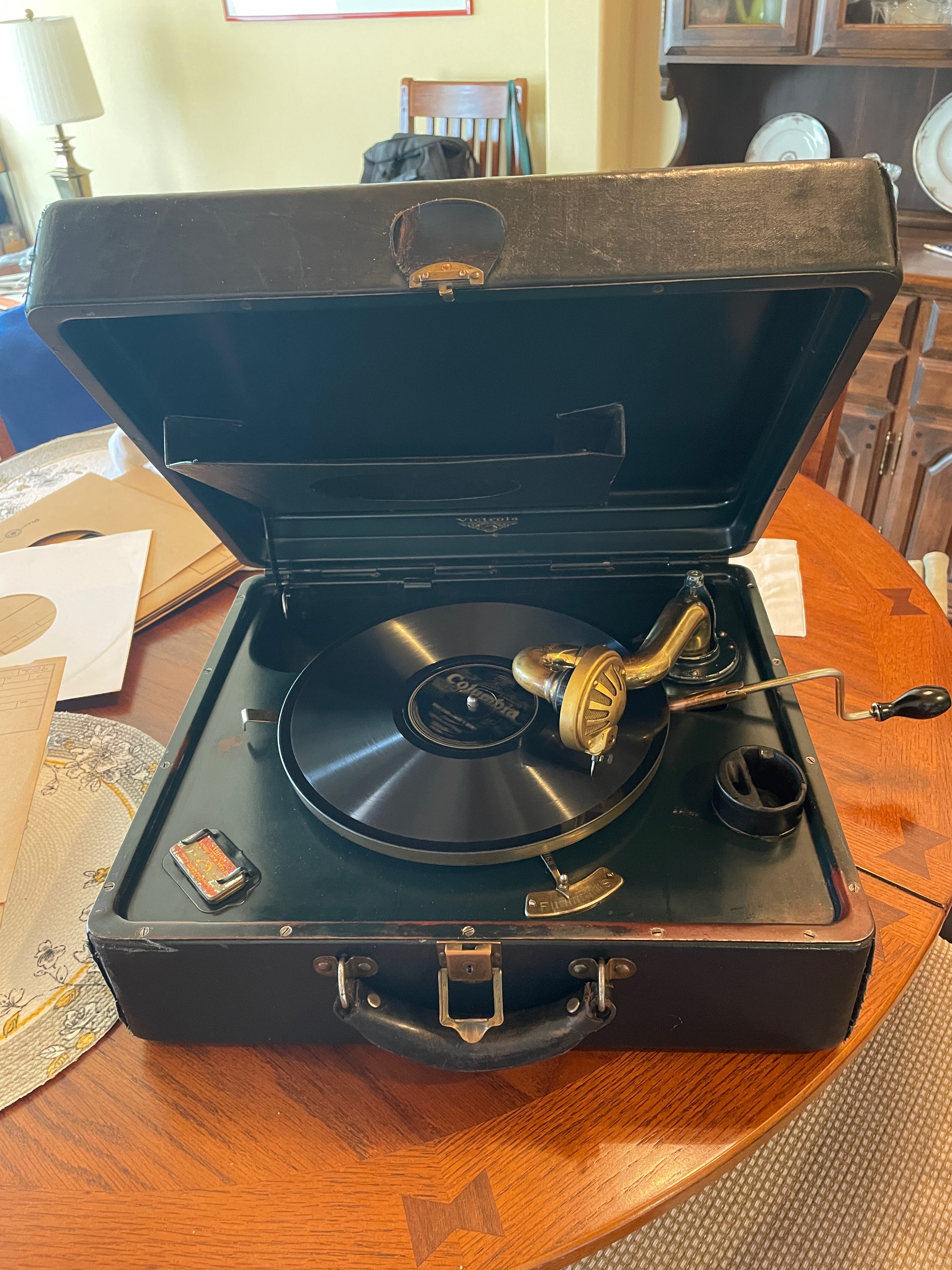

Yes. And the used needle repository is built into the reproducer rest on the right.
I have one of these portable phonographs. With the Orthophonic reproducer, it sounds great. Amazingly good for a portable, where the sound is reflected off of the record holder built into the lid.

Well ... the machine is mine now, despite my desperate and ultimately futile attempts to walk away from it. The seller did not want to let me leave. I paid the equivalent of about $20 US.
I also got a big bag with about two to three hundred unused looking needles, and two garbage records.
The machine all works.... sort of .... after a fashion.
The reproducer is grubby but in good working order and condition. Its set screw is missing, however. I played some challenging electrically recorded disks with a medium tone needle--no problems
The spring is good. It takes a lot of turns to wind it up anywhere near fully wound. It makes no noise winding or unwinding. I put on one of the worst records for drag that I own. It did not slow things down at all.
Speed control works.
The motor is less good. It makes a lot of noise, including some squeaking, but less so when there is some drag from a record. I hope lubrication will help this.
Everything is out of adjustment. The tone arm needs a major overhaul. The auto-brake and brake disengagement/start mechanism wasn't working--the wooden block seen in the photo way above was there to jam between the case and the start lever. I got this all working in about five min, but it needs cleaning, and I need to see some pics of how it all looks properly set up.
Thank you for the information about the needle repository.
Thank you also for the inspirational picture.
Your machine looks so much nicer than mine! Sigh! :mrgreen:

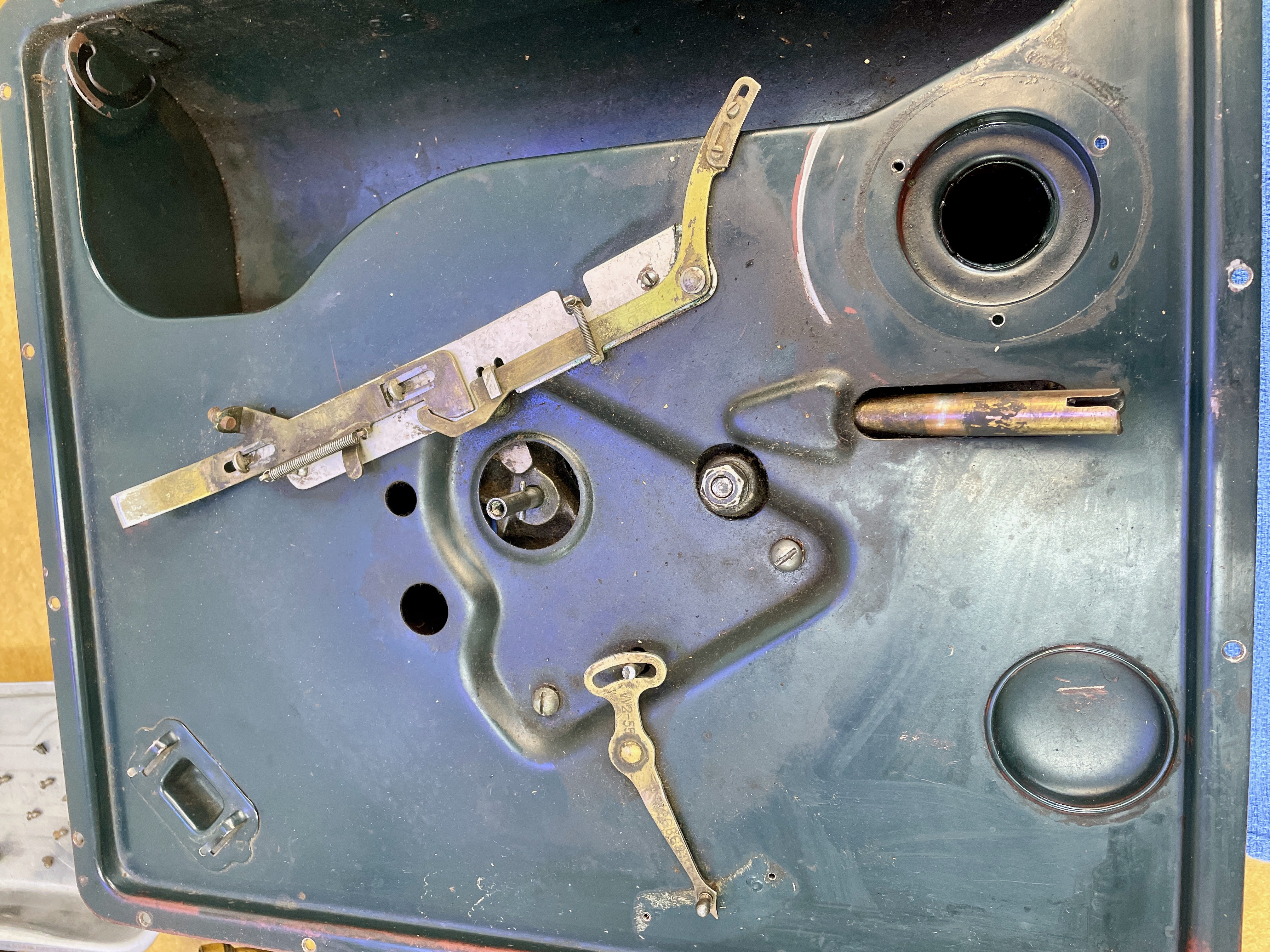

I wonder if you might kindly remove the platter and take a picture for me of the auto-brake system. I need a reference.

I disassembled my phonograph and cleaned decades of dirt and grime off of everything.
Here is a photo of the brake mechanism during clean up.
HTH.
