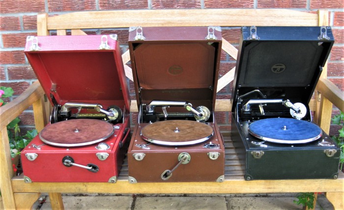

Depending on the year of production, your Columbia 202 could have one of three different motors.
UK Columbia and HMV merged in 1931 to form EMI. All three versions are pictured.
The red one is pre-EMI with the Garrard No. 50 motor and No.9 soundbox.
The brown one has the HMV No.69 motor and No.15 soundbox.
The black one has the side wound HMV 270 Series motor and No.15 soundbox.
