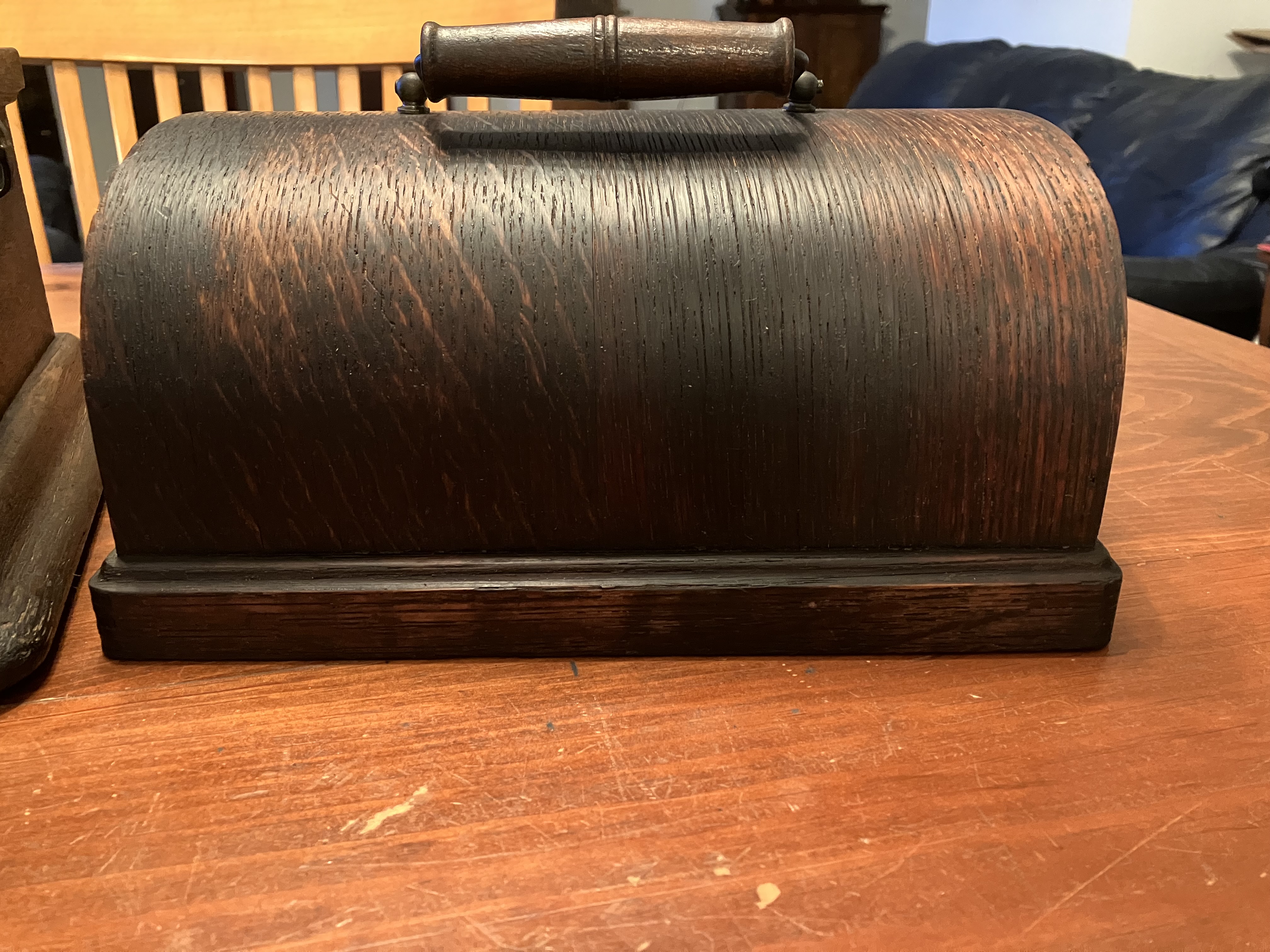

A number of years ago someone suggested using Goop hand cleaner for the wood casing on my phonographs. Do I need to let it sit for a while? Only because the Fireside phonograph I have. Has at least a century of grime on it? Or should I try something else?

George Paul, said I need to buy paint remover or stripper. As someone had painted to cabinet. For what reason? I don’t know?

Actually, my message was, "The case looks as though it's been painted. If so, you'll need stripper. "Edisonfan wrote: Wed Apr 02, 2025 8:35 pm George Paul, said I need to buy paint remover or stripper. As someone had painted to cabinet. For what reason? I don’t know?
