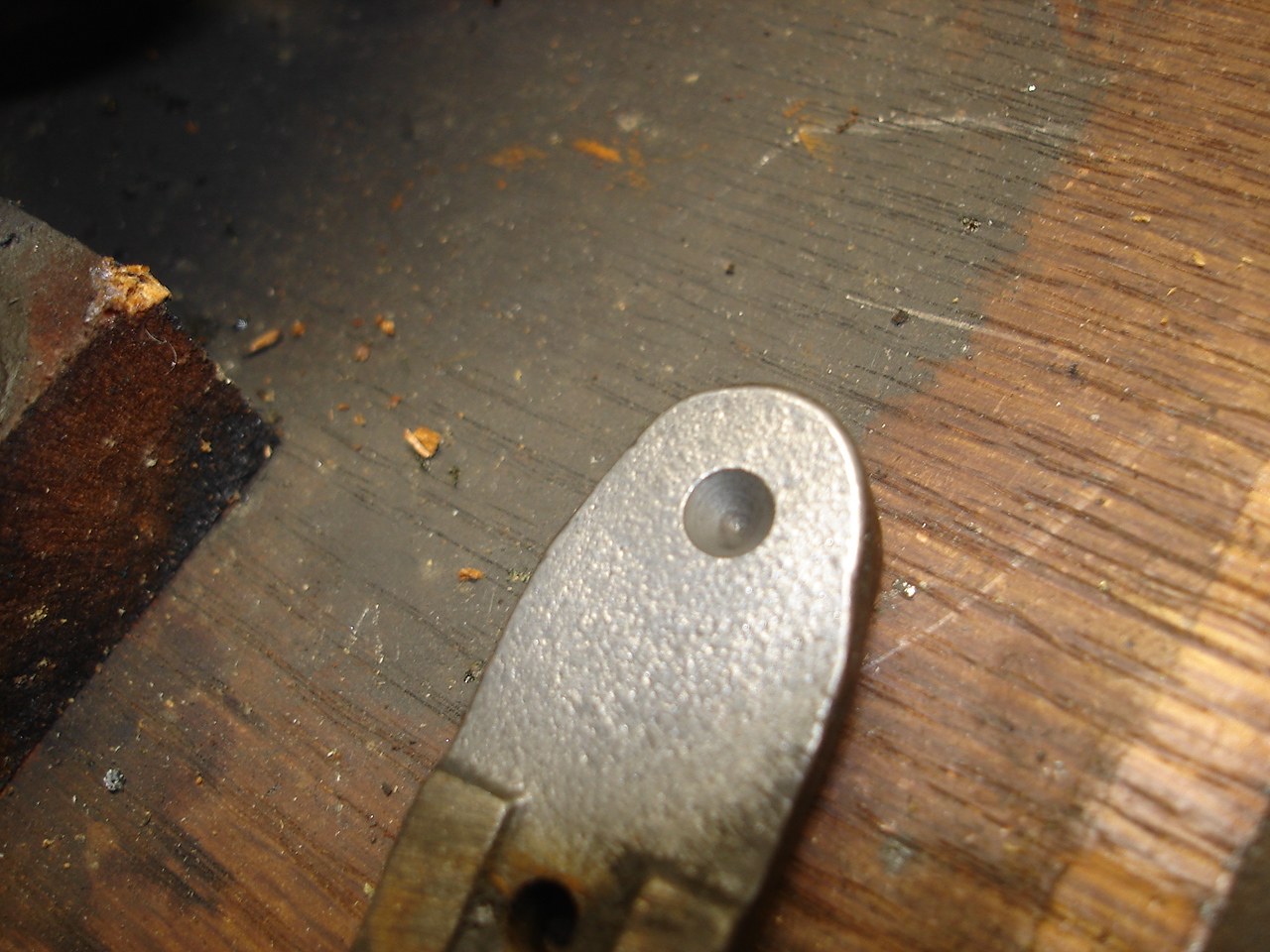

If the oblong piece in the end view is what you're referring to, I think you'll find that it's not any kind of adjustment. It's a hard steel piece that's meant to be a thrust bearing surface for the governor shaft. I have a motor like that. I'll have a look at it to see what might be adjustable.
At a quick inspection of my motor, I'm not finding any governor height adjustment. Also, the governor drive gear is not adjustable either, due to it being pinned to the spindle shaft. Is it possible for you to show a picture of the misalignment you're concerned about?

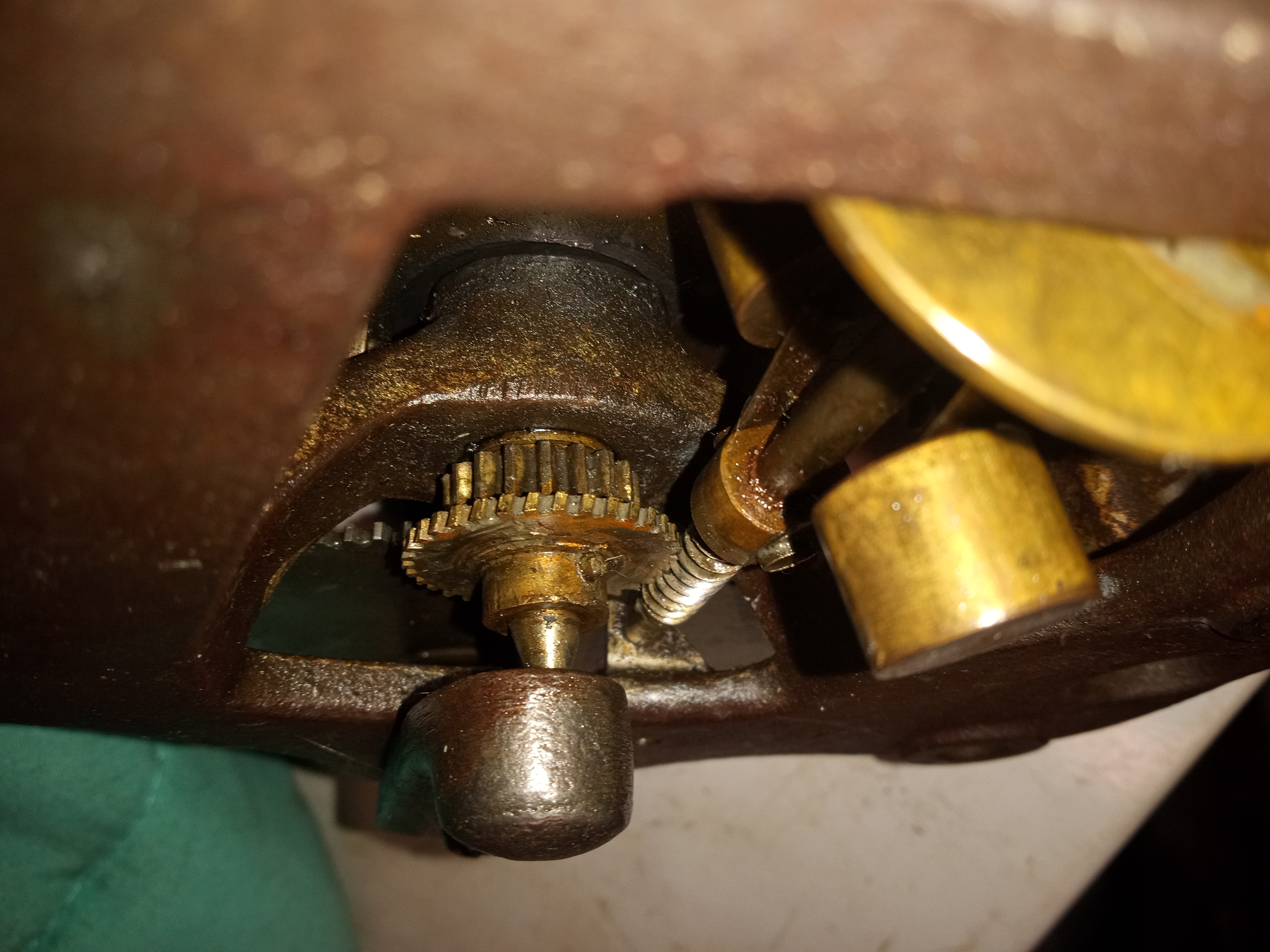

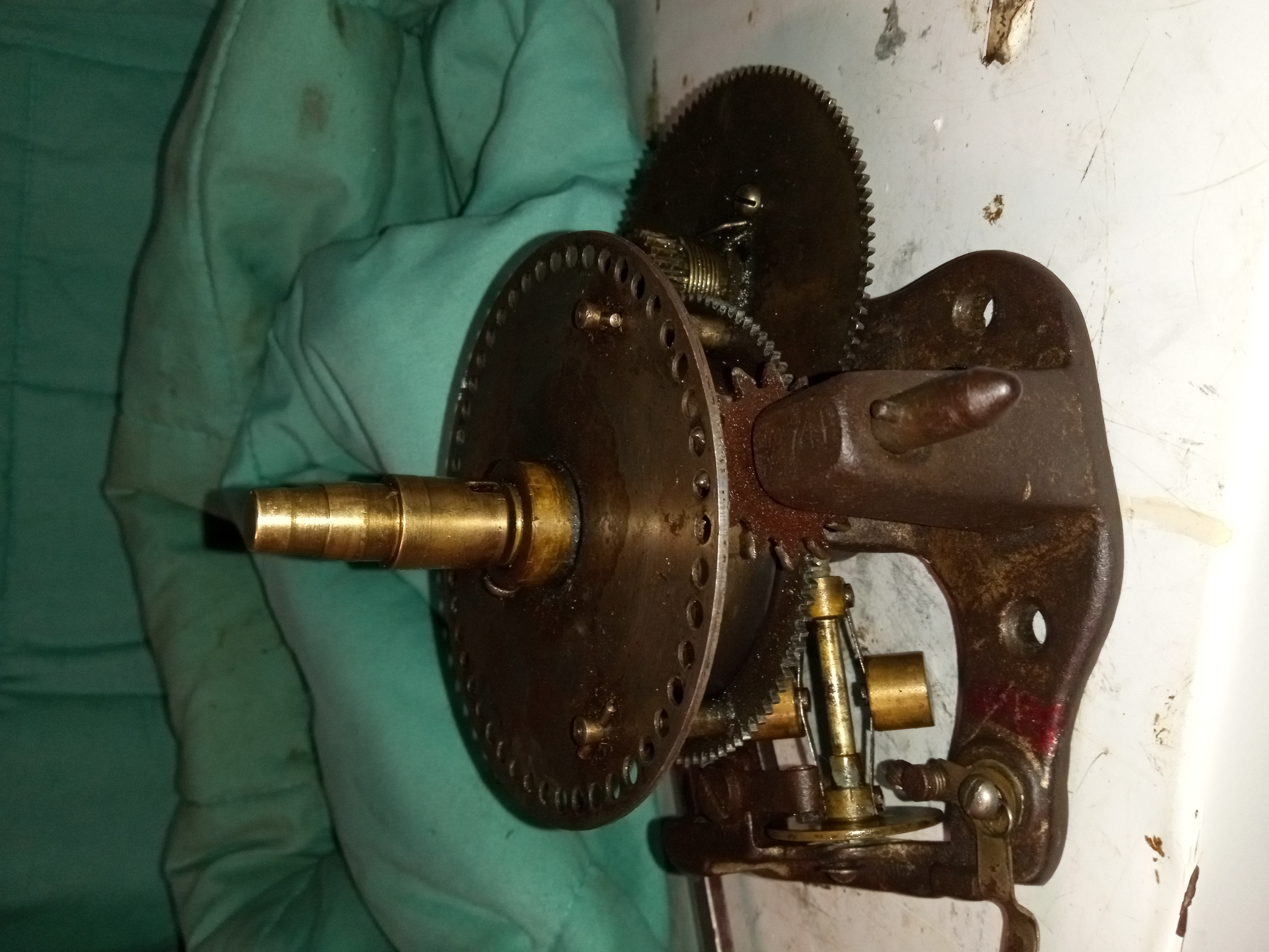

Re: Harmony Governor Adjustment

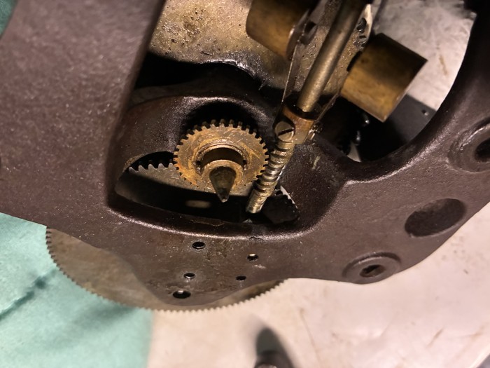

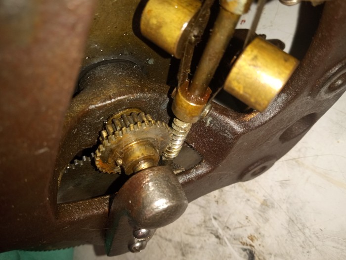

You are 100% correct, that is not an adjustment. Below you will find photos. When the shaft is all the way down, it does not line up with the governor. When it is lined up, the shaft is up out of the base. Could I put a ball bearing in the base to raise the shaft to the right position?

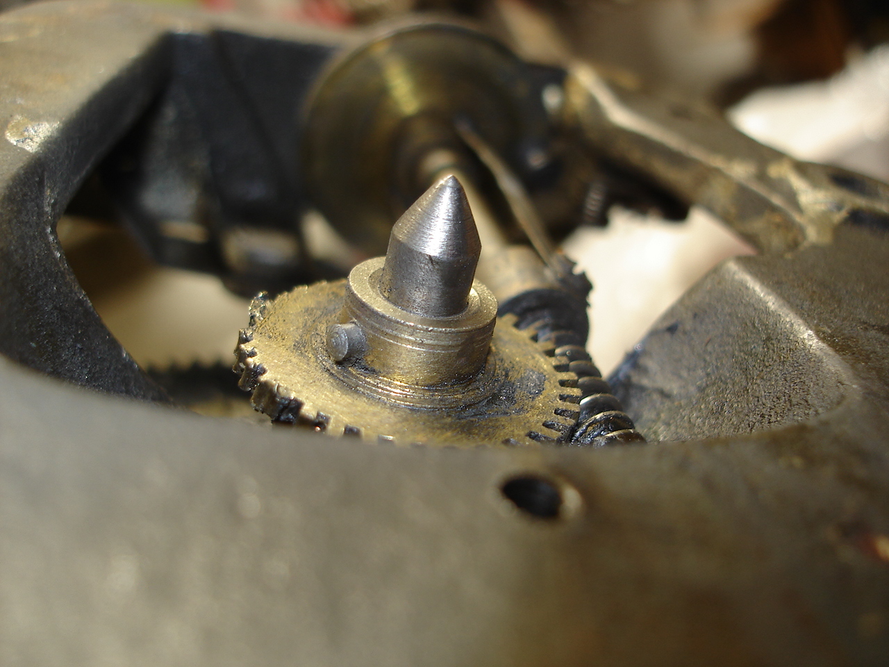

- Posts: 6557

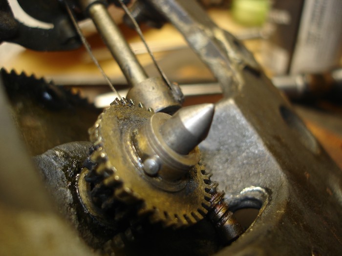

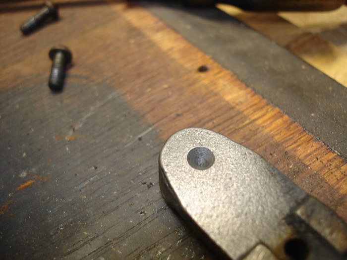

It appears that someone has "been in there" and has done some mischief.
Here is how things should look. The dimension from the tip of the spindle shaft to the shoulder of the gear should be 11/32". It appears that maybe somebody ground down the end of your spindle shaft, for whatever reason. A ball bearing will not help in this case.
With your motor completely wound down, maybe you could remove the support piece and post some similar pictures?

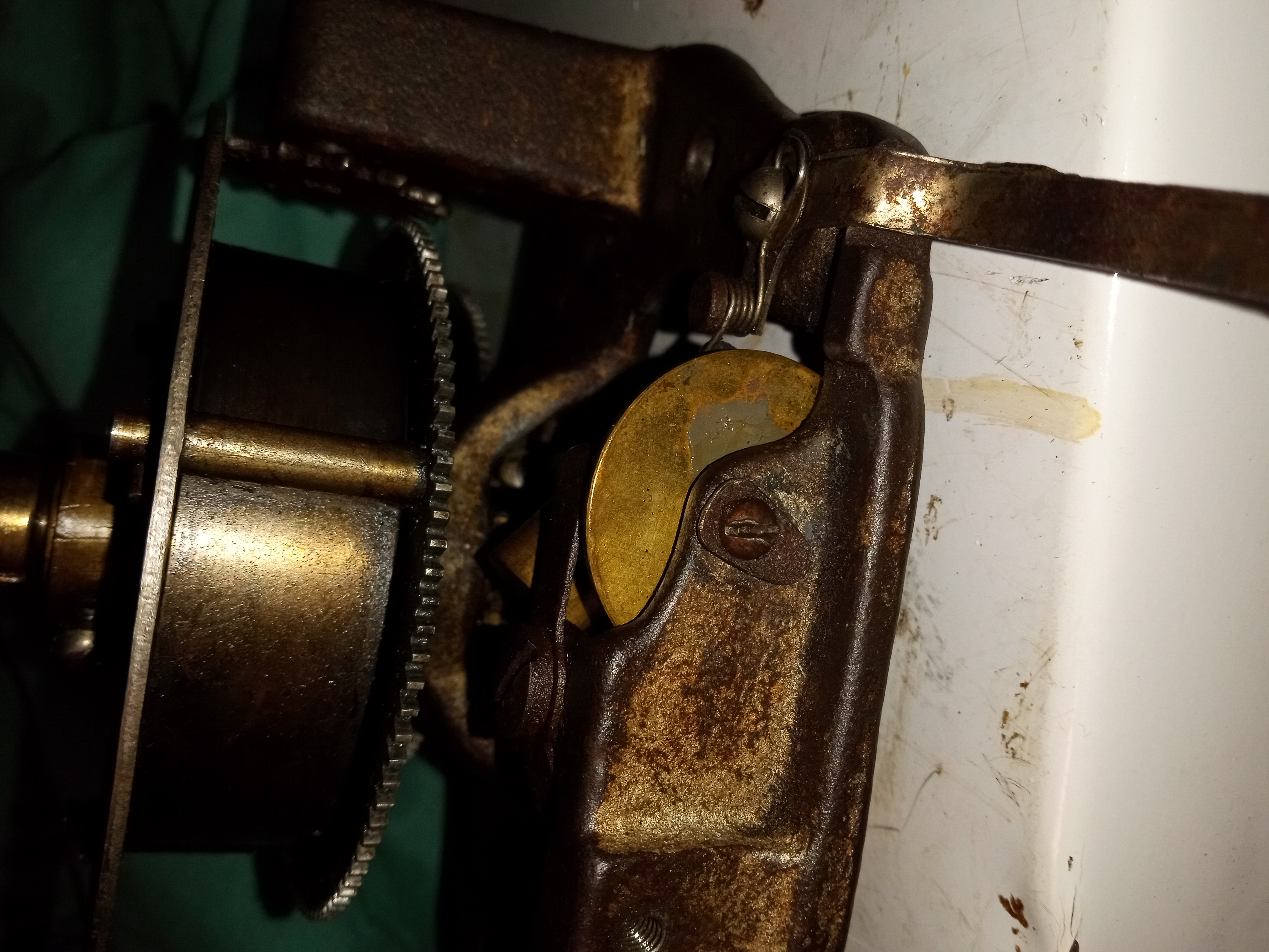

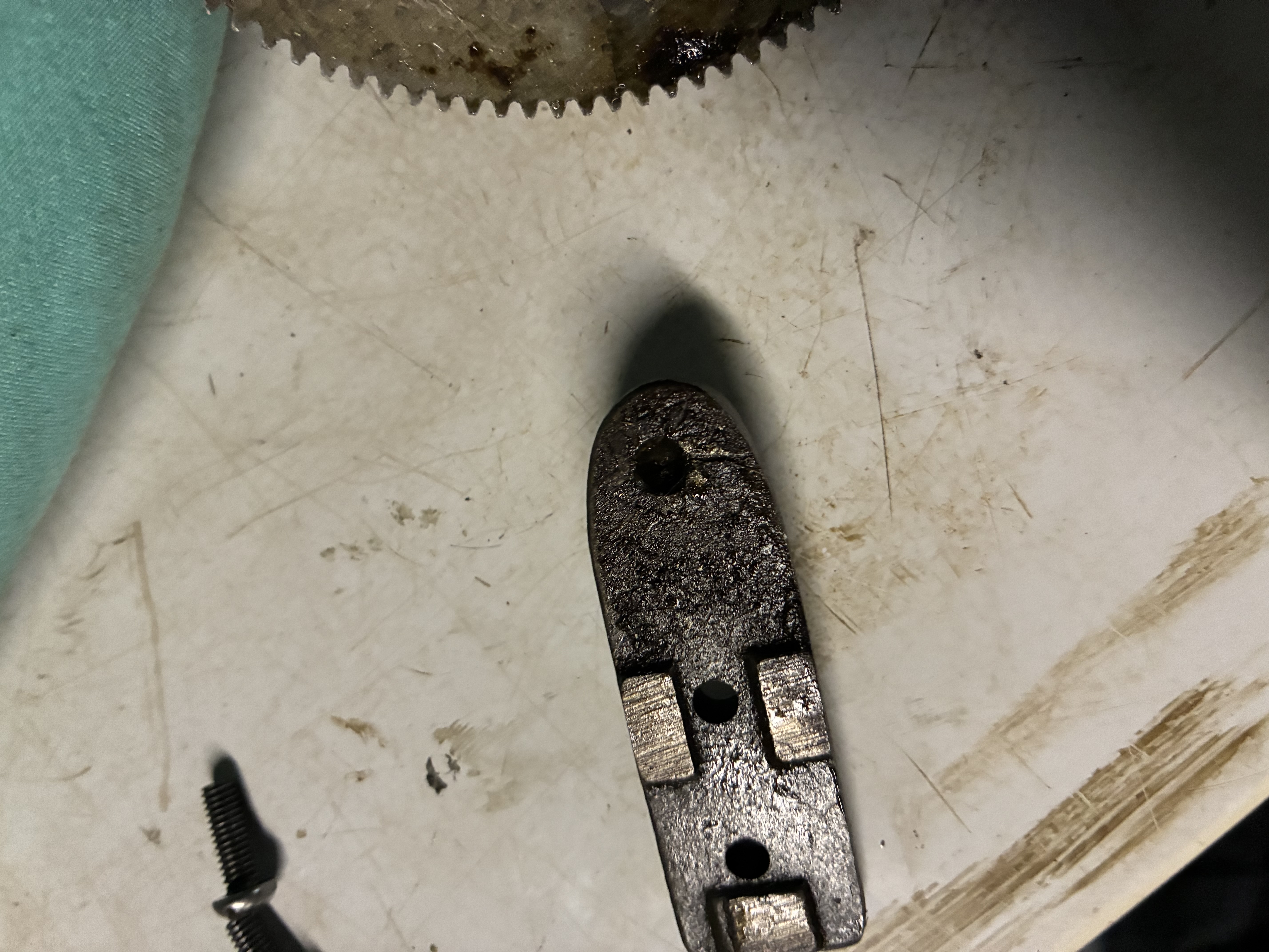

Jerry,
I have removed the lower support ( see photos) and nothing seems too worn or damaged. I even swapped a spare support from a parts motor from an Arentino and still the same issue.
Mike
