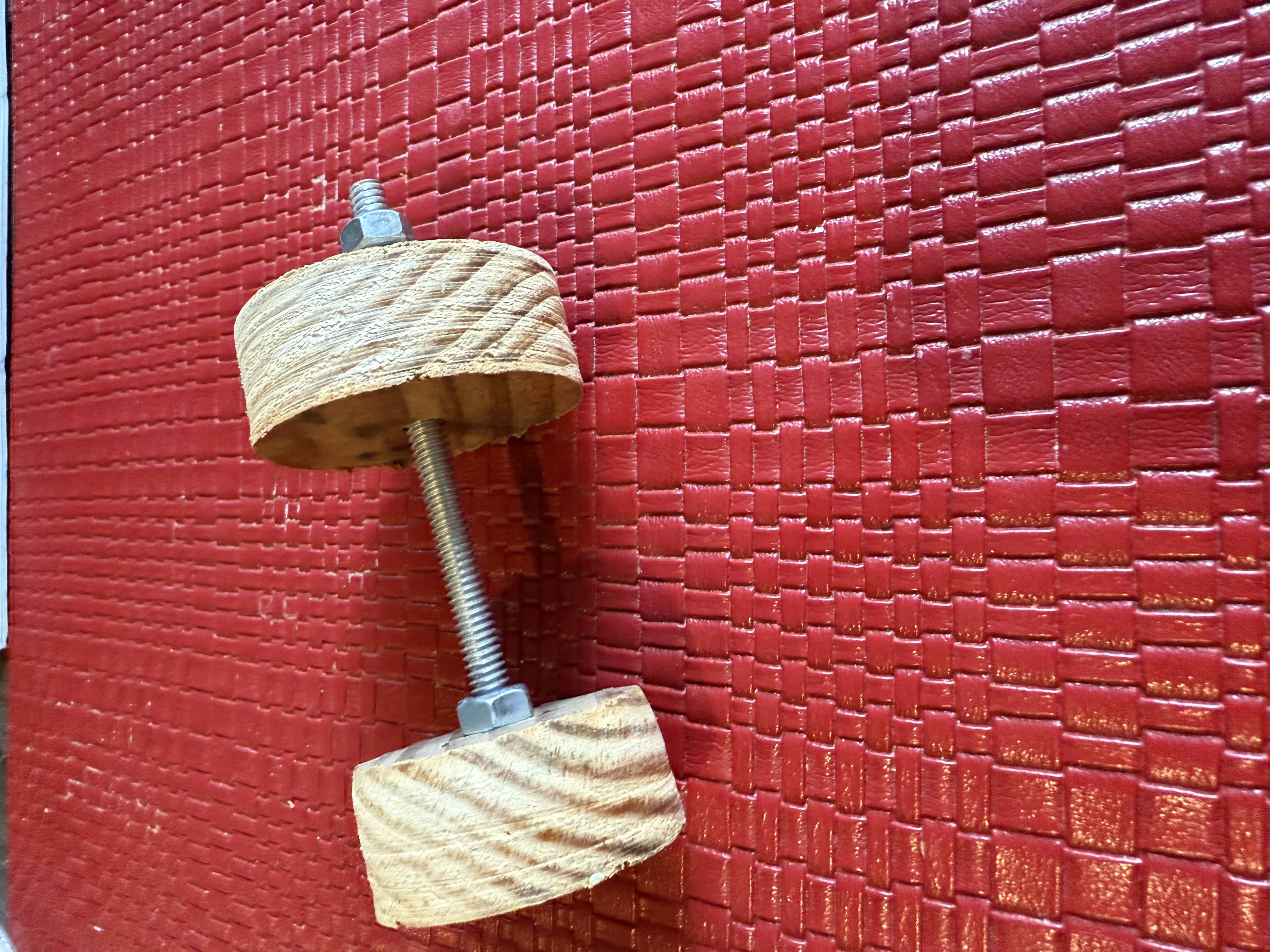

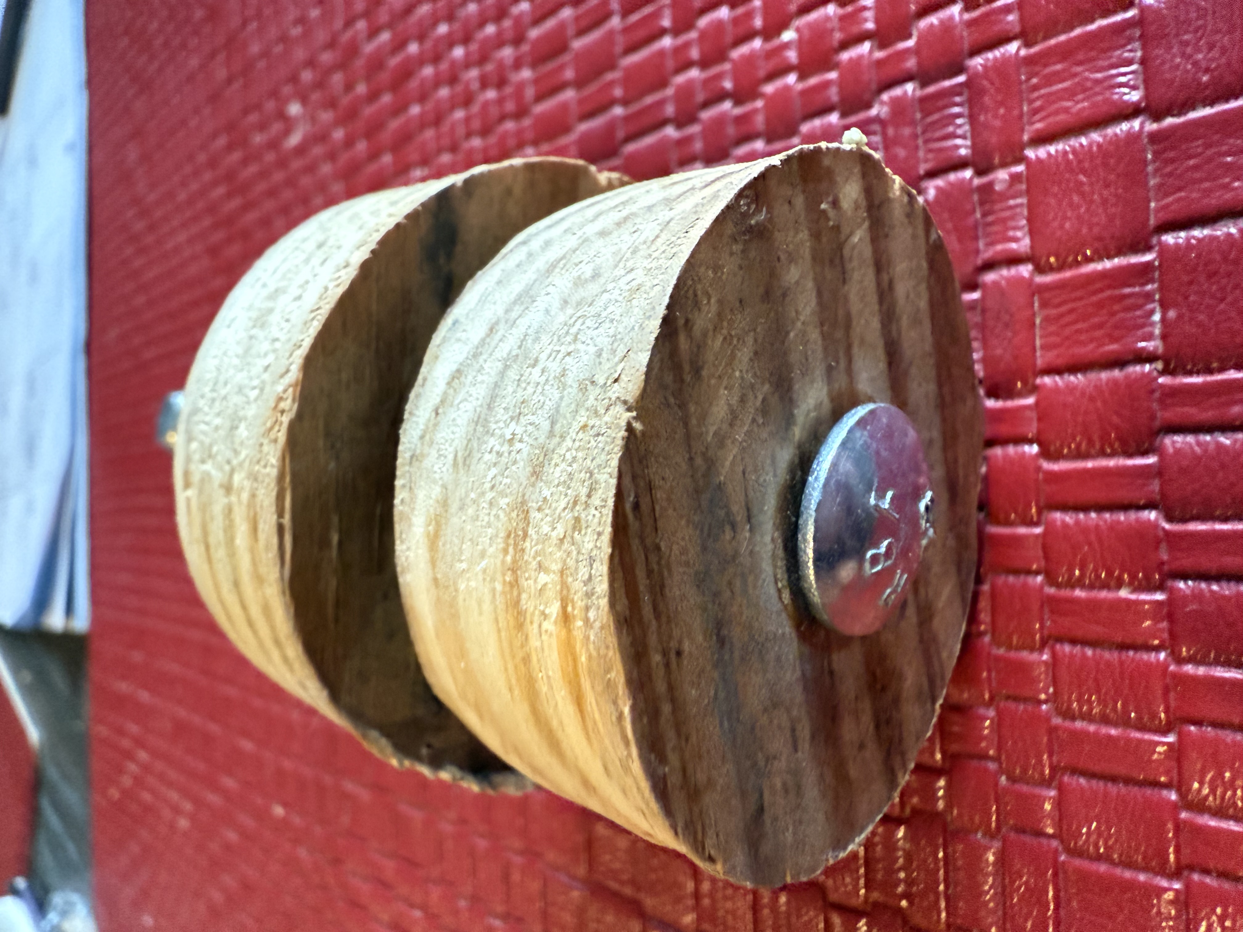

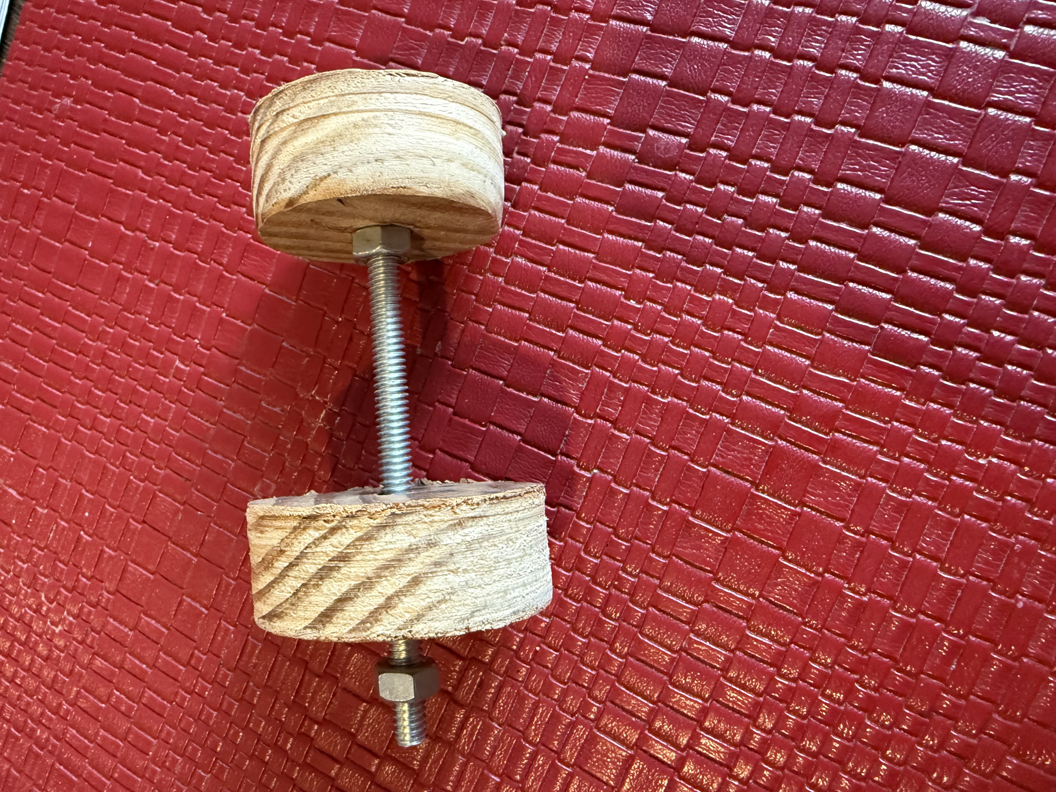

Re: Victor Oak Horn End Cone Replacement
I had a Mahogany horn a couple of years ago that had some splintered wood that was missing on the small end making it necessary for me to remove the two cones to make repairs to the wood ,the originals were pressed together then the metal lip on the exterior piece was bent over a lip on the interior piece, I straightened out the lip releasing it from attaching to the other cone, made my wood repairs, then reinstalled using the tool I made with two different size hole saws. I put a small amount of good quality construction adhesive on interior and exterior cone and assembled using the home made tool to draw the two pieces tight together. Then after adequate cure time I disassembled the tool and bent the lip back in place as best I could, The adhesive was doing the work holding everything solid , just carefully bend the lip back in place were it looks good. It is important to mark your elbow rivet orientation, or your decal will not be in the correct position
