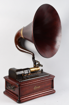

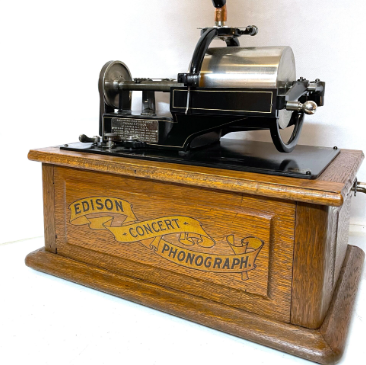

There were two different Concert models. Either one would be a very nice find!
A sample of each, taken from the internet.

Hmmm. That's cool!! Would it work without the horn or do I need it to play?
The thing the cylinders go on looks much larger than what I've seen on the internet! :lol:

You don't need a horn to play it, but it would sound much better. The Concert model with the larger mandrel* plays 5" diameter Concert cylinders. They can be a challenge to find at a reasonable price & condition. The other style Concert plays regular size cylinders.
*The thing that the cylinders go on. ;)

An article on the 5-inch mandrel variety of the Edison Concert appeared in the December 2024 issue of the APS magazine. I believe you're our newest APS "Student Scholarship" recipient, so you should be able to easily access either the hard copy or the digital edition on the APS website. If you're interested, I can send you a PDF of the article.
These early (1899-1907) Concerts are interesting in that they were cutting-edge for volume and clarity, but were obsolete by 1902. As Jerry has mentioned, Edison Concert/Columbia Grand Records can be difficult to locate and expensive to buy. They're really advanced collector machines but if you're being gifted one, that's a wonderful thing!
The later (1911-1913) Edison Concert (originally named the Opera) is a technically advanced machine that plays 4-minute celluloid cylinders like Edison Blue Amberols or 4-minute Indestructibles. These are sought after by collectors for their beauty and excellent playing capabilities. Records for it are the most common type available, so it's a more practical machine (but since when was collecting "practical?").
