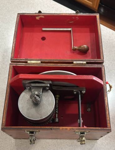

I see these all the time at garage sales and flea markets in my area. They have been discussed before, but I don't recall seeing photos. Some people may find this interesting. These have been made by local fisherman ever since Victrolas became obsolete and before people had a need for wine bars. The governors are always removed and the gears often have a lot of wear.

It's always worth checking out a trolling motor, (or more appropriately a handline or trolling box). I have put several back in action.
Here is one made from a somewhat early Victor motor...

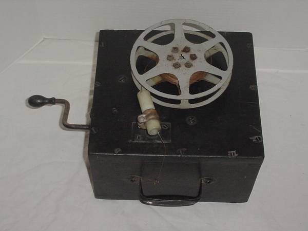

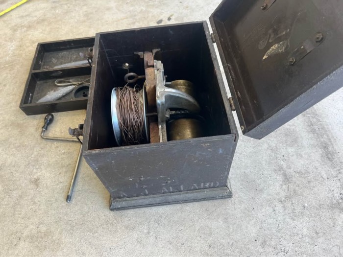

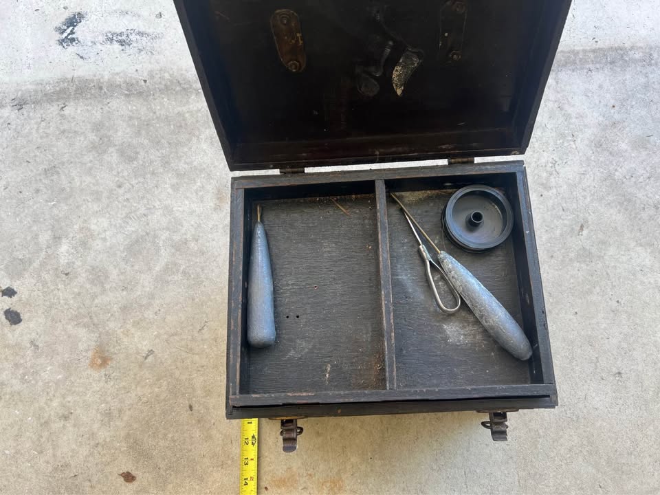

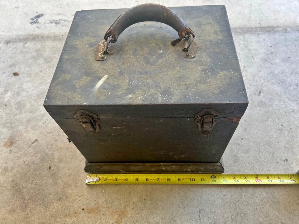

never heard about this before this post - here's another one on Craigslist
https://syracuse.craigslist.org/spo/d/s ... 62366.html
