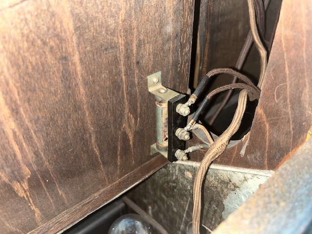

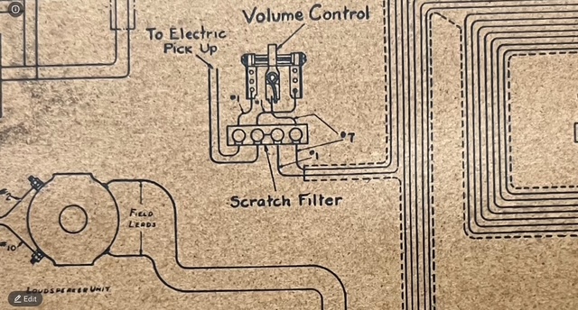

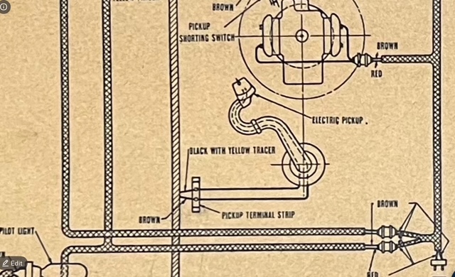

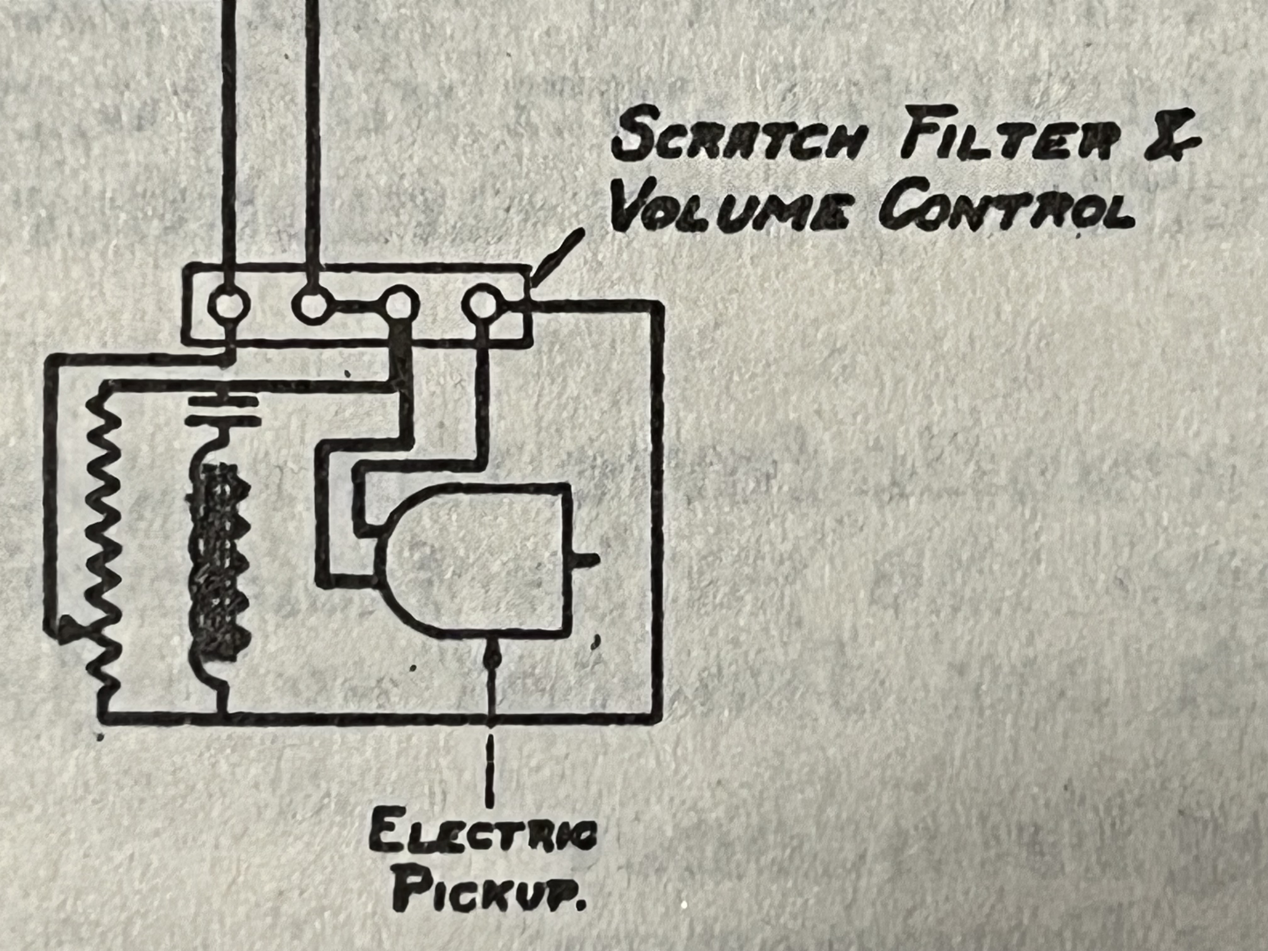

Does your machine contain one of these cabinet mounted resistors? It appears to be factory installed but does not appear on the wiring card attached to the inside any of of the rear panels. It is also not mentioned in any of the service literature nor in the Victor Executive notes at Hagley. The resistor is in series with one of the pickup leads.
A photo of your resistor and the resistance value would be helpful. Please note the type of driver in your Electrola
