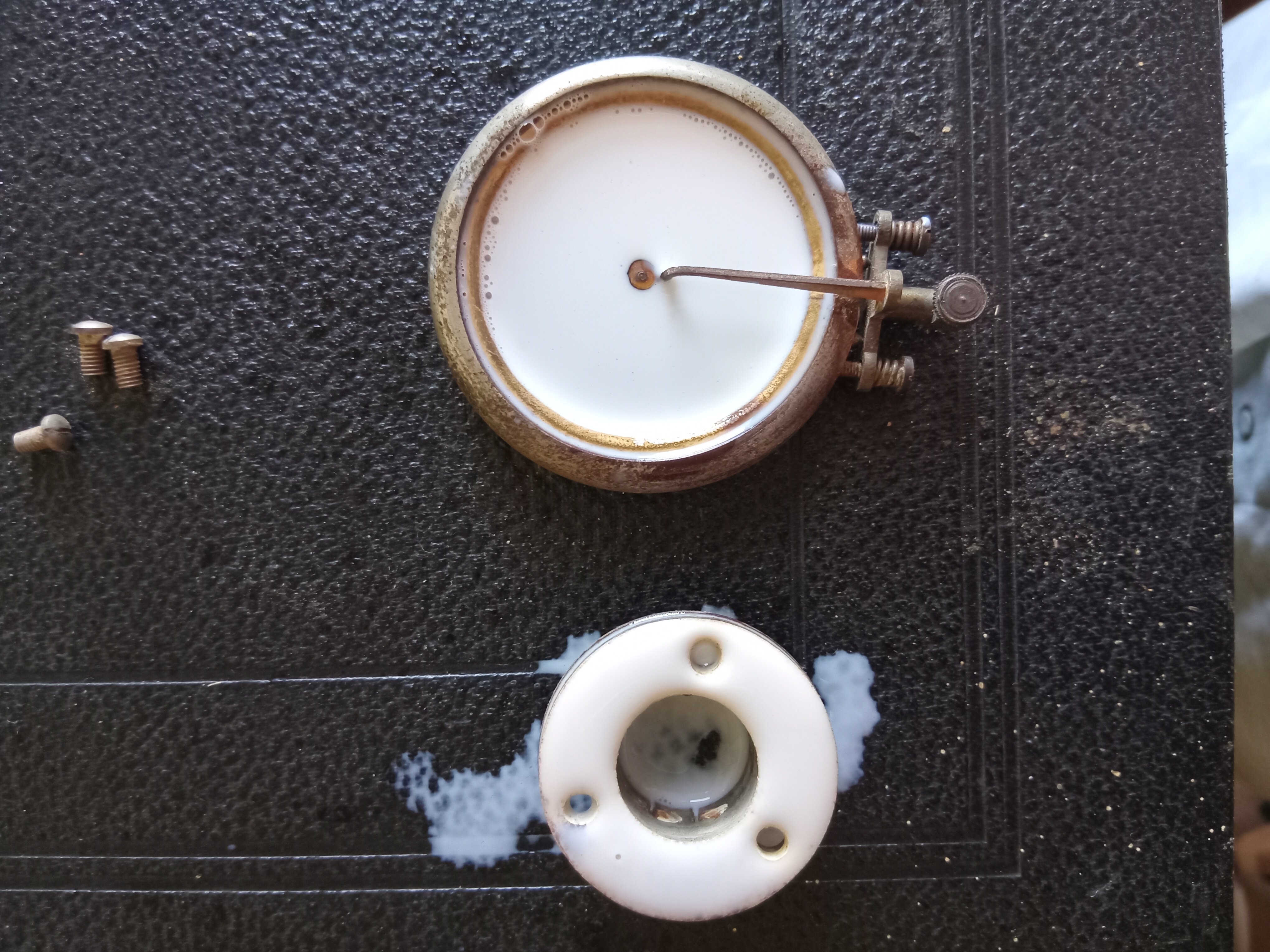

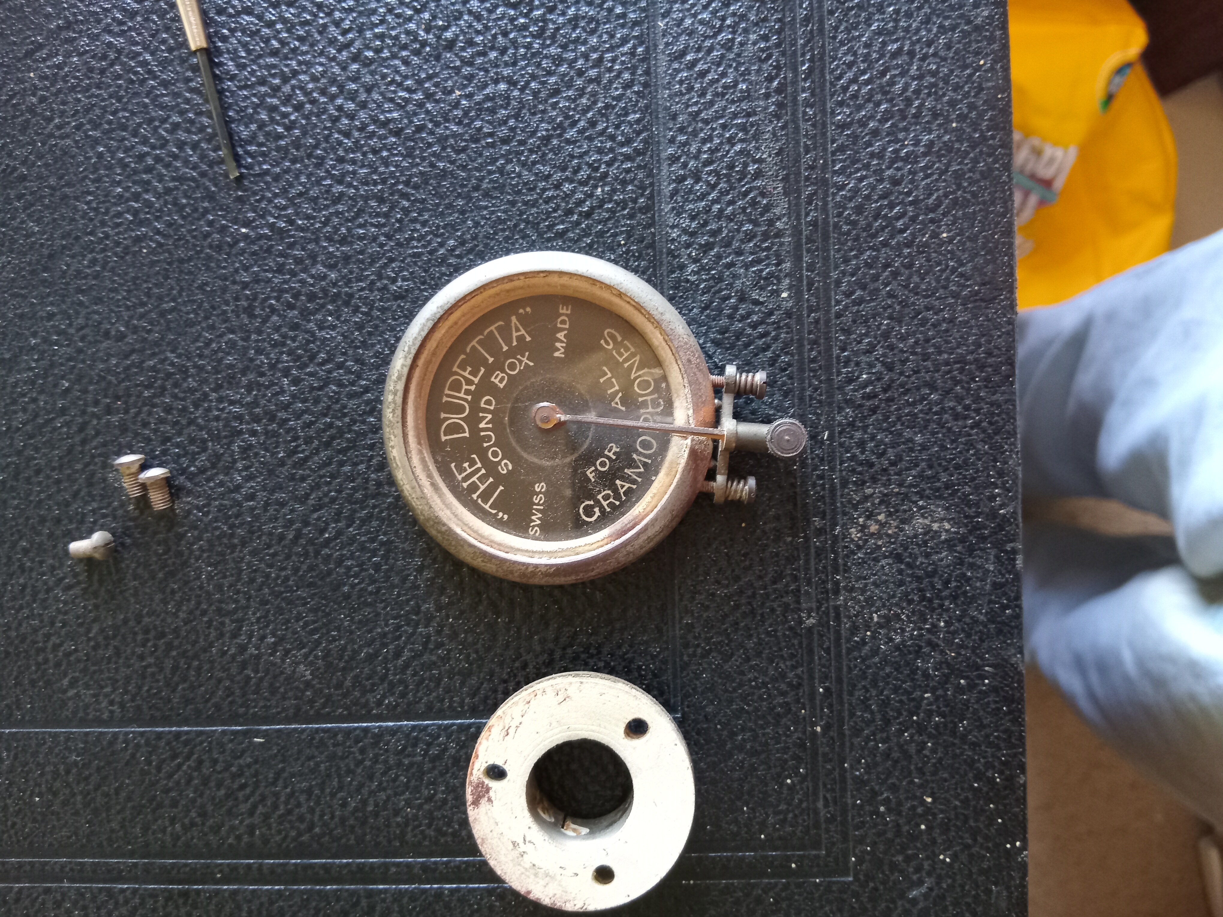

It begins
In the original state. Gaskets are fairly hard. Rubber seal on back is pliable but for sake of completeness I'm softening that too.
Treatment begins. This will be left for 24 hrs. The armour all has also worked wonders on my columbia portable leatherette.
