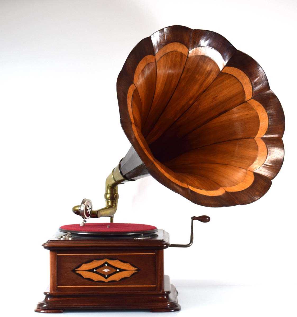

It looks like somebody was a cabinet maker and made the case themselves. Possibly also the horn. The marquetry is beautiful.
I'm assuming that such a home made gramophone, perhaps from second hand parts but maybe not would be called a frankenphone.
But I'm fairly sure the person who made this just wanted a gramophone for playing records and wanted it as nice as they could make it without any thought for subsequent sales. So yes I think it's a frankenphone but I certainly don't think the maker intended to decieve anybody.
We cannot see the soundbox so can't be sure it's not a crapophone. But I don't think it is.

The soundbox is based on a Thorens design, frequently copied on Crapophones. The (Garrard?) turntable with it's brown rim also sets the alarm bells ringing, but I agree that the woodwork of the case and horn is of an unusually high standard.

£300-500? OK. Most auctioneers estimate genuine HMV horn machines well below that, even when equipped with original wooden horns!
I agree it looks like a labour of love for an accomplished cabinet maker who built their own gramophone with good quality original parts. The soundbox is probably a replica Thorens engraved "His Master's Voice" - a classic Crapophone telltale sign. It's unclear what the backbracket is made of but it's certainly a curiosity. If it was near me I'd take a look and if it was cheap maybe even buy it. Thankfully it isn't so I won't be investigating it further!

The auctioneer's description says that the soundbox is an HMV, therefore Crapophone, but why describe the machine as a Columbia?Steve wrote: Sun May 25, 2025 5:33 am The soundbox is probably a replica Thorens engraved "His Master's Voice" - a classic Crapophone telltale sign.
I don't see any components of Columbia origin. If it sells it will probably be to an interior decorator, because it has "the look".

This does not look like a crapo or frankenphone. The skills to make the marquetry cabinet and horn are way beyond the ability of normal woodworkers or cabinetmakers...

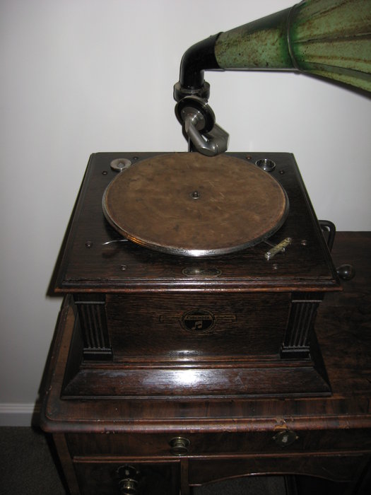

Did they use this type of pressed steel / slanted style turntable on horn machines?
- Posts: 6943
Re: What's this?
I noticed that too. In my opinion, the answer is, "no".Sidewinder wrote: Mon May 26, 2025 5:08 am Did they use this type of pressed steel / slanted style turntable on horn machines?
- Steve
- Posts: 4080
Re: What's this?
The late Columbia ("2A"?) model equipped with piano-reflex tone-arm did use a sloping edged turntable, possibly with Garrard motor. I'm not suggesting for a minute that is where the auctioneer's Columbia reference came from - that would suggest far more delving and research into Columbia's history than any auctioneer would contemplate undertaking!JerryVan wrote: Mon May 26, 2025 9:47 amI noticed that too. In my opinion, the answer is, "no".Sidewinder wrote: Mon May 26, 2025 5:08 am Did they use this type of pressed steel / slanted style turntable on horn machines?
- epigramophone
- Posts: 5834

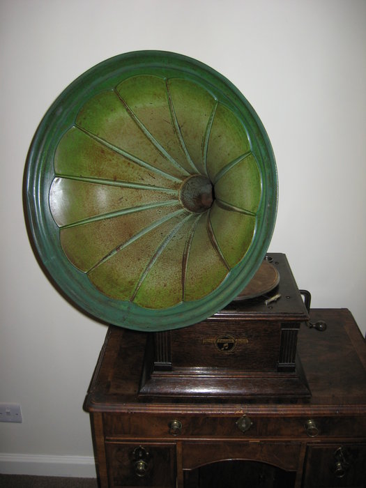

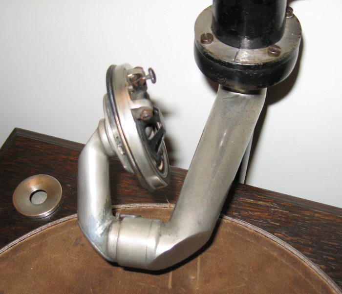

Re: What's this?
Yes the Columbia 2a Horn Model did have a sloping rim turntable, unusually of 11 inches diameter.
I regret selling mine, but I know where it still lives......
