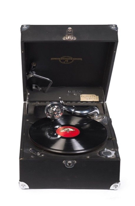

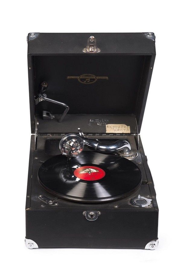

Hello, I have just found something strange on the internet, unfortunately it is only one picture and no really explanatory text:
"Columbia 'Viva-Tonal Grafonola'portable gramophone in black leatherette case, early 20th century. 17 cm high, 30 cm wide, 41 cm deep".
https://www.carters.com.au/index.cfm/in ... -columbia/
I know and have a "normal" 206, with the HMV 102 case, with rounded corners, as described in another post here.
Is this an early 206 model, with innards of the HMV 102 packed into the case of the Columbia 202? I have never seen that before, and I wanted to share it. Perhaps somebody has an idea about that or knows it?

No, it appears to be one of the earliest, so-called "prototype" 9000's, available for a very short period in black following the demise of the 206. I have one and there is at least another one known to have survived (apart from the example linked to).

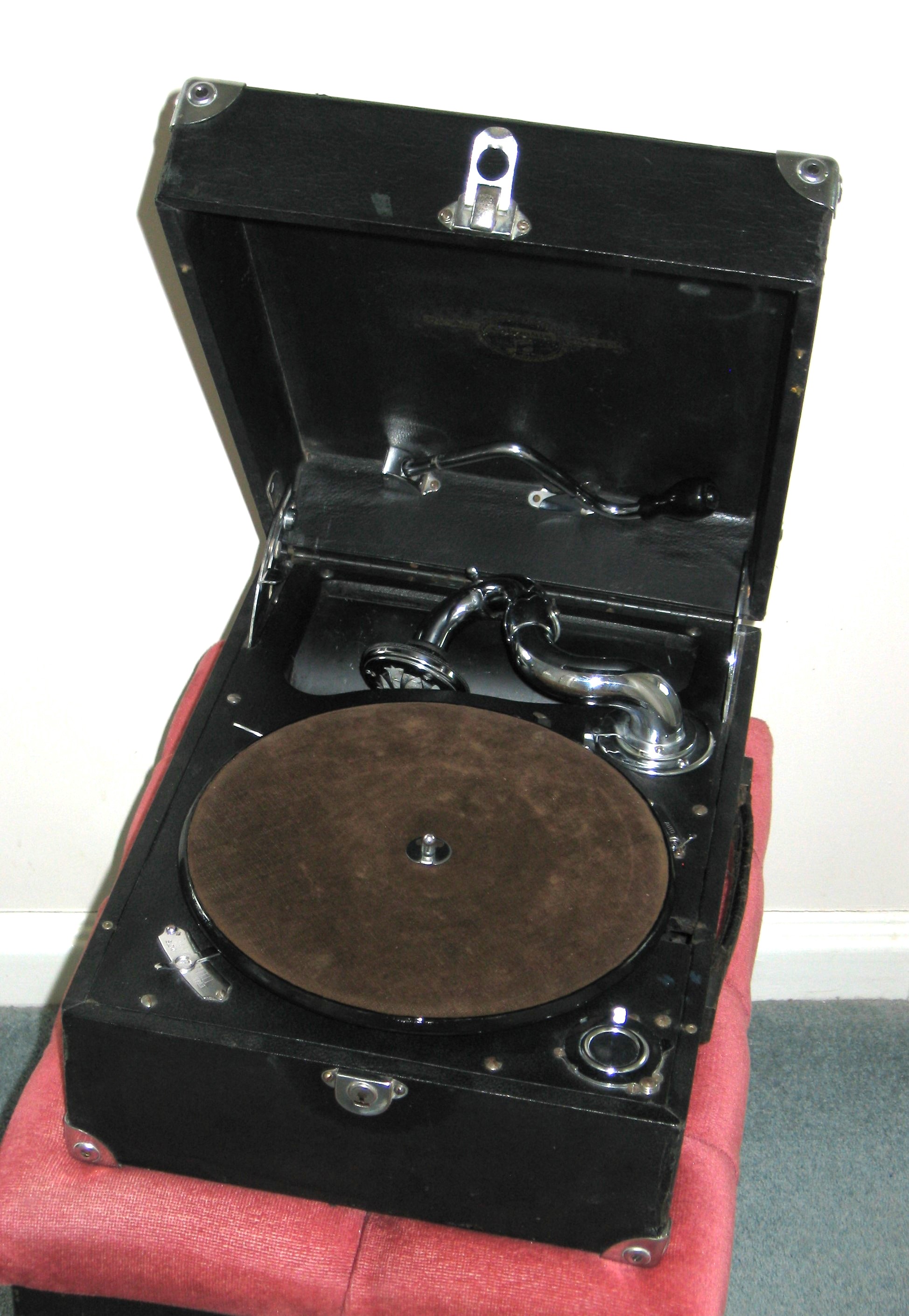

I bought this one last week on eBay, where it's rarity went unrecognised, for £45.
Note the different location of the winding handle clips on these two examples pictured.

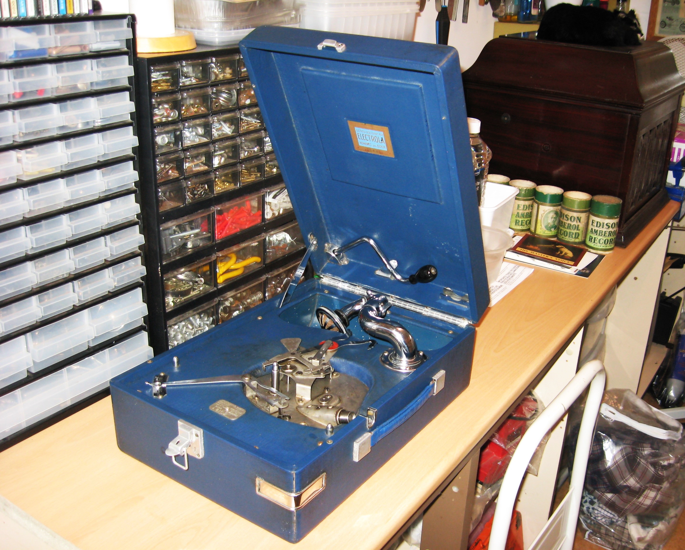

The Electrola 102 is uncommon, having had a short life before being replaced by the 106 with it's 101 acoustic system. The reason for this seemingly retrograde step was that the 101 horn had enough space to accommodate the dual powered motor but the 102 horn did not. Here is my very early example :
