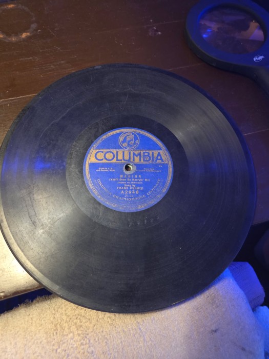

What kind of record were you trying to play? Later 78RPM records, (you were playing a 78? Correct?), were not made of shellac. Those records have far more drag when played with a steel needle. Can you post a photo of the record?

I tried 2 records on both sides. Both blue label Columbia's. A side Marion by Frank Grumis and on the B side Pretty Kitty Kelly by Charles Harrison. The other record was My Old Kentucky Home by Columbia Male Quartette on one side and Uncle Josh At A Meeting Of The School Directors by Columbia Quartette with Cal Stewart on the other side.
I'll take a picture and post the picture.
Kenny

Here is one of the records I used, the other is just like it, only different songs.

The record you posted is period correct and should play fine, unless it is extremely worn. I also do see what looks like some graying in the grooves which indicates that it may have been played over and over again with the same needle. There have been a few times where I have played an extremely worn record before, and the machine would stop when calibrated to 78 RPM. I would suggest trying a different record just to make sure.

OK, I'll try some different records. Maybe I'm just using a coupe of worn out records.

That was the problem. Worn out records. I put a shiny looking record on and it played all the way through. I didn't know it was a problem to play a thoroughly played record and would cause this problem. I ripped all the 78's I have using a Dual 1019 with a Shure cartridge with a 78 stylus to hard drive. And all played fine even if some really sounded worn out.

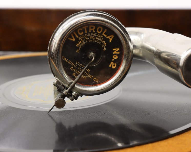

What is the needle rake angle on your troublesome VV-80? Can you adjust it?
Common advice suggests that the 55 to 65 degree range is normative. A steeper angle may increase surface noise and increase drag friction between the record and the needle which can slow or stop play. A more acute angle can reduce drag and possibly surface noise at a cost of other sound quality perhaps.
Here is a picture cribbed from the web showing a picture of a reproducer with a more acute angle, probably in the 55 degree or less range .
