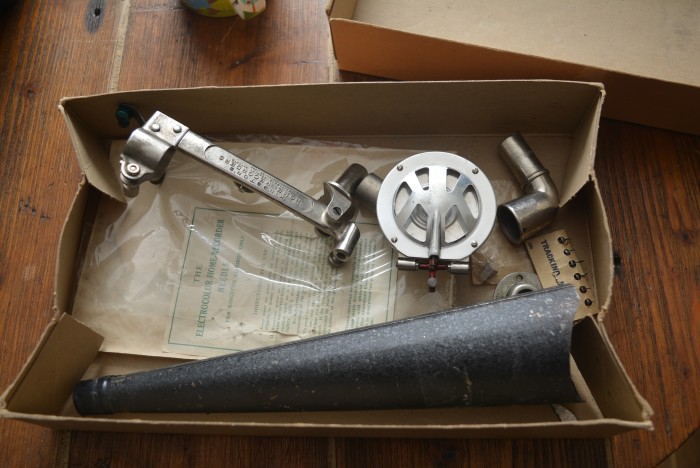

Iv'e been given 1 of these & it lacks any instructions, although it doesn't look too difficult to fathom how it works, wondered if anyone has a digitised copy of the instructions please & what type of needle needs to be made with which angle to cut a sound onto the surface of ....What ? Aluminium ? Thanks.

herrickpickups wrote: Tue Jul 01, 2025 8:09 am Iv'e been given 1 of these & it lacks any instructions, although it doesn't look too difficult to fathom how it works, wondered if anyone has a digitised copy of the instructions please & what type of needle needs to be made with which angle to cut a sound onto the surface of ....What ? Aluminium ? Thanks. DSC_0014.JPGDSC_0013.JPG
Did you get this to work in the end? It’d be great to see how if so. I also have one of these but I think there may be something missing or incorrect. I can’t figure out how the tone arm works in conjunction with the part that fits on the spindle to guide it properly.
Any additional pics or info greatly received!
I have a set of these too - I sometimes wonder if I could 'over-write' a 78 record.
Anyway, here is (I think) a link to the patent - (the third one down). The actual instructions do not add any user information to that which is in the patent description etc.
Interestingly, it states 'The metal or other disc' and 'the stylus being a stout hard steel needle fitted in the usual way to the sound box, or a sapphire, diamond, or other gem stylus'.

That's really helpful thanks! I was able to see how the central boss worked. It had totally seized (part of it being the dreaded potmetal), but I didn't realise that I'd only freed up the bottom section, so more work and it looks like its spinning as freely as it can. Also the small ball bearing to hold the bar is missing along with the spring, but that should be easy to replace.
As for re-writing an existing 78, I think you'd need a needle that could "cut" the record. A normal steel one probably wouldn't as theyre designed for playback, but I expect a regular steel needle is able to etch the aluminium disc and "record" the person speaking into the sound directing trumpet!!
Thanks again for the link, much obliged.
