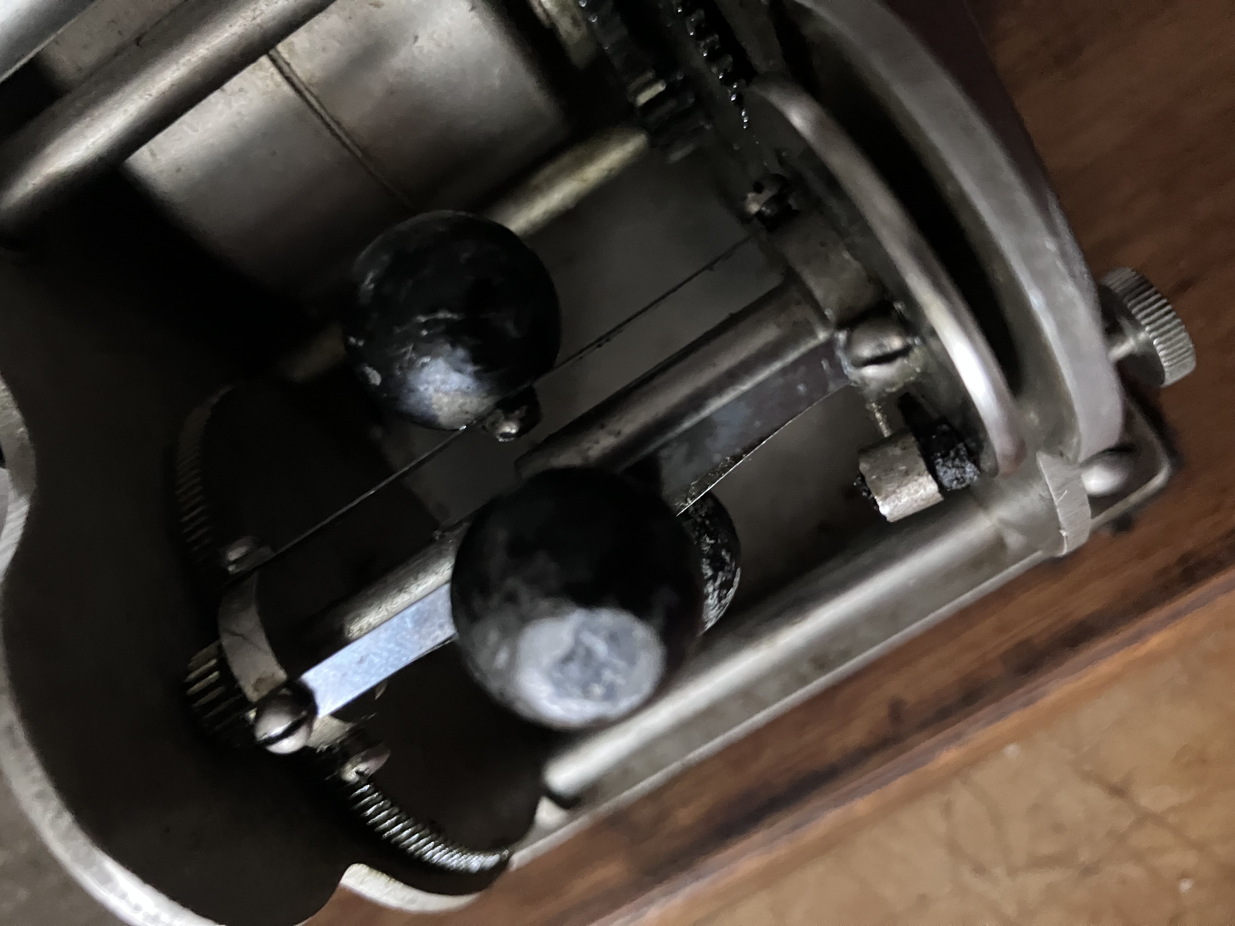

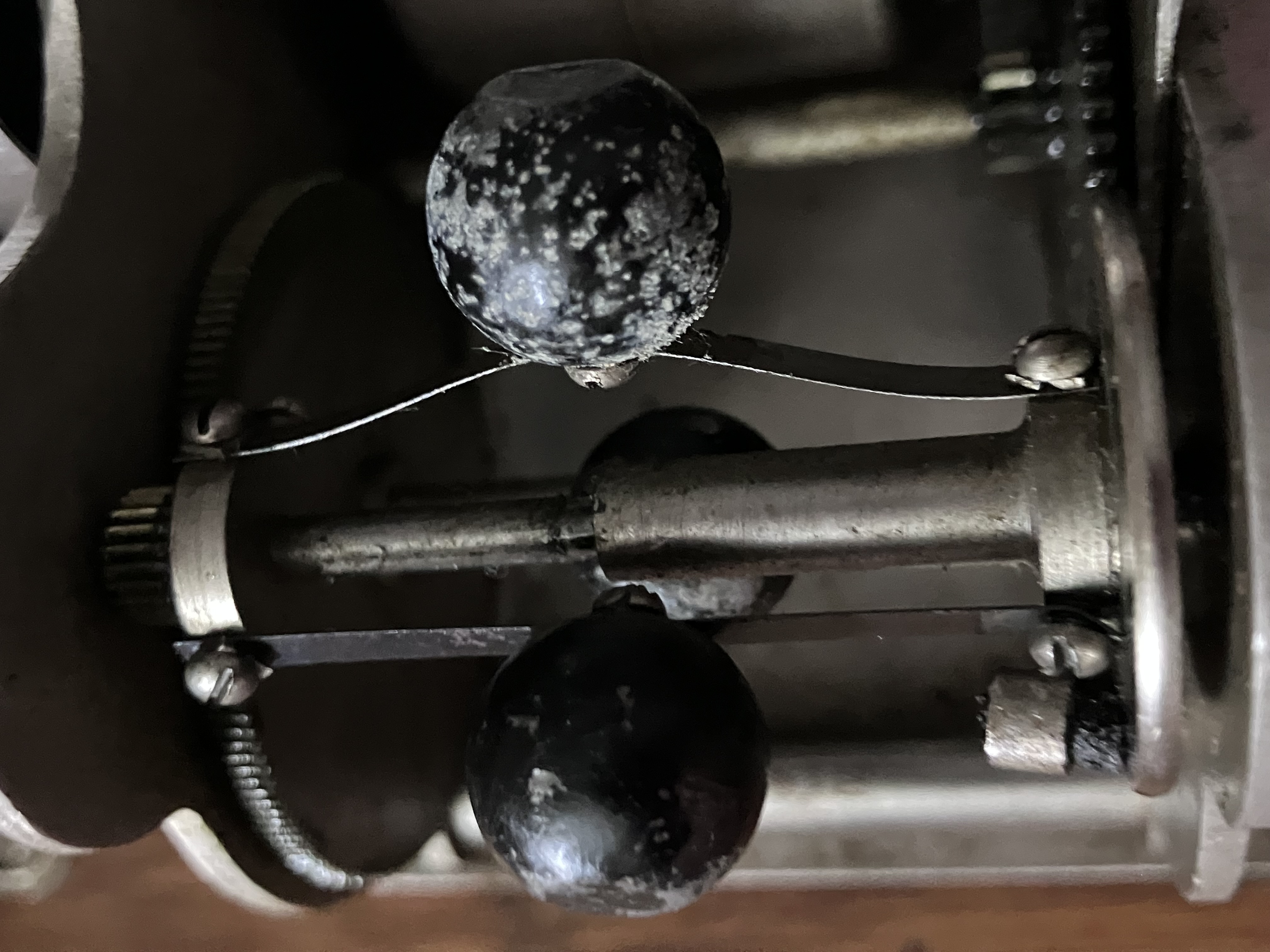

I’ve been very confounded with this issue but I have noticed something, this governor weight and spring seems longer than the other two on this machine, like it doesn’t match with the other two even the color of this spring is different…it seems like a previous owner replaced two of the springs except that one. So it may be a contributer to my tracking issue? I fiddled with my reproducer as much as I could and it still gave me this annoying tracking issue!
Two springs look like this…
The odd governor spring

All the springs and weights should be the same. Not sure if that is the cause of your tracking issue though.

That governor spring is definitely not correct. Eagle governor springs should be almost straight at rest (like the other 2 in your picture). That one governor spring is too long. Doubtful (in my opinion) that this would impact tracking though. However, this could possibly cause a flutter in sound since the governor would be out of balance on rotation and almost certainly transfer this imbalance through the drivetrain to the mandrel.

If it creates enough imbalance, it may cause the stylus to jump out of the record groove. Either way, it should be replaced with the correct length. To be proper, you should replace all 3.

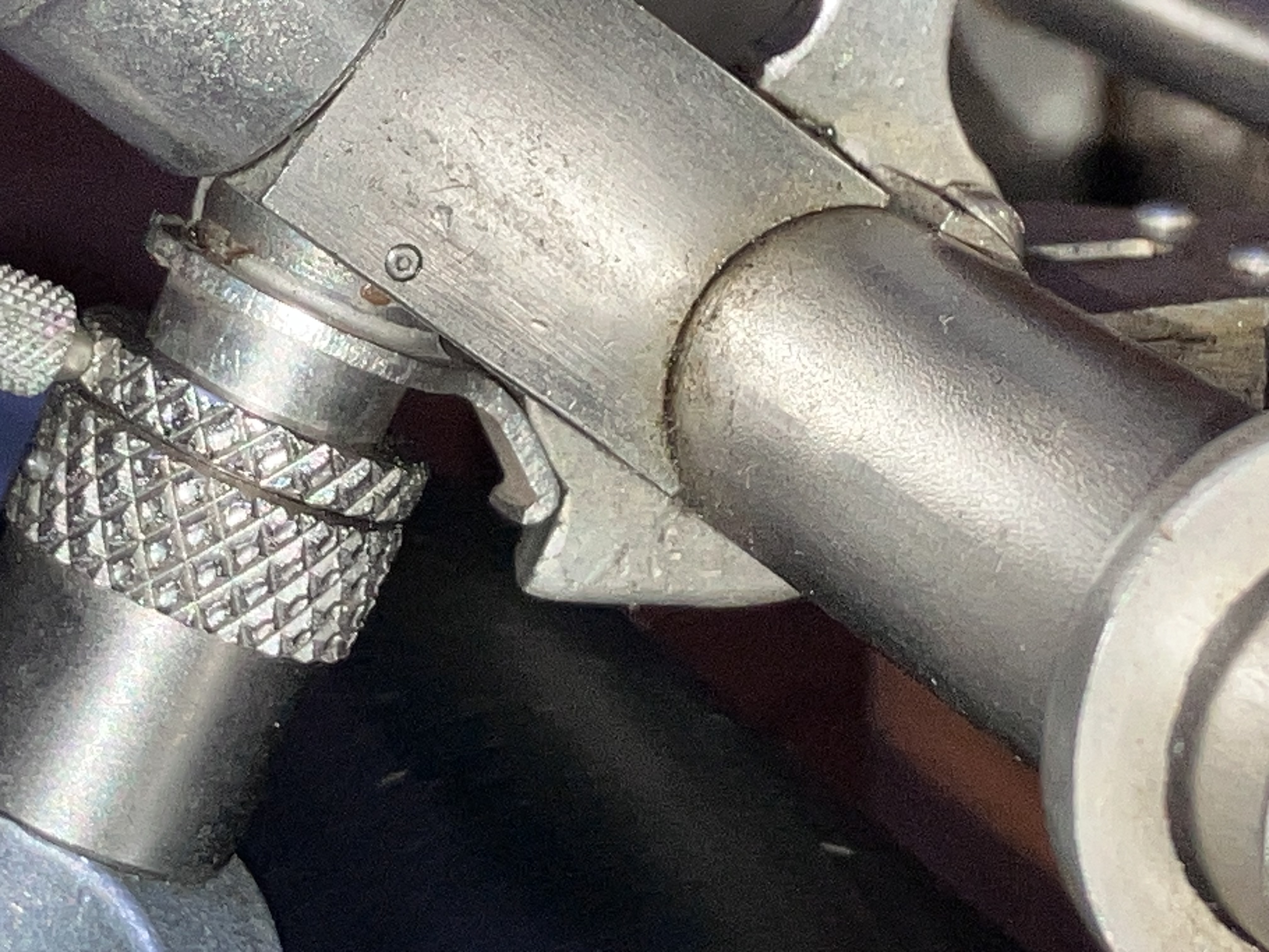

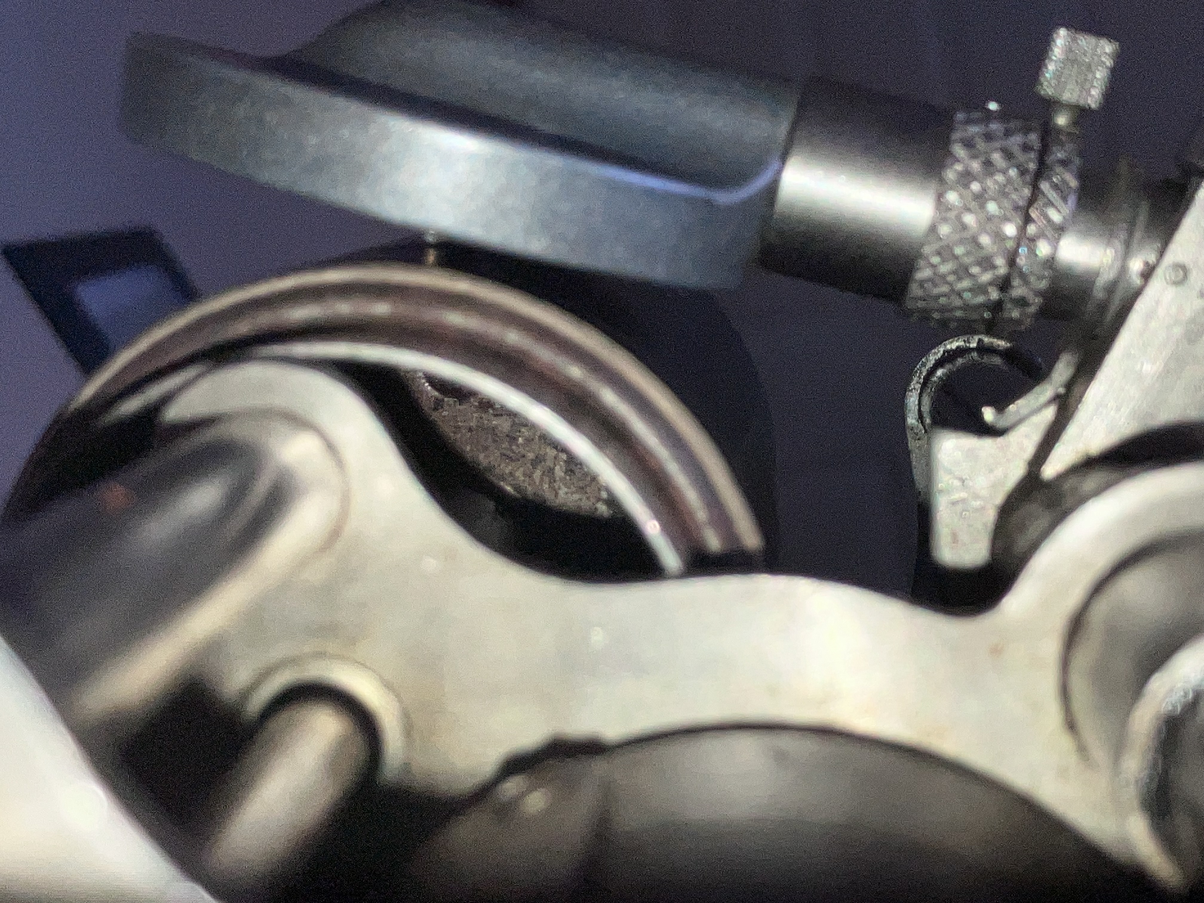

Presuming the cylinder(s) that you're playing is/are in good playing condition (no groove damage or pits) then the problem may be that your reproducer is not "floating" laterally as much and as freely as it should. Keep in mind that Columbia floating reproducers require a good amount of free lateral movement in playing position. I suspect that your reproducer may be a bit confined relative to lateral movement which could certainly create skipped grooves during play.

The problem is I cannot get that lateral movement to work no matter how much I try to fiddle with both of my floating reproducers and I want to know what’s causing that?

The more I fiddle with this machine and play more records the more apparent the issues with that governor weight and spring are, there are now some significant wow and flutter issues with records.
I looked up eBay and Thephonographshop for a replacement weight and spring set but no dice. ☹️
