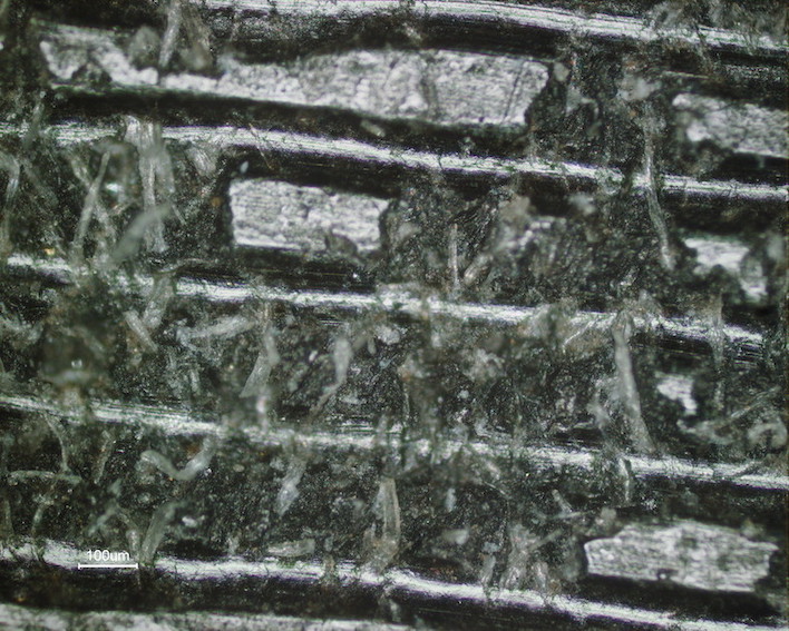

In his Munich dissertation of 1906, Edward Wheeler Scripture, a multi-award-winning US-American experimental psychologist and phonetician, wrote about his investigations of vowel curves, mainly using gramophone recordings. He literally described the record material as “a substance consisting of asbestos and shellac.”
You can certainly get this idea if you just look at the composition under the microscope. In this photo I took of a solvent-damaged Victor Toy Record from 1901, the grooves and the fiber material are clearly visible.

Could the substance shown simply be cotton flock or something else, such as dust getting mashed into the record as the solvent damaged it? In the absence of an actual formula that could've given Scripture such an idea, it simply seems unsubstantiated. No surviving formula or formulas even suggest such a combination. of course, I've never stumbled on any of the Duranoid formulas either, the company which Berliner and Victor both used simultaneously for their shellac compounds. We may never know, or perhaps the info is out there and I've not yet come across it. It would make little sense that any record company would choose to use expensive asbestos, a material with no superior strengthening quality over cotton when bound in a matrix. I may need to start a project to get to the bottom of this. There's much mystery over early record composition formulas. Most were kept secret on purpose, though the function is all the same. 100 and more years on, when it no longer matters whether such formulas are kept secret or not, it would be interesting to find out.Starkton wrote: Tue Jul 22, 2025 1:38 am Some historical sources actually mention asbestos and falsify the statements of the AI.
